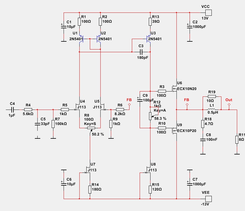

Here is a 6 Watt Amplifier.
EXAPP is it called.
Uses EXICON Lateral MOSFET. Class A Push-Pull.
Will draw 18+18 Watt.
Distortion is low.
Bandwidth is okay.
EXAPP is it called.
Distortion is low.
Bandwidth is okay.

I will post some data.Hi Lineup,
Can you post simulations of this last amplifier as those provided for the last of your amplifiers?
Again I have made a pcb layout for 2 channels of this amplifier, I think it looks interesting
Just wait a miinute.
🙂 Stefan
Why not?Why in Pass Labs sub forum? 🙂
Because it is JFET input and MOSFET output.
This is why my amplifiers suits to be in Nelson Pass forum.
If Nelson don't mind there is no problem to post.
🙂 Stefan

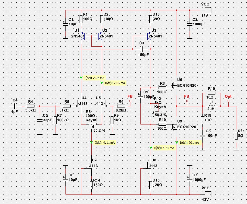

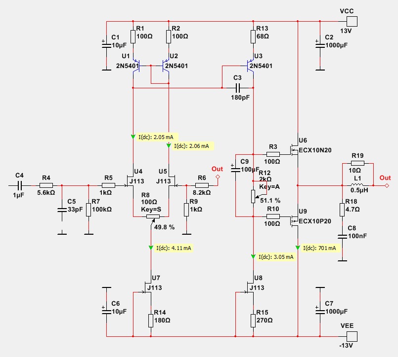

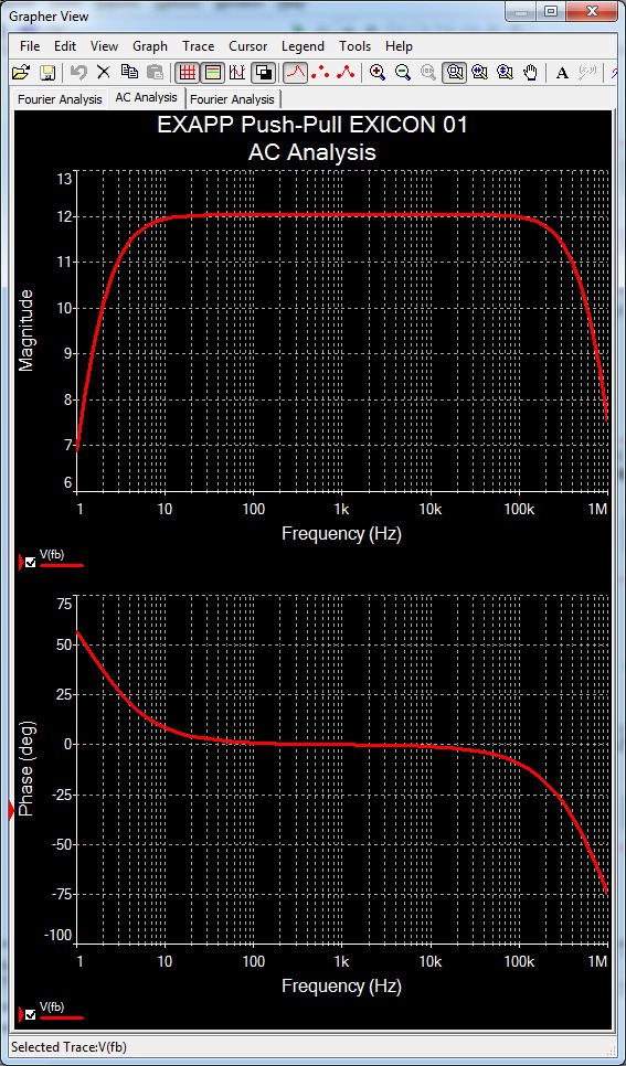

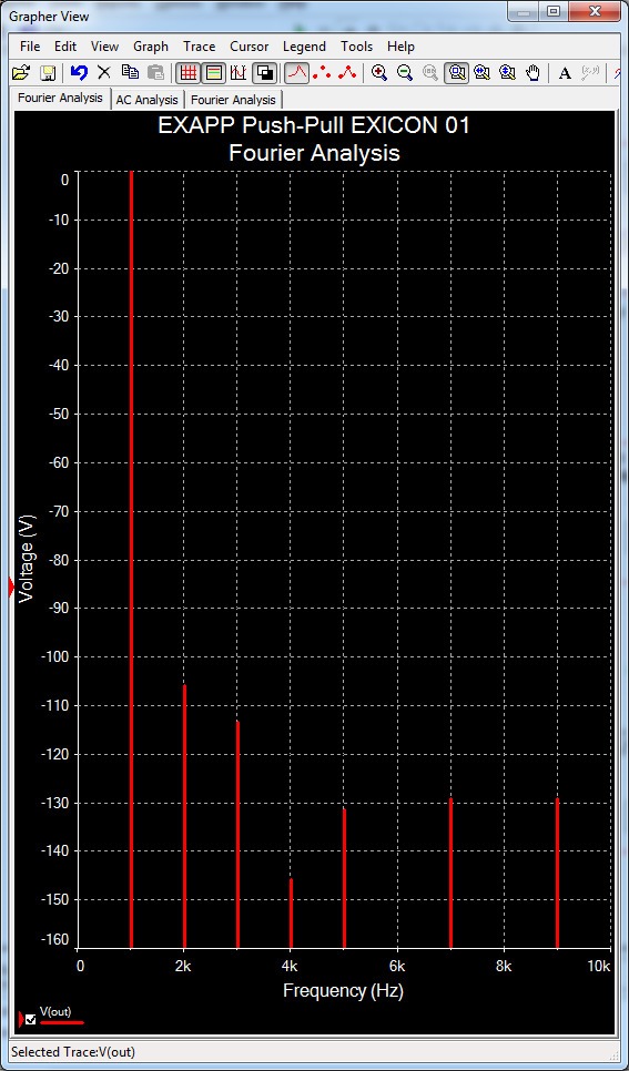

Here is the data of EXAPP amplifier.
THD is 0.00055% at 1 Watt 8 Ohm.
Max output is like 6.5 Watt at 8 Ohm
See image one: The amp with currents at idle
See image two: Fourier Analysis at 8 Ohm
See image three: AC Analysis
🙂 Stefan

Can you work the circuit a bit to lower the 5th and 7th harmonic?
I’ve read many times to keep the 5th as low as possible.
I know.
Simulation does not accurately reflect what may come in real life.
I don't know how much I have had to say this.
Now I don't build.
I leave this to others.
Thanks for pointing this out.
🙂 Stefan

I do not know a way to do this.Here is the data of EXAPP amplifier.
Hi
I simply must take the result as it is now.
The amplifier is tweaked alright.
🙂 Stefan
