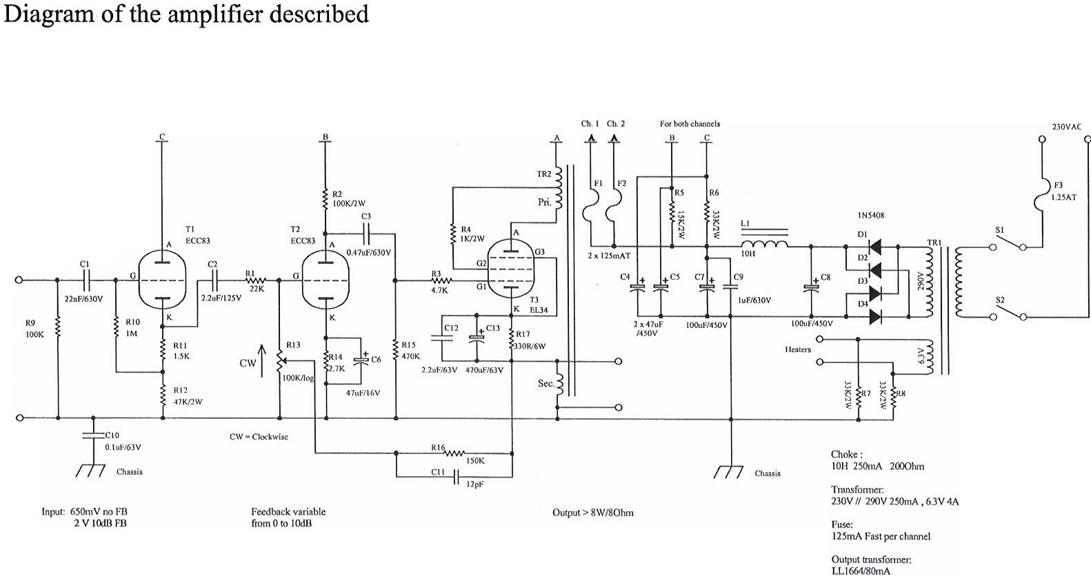

So I see from https://www.lundahltransformers.com/easy-to-build-se-amplifier/ there is a 300B schematic with adjustable global negative feedback.
I understand the basics of gnf, In this layout, I mostly understand the 100k log pot but the 150k/12pc in series looses me a little. Im guessing the RC circuit
simply prevents zero feedback and the cap has something to do with (reflected?) impedance..

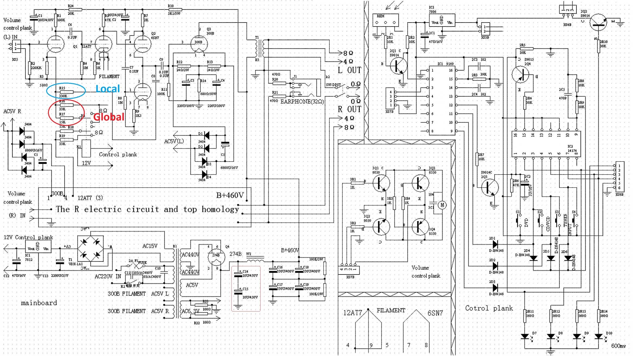

AudioFanMan,
If I understand it correctly, you have at least two problems.
1. Your amplifier has hum at the output.
Read the *** below, then,
Can you carefully measure the amount of ripple voltage that is across your 300B filaments? This is a floating measurement, you can not use a scope to do this. Use a sensitive DMM.
Can you carefully measure the amount of ripple of the B+ that connects to the output transformer?
What is the amount of the hum across the loaded secondary?
Now, ground the 300B grid, and measure make the same measurement across the loaded secondary, how does it compare?
2. You want to adjust the negative feedback of your 300B amplifier.
You need to approach these as separate problems.
Please post the complete schematic of your amplifier, if it is not the Yaqin 300B schematic ***.
Otherwise it is real hard to give advice, or to solve the problems you have.
Depending on where the negative feedback is, and where the source(s) of the hum is, adjusting the negative feedback value will change the level of the hum, or not change the level of the hum.

The posted 300B schematic IS my amp.

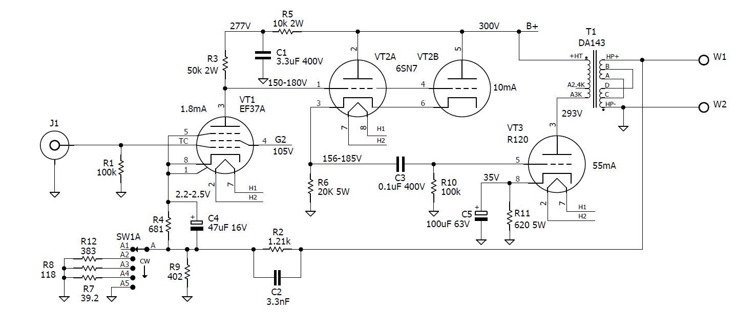

Here's what I did in an R120 SE amp:
http://www.pmillett.com/r120_se_amp.html
No attempt to compensate for the changes in gain...
Pete
Pete

In every example I see, there is a resistor and low value capacitor in parallel. Above in pmillett's R120 amp, R2 1.21k ohms and C2 3.3nF on the global feedback...
Im pretty sure R2 is there to reduce the voltage since the 1st stage needs so little signal, but am not sure why there is the 3.3nF cap ?
C4 bypasses R4 for audio. In the A1 position, gain is set to minimum which is determined by the ratio of R2 to R9. Positions A2 thru A5 add resistance in parallel with R9 which reduces NFB and therefore increases gain. Provided the amp is stable in the A1 position it will be stable in all the other positions. There may also be some small alteration to the open loop gain because the gain of the EF37A depends to some extend on the ratio of R3 to R9 (and whatever is in parallel with it) but this depends on the gm of the EF37A at its operating point. Either way, it only aids stability so it is a "good thing".Awesome, ty...
