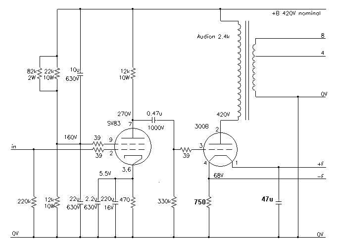

Konnichiwa,
It is basically the same as the (old) Kegon (and for that actually the ANJ Ongaku), but single 300B, not parallel. Much of the sound comes from the Silver/Permalloy Output Transformer and silver leaf/mylar capacitors Kondo uses.
Here is what is a schematic more or less accurate (few Kondo Amp's are 100% identical between samples, he is constantly improving things) of the Baransu:
What you describe is the AN UK Baransu, very different. The Circuit is at the core the standard AN UK, 6SN7 Cascade, DC coupled, among my least favourite driver stages, after trrying most of them, basically like this:
But loads of fancy parts....
Sayonara
tomchaoda said:Is Audio Note Japan's Baransu 300B SE amp schematic available?
fdegrove said:Not that I know of.
It uses 5692 and 5R4GY besides the obvious 300B, all wiring is high-purity silver including the OPT's primary and secondary windings. Silver foil coupling caps, tantalum resistors...IOW the works.
Sayonara
