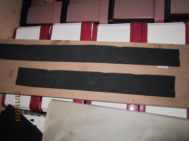

Any pictures kp93300?

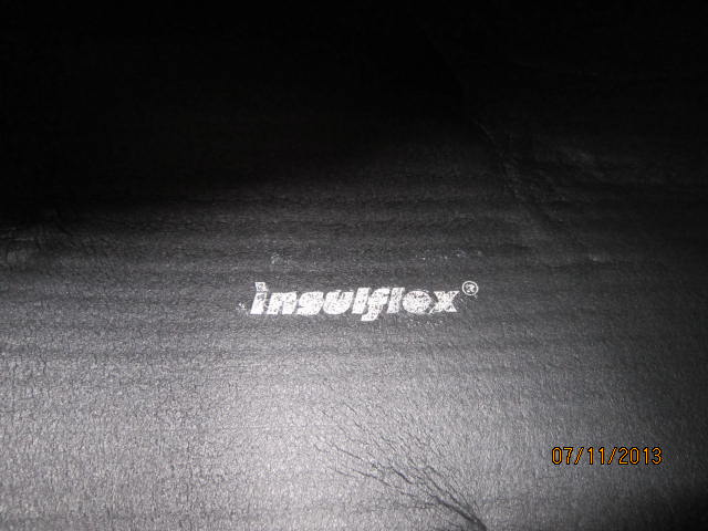

The back panel only show one layer of the insuflex. By trial and error, i have increased to 3 layers.

Insulflex? That's a closed cell rubberised foam insulation as I recall; it may have a minor effect on panel damping, but its acoustic damping properties like all closed cell foams (as the name suggests) are close to nil. So while it'll have a small effect on box behaviour it won't be through it's acoustic damping properties, or the lack thereof.
I line the back panel becuase i notice that vibration of the box is most obvious in this position.
Adding the insuflex increase the mass and I notice less back panel vibration.
No doubt. That is panel rather than acoustic damping however; these are very different functions we need to be careful to describe / discuss separately to avoid confusion.
