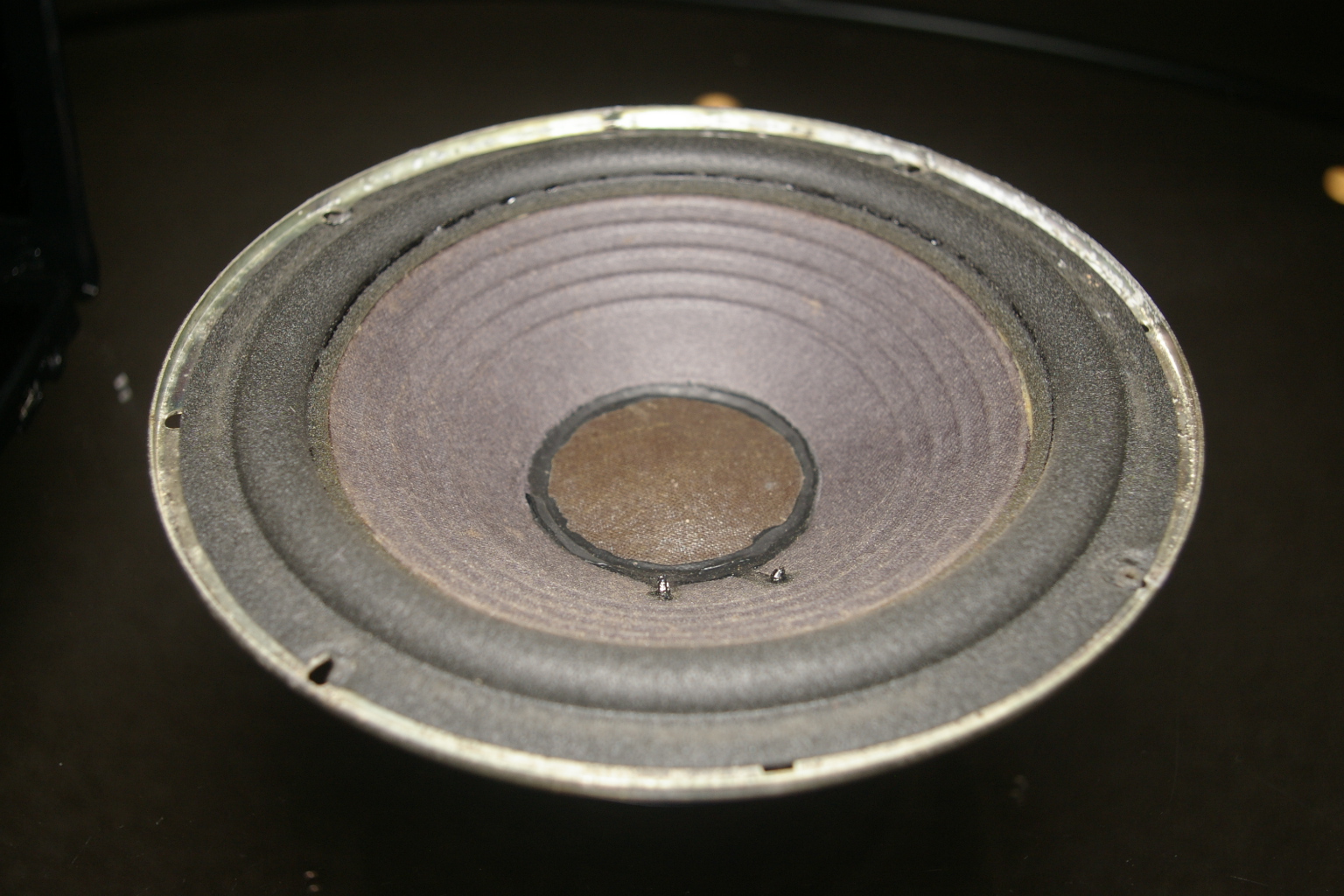

My biggest concern is the scratchy woofer, I have removed it from the cabinet and the cones and spider seem to be intact. I gently pressed on the cone and there is some uneven resistance, I suspect the coil damaged and rubbing in the gap. Is there any way to repair this or will I have to replace the woofer?

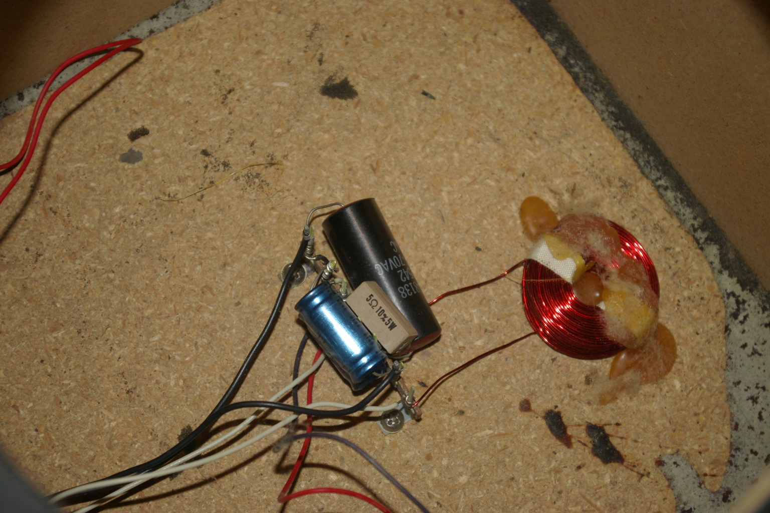

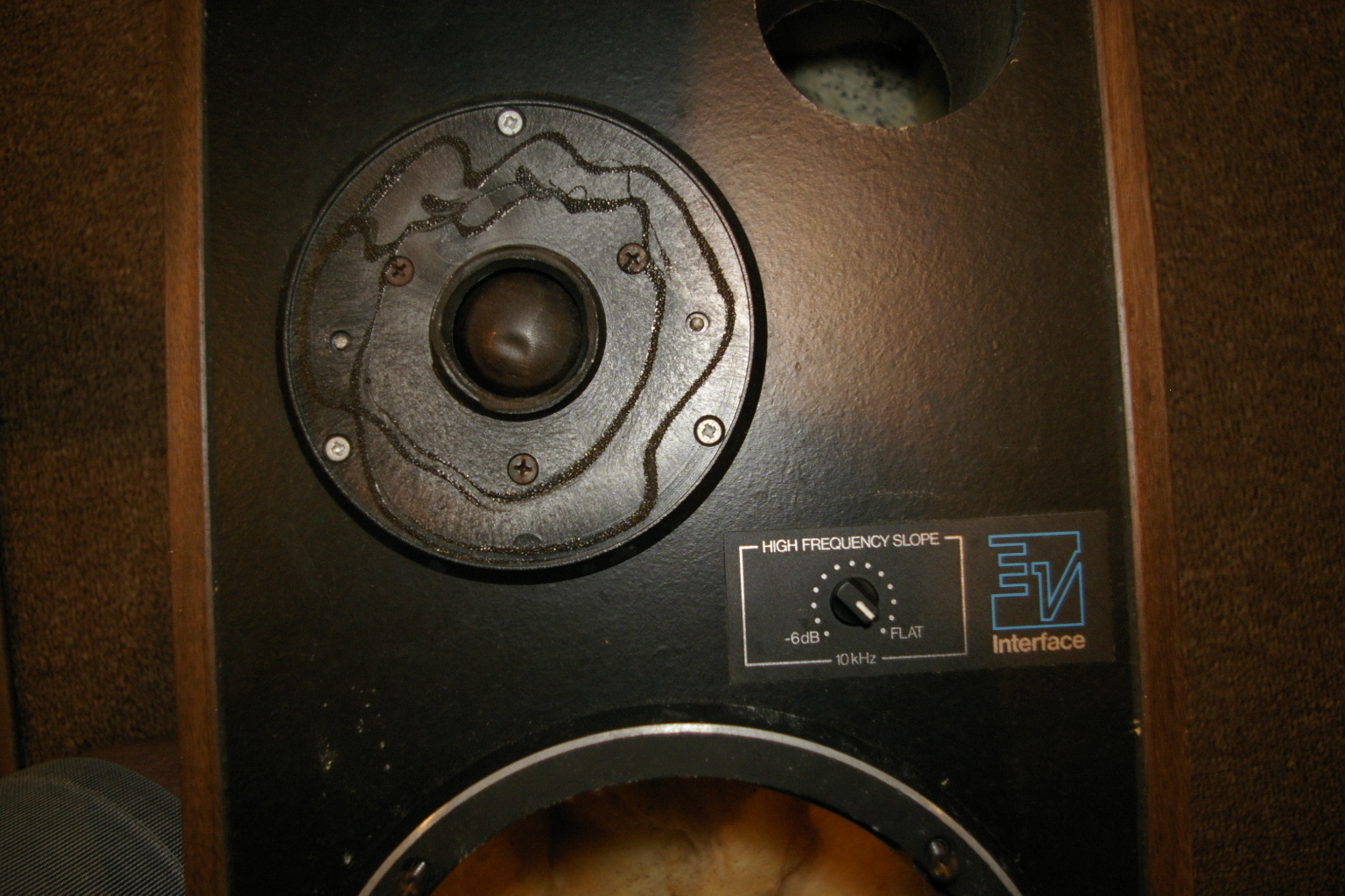

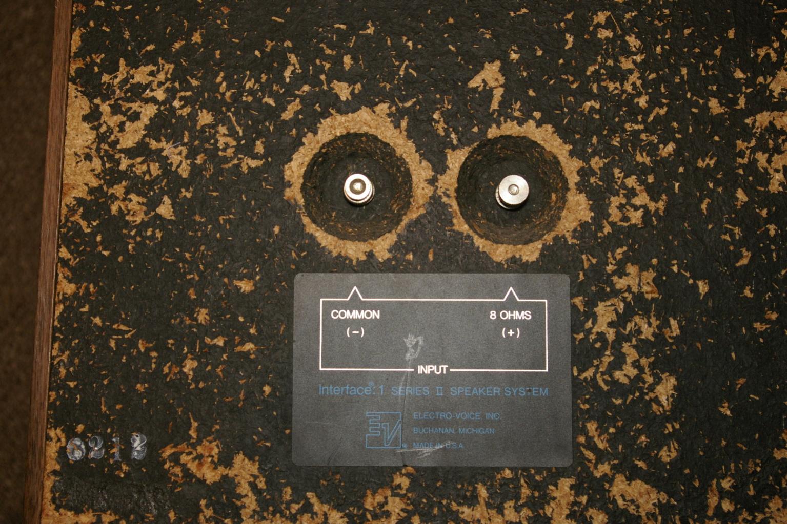

I have attached a few pictures of the speakers.
Woud it be worth while replacing the tweeter diaphrams?

Will these be an appropriate woofer replacement?

The EVs are quite nice speakers! I restored a pair around two years ago and they sounded very nice.
Regarding the tweeter foam lenses, definitely replace them if you like the overall sound of the speakers. I'd be inclined to get the speakers in 100% working order first, and if you like the sound, then spend the money on crossover upgrades and replacing the woofer foams
