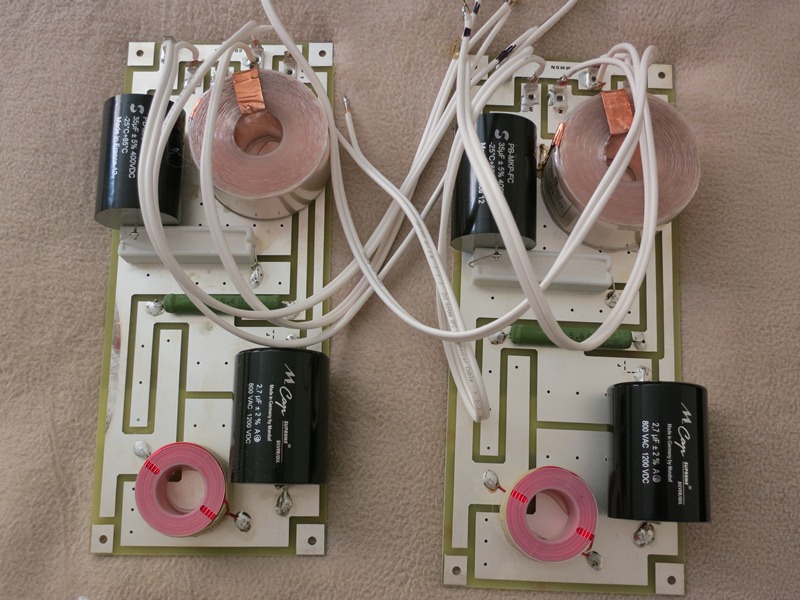

The Eton-designed crossover looks like LR2, and Madisound makes it with good components. I ordered the optional Mundorf silver-oil tweeter capacitors, since I had good luck with them in a previous project. If Eton’s response graphs are to be believed (they are suspiciously smooth…) the drivers should be able to handle the large overlap of the simple crossover and not need resonance traps and such. The simple crossovers should help with clarity and dynamics in comparison to LR4.

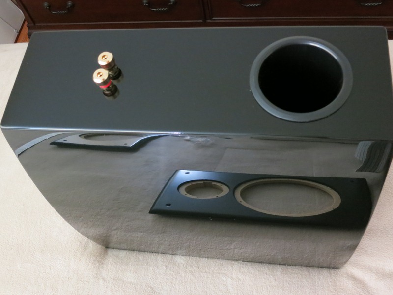

Madisound was out of the cabinets for this kit, and not sure when they would get the next batch. So I ordered the 15 liter curved-side cabinets from Parts Express, together with the PE binding posts. Everything else came in the Madisound kit.
The total cost (August 2012) was about $1,080: $830 including shipping from Madisound for the kit and $250 from PE for the cabinets.
The PE box is shorter than the Madisound 14 liter equivalent, and a quick check showed there was no way the port would fit on the front as shown on the kit plans. Some other measurements showed that it would fit on the back near the top, so that’s what I did.

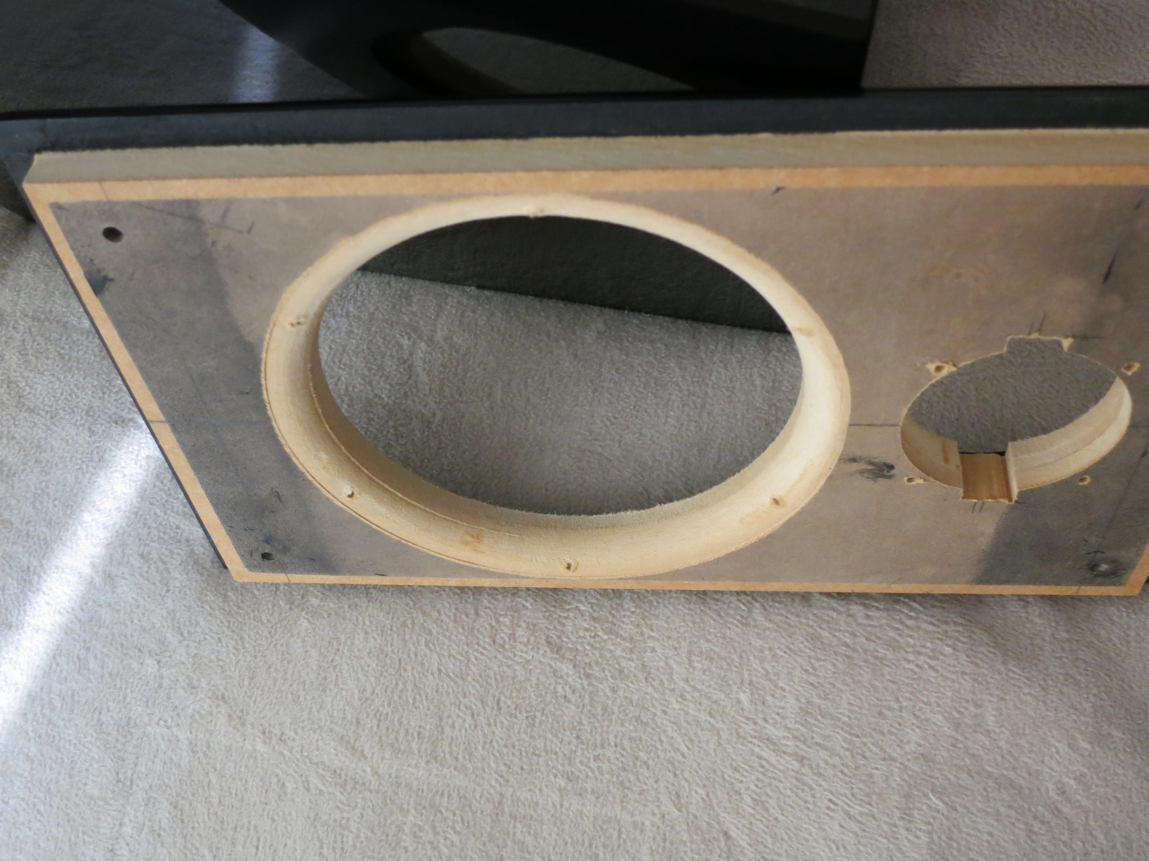

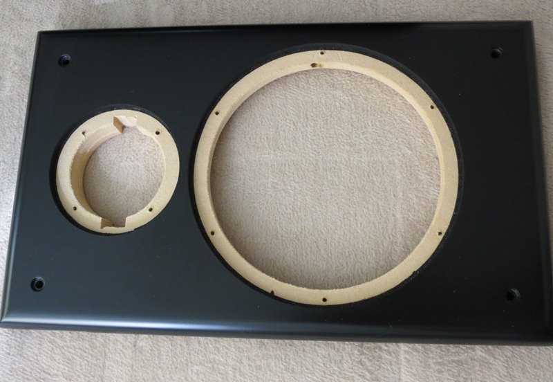

Routing the box and the baffle took some time and thought, mostly a matter of checking and re-checking measurements with an inexpensive digital micrometer. I used a round-over bit to relieve the back side of the baffle for the woofer rather than a v-bit. The round-over bit leaves more wood for the wood screws supplied with the kit, and hopefully will have similar benefits to the sound. I used a mid-grade Sears plunge router with a circle-cutting base attachment that is continuously variable for different radii. I like this better than the discreet steps of some other router jigs, and a micrometer works well when setting the radii. Painter’s blue tape protected the cabinet finish from the router.

The Parts Express box and baffle
The Parts Express cabinet with the port tube in the back, and the routed baffle

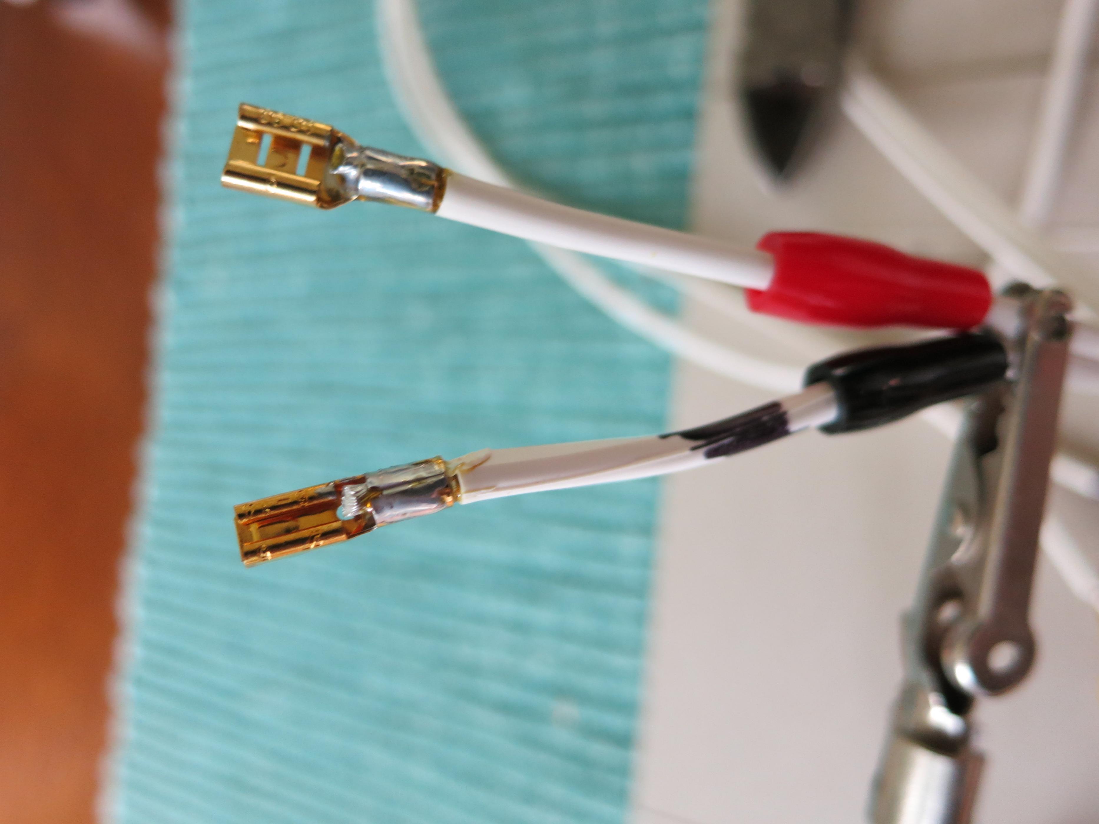

The kit comes with push-on connectors, but I soldered the connections except for the push-ons to the drivers. Soldering to drivers can be iffy.

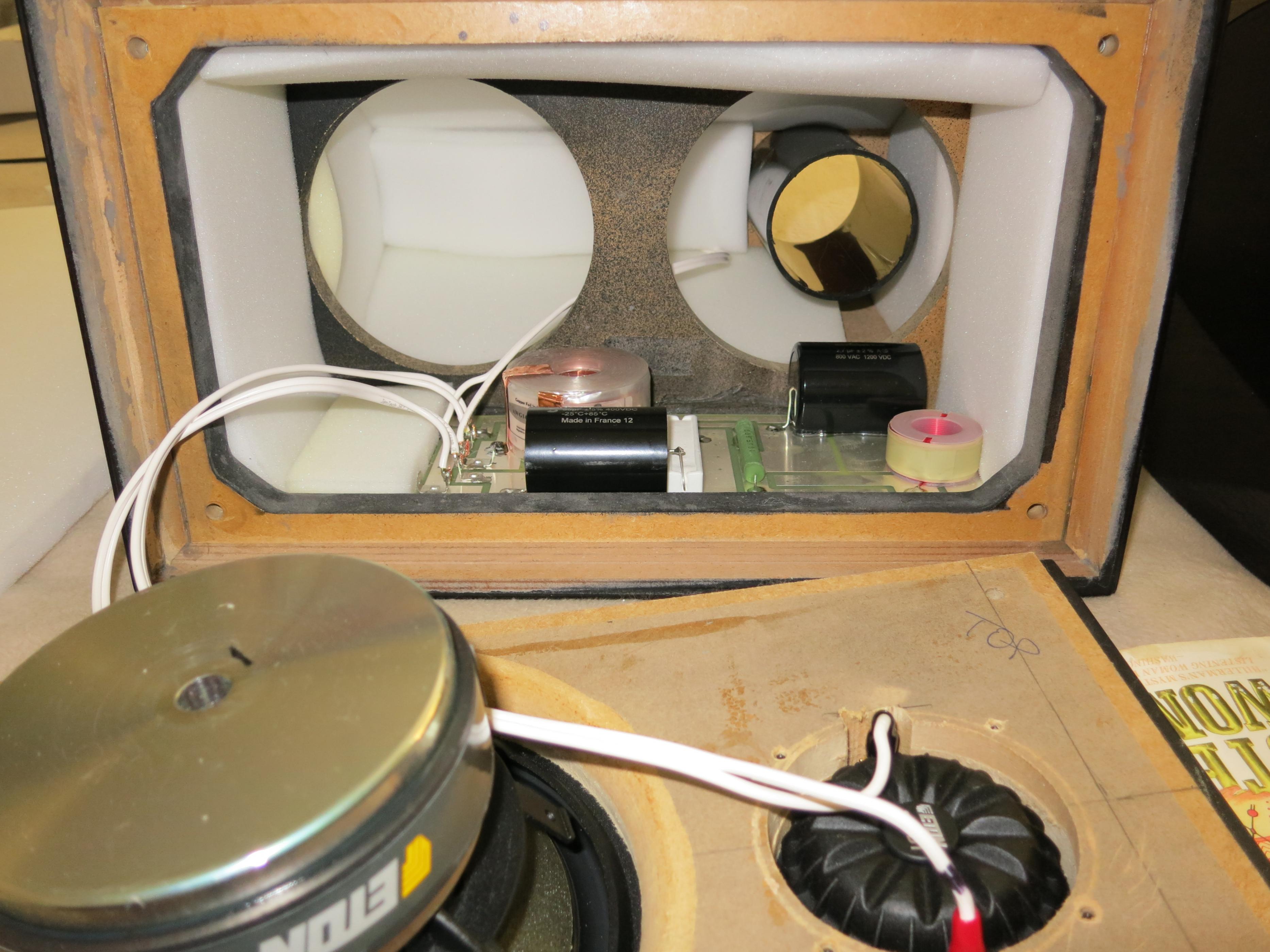

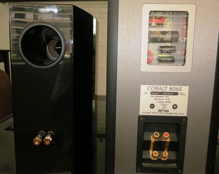

Foam goes in, and then acousti-stuff (not shown). The rear photo of the S7 next to the 806S shows the Focal crossover components (sorry for the reflections).

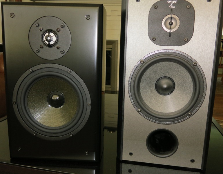

So how do they sound?
I compared them with some Focal 806S’s that have been my main speakers for the past several years. The Focals are no slouch for this type of vented 6+1 speaker. They are from the previous generation and have titanium tweeters and the W-cone sandwich woofers that are now found only in higher-level models. They are relatively efficient, also, rated at 90dB. The tweeter is a little bright, and the bass has a mid-bass hump, but the overall sound is quite transparent and clear. As I recall, Sam Tellig at Stereophile liked the speaker and enthused about the imaging.
I was hoping that the Etons would have a smoother sound than the Focals, especially in the treble, plus another half-octave or so of bass, without losing any dynamic punch. That they do, a very nice sound, just what I was looking for. The efficiency seems to be very similar, also, judging by using one Focal and one Eton in each channel for a while.
What I wasn’t expecting was quite a bit more detail in the treble and upper midrange, but it’s there, right from the get-go with no break-in. Clearly the Eton drivers are up to snuff. One of the promotional phrases for the Eton sandwich tweeters is “all the detail without any sharpness”, which seems like a good description of what I am hearing. What I think I am also hearing is the difference in crossovers. The Focal crossover is visible through a window in the back of the cabinet, and the components look fine but nothing special, with decent coils and no electrolytic capacitors in sight. The Eton crossover, though, has only one Mundorf silver-oil capacitor in series with the tweeter and one Goertz 14 gauge ribbon coil in series with the woofer. This certainly can’t hurt in relation to the very clear sound I am hearing.
In sum: I am very happy with the sound, and I had fun putting this kit together. I think things can only get better as they break in.

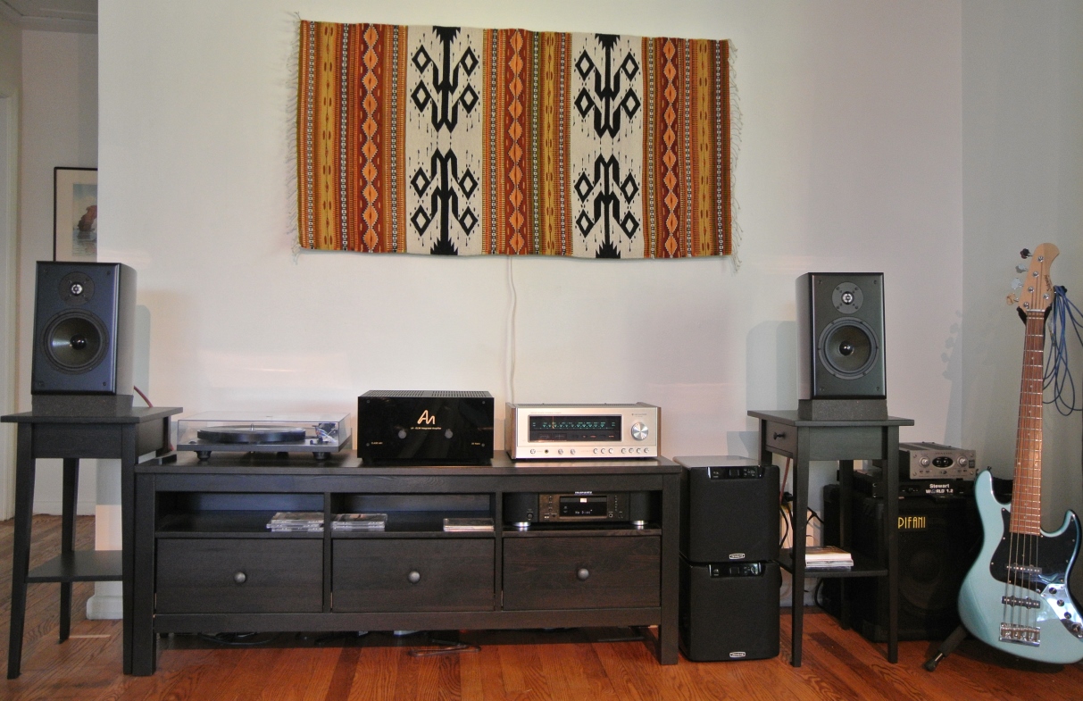

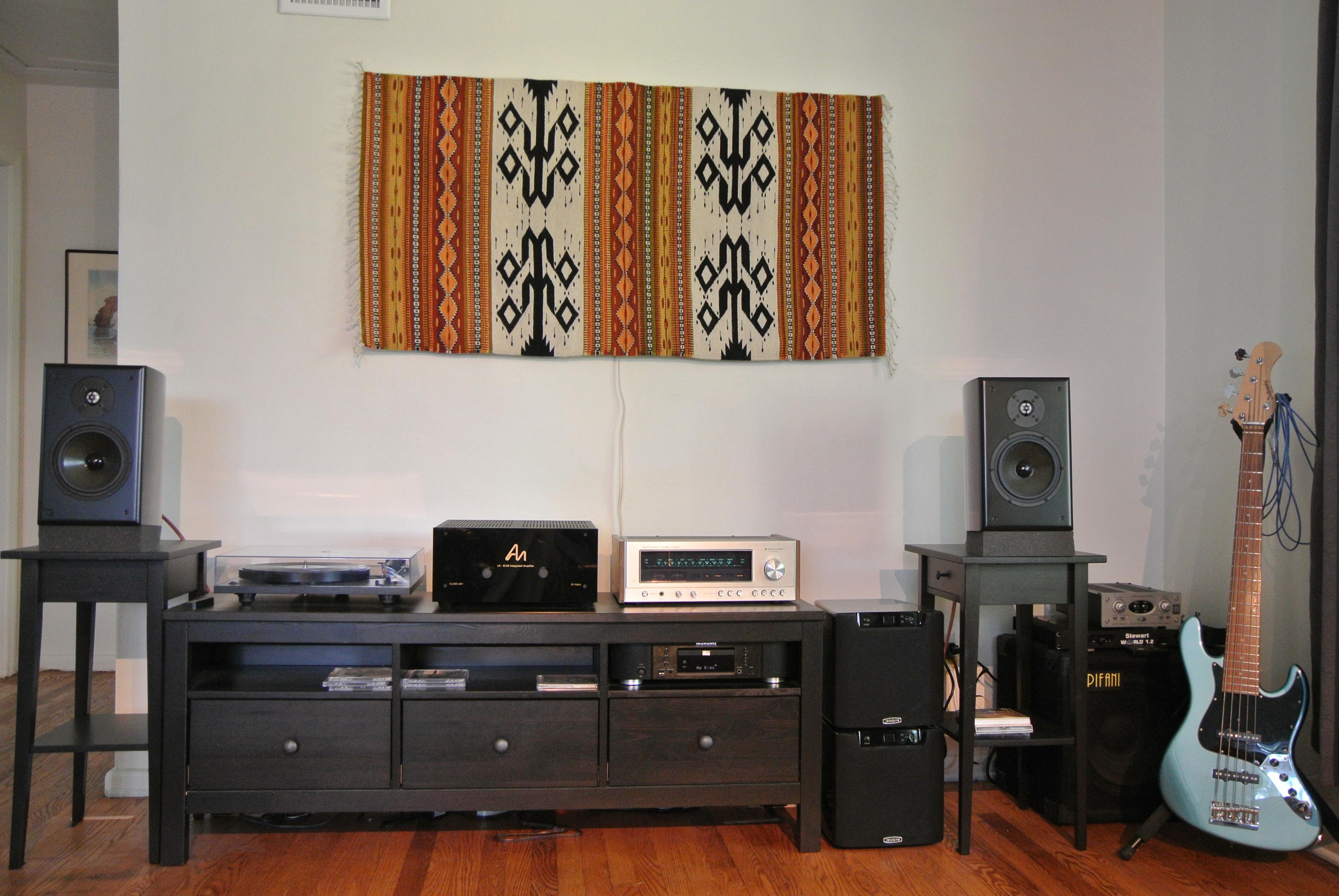

But the real answer to the bass concerns is: this is why I have them sitting on a pair of relatively tall skinny self-powered "subwoofers" that fill in the bass from about 60Hz down. These are run from a pre-out, and the S7s run full range. I haven't played with stuffing the S7 ports yet, but I did run the Focals that way.

According to the PDF file the primary inductor going to the woofer is only 0.68mH, generally speaking this is far too small to compensate for baffle step. Usually you will see from around 1.5-3mH for the primary inductor with a circuit of that configuration. If any BSC has been baked into the design then it will only be a minimal amount. If Eton anticipated most people wanting to place a smaller loudspeaker close to a rear wall or even on a shelf, then this is the correct design decision to make. If you can I'd try experimenting by placing the speaker closer to the rear wall, to see if this yields any pleasant results. If it does, a relatively simple line level circuit can be rigged up that will do this for you.

I have gotten some better subwoofers, though. After many different fiddlings, I have the subwoofers in parallel mono with different frequency and sensitivity settings.
The subwoofer on the floor has a very different room response than the one on top of it. But that is a whole different topic.DSC_0691.jpg
