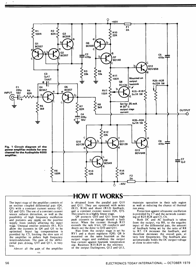

ETI-470 Amplifier - Spot the capacitor of doom
This was among my first 60W power amplifier builds a long time ago.
What is that tantalum C3 doing there? 🙄
Excerpt from: http://solaris.no/electronics/power_amp/ETI480/ETI480_theory.pdf:
ETI-470 “Designed by Phil Wait from an original circuit by [West Australian] Trevor Marshall”
'A 0.47μF tantalum connected the bases of the input differential amplifier pair. “Input lag compensation is provided by C3, limiting the slew rate of the amplifier to reduce high frequency intermodulation”. This gave the amplifier a very specific requirement to be driven from a very low impedance source to avoid distortion at higher audio frequencies. ETI needed themselves to publish an “interface” circuit (again by Phil Wait) to allow ETI-470’s to be appropriately driven in their Series 4000 stereo amplifier project.'
It used TIP142/147 Darlingtons and the VAS ran hot.
ETI Canada called it the Series 4000.
I just found my old PCBs and schematic, saw the cap 😕
it rolls off the treble

I expect Q7 is even hotter !

I recommend you change the input and feedback capacitors and add some RF filtering.
try C1 = 22uF bi-polar or two 47uF bi-polar in back to back formation.
try C4 = 1m5F (1500uF) with protection diodes across it.
Add an 1nF to 2n2F capacitor after the input 82r to Signal Return.
Check your PCB layout:
Is Input Return connected to R5 and to C4, by a very short, very low loop area, trace? i.e. not taken to some remote star?
The Vbe multiplier lacks a protection limiter in case the wiper lifts off momentarily.
The protection transistor Q9 starts to enter limiting when the current through R13 hits ~33mA. That allows ~66mA through Q7. That seems quite high to me. And reaches full limiting when Icq7 @ ~100mA

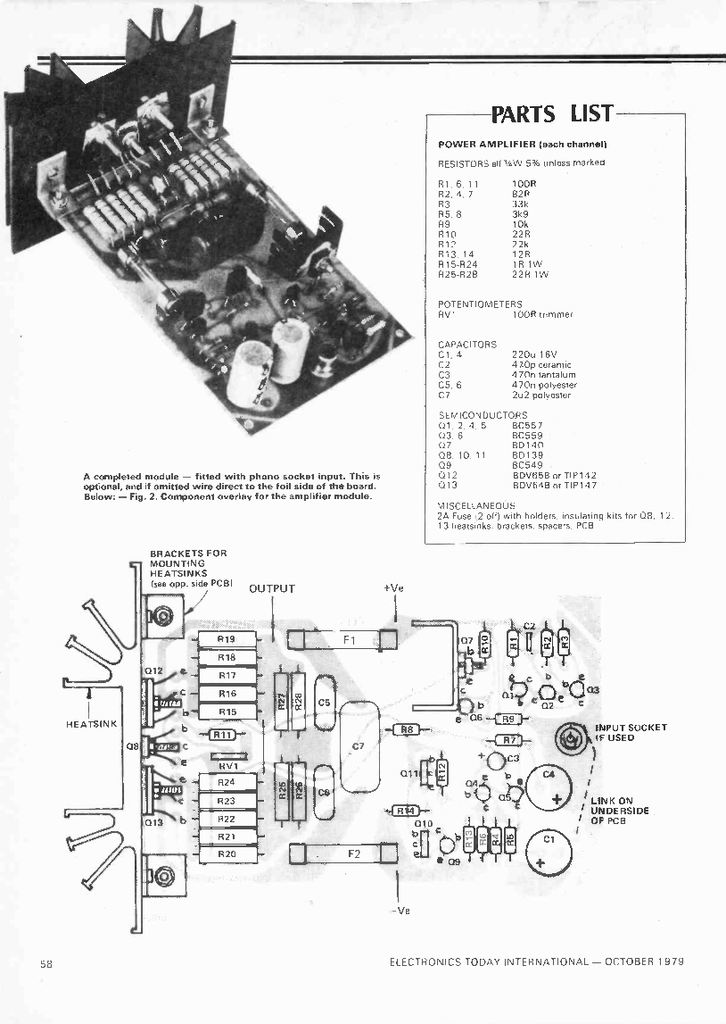

I built this amp in IIRC 1980/81. I replaced the output devices with TO3 MJ15xx types.
Served as my main power amp for many years until I scrapped it off in about 1994/5. I think the rail voltages I ran were about +-35VDC. I used the rectifier and capacitor bank assembly from a Marantz 240 that I had bought in 1976/7 that blew up and I was unable to repair. I also used the speaker switch on delay from the Marantz - worked very well.
The resistor feeding output damping network that has the caps returning to the rails had a habit of burning out - clearly some HF oscillation but I never tried to fix it - seemed to work ok.
Thanks guys, hmm I also built it in 1981 and yes I thought it oscillated cooking the damping resistors. Hard to tell many parts were hot at idle.
As I recall, it had poor PSRR and a fair bit of hum regardless of grounding and 10,000uF filter caps. I used the magazine's PCB artwork.
There's no compensation anywhere, so I wonder if it's stable enough to have C3, not that it's sane practice. I think it's just a bodge. If you want to roll off the high-end to prevent TIM, cap across R5 is what I usually see.

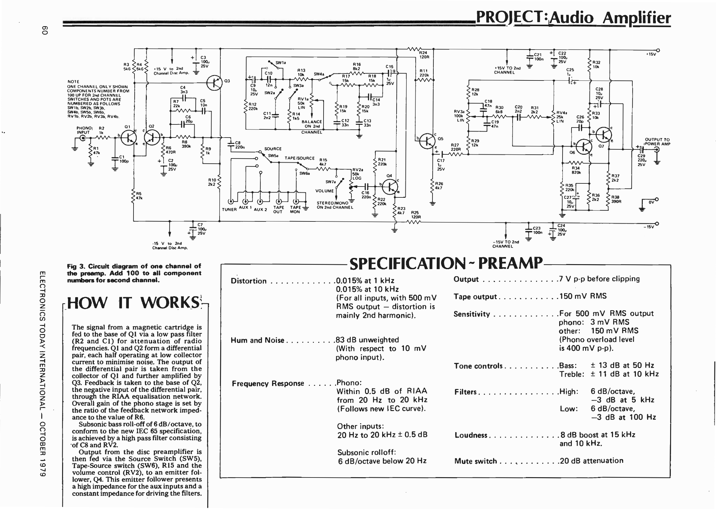

This is the Series 4000 Preamplifier schematic to go with the amplifier.
I built it and the phono preamp rated 0.015% THD sounded nice but noisy. Somehow max. hiss occurs at a 47k source, so it is optimized for noise lol.
