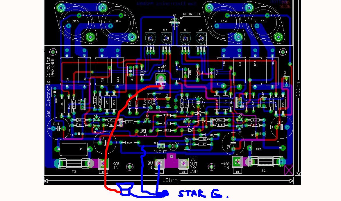

Hi, I have made the eti 466 amplifier years ago , recently was playing with it again made some differences to the box and wiring yet ther is still HUM , much less than before but havent completely got rid ot if , the transformer is far away its in a 5mm thick metal cage and many other things , checked ground wiring made sure all wires are thick and as short as possible , also checked for any loops anywhere nothing.
maybe there is someting wrong with the input ground ? the original pcb I made looking from this site
http://users.otenet.gr/~athsam/power_amp_300w.htm
in the schematic at the input the 10 ohm resistor to ground was disabled but maybe it would be better whne the common ground would be attached to the input via this 10 ohm resistor ?
maybe someone has any feedback on this old amp circuit just in case.
Yes, that 10 Ohm resistor was there for a reason.
but in your picture you have bypassed the r10 resistor as it is not there just like in my case.
if I understand correctly what rayma says the input ground shouldn't be connected directly to the common and output ground but it should be connected in series with a 10ohm resistor to the common ground , correct?
Yes, this reduces ground loop currents. This is commonly done in audio gear.
The PCB is obviously isn't the original ETI466 PA amp design. See here: eti300
The schematic though was lifted from ETI (Aust.) Magazine. It seems Sam Electronics decided to use it for their PA300WP product, though.
As it stands, the output and input grounds on Sam's PCB would have been tied together before taking a common connection to power supply star ground. That would be a noisy mistake, regardless of whether you fitted the ground lift resistor. I built the original on my own draft of the PCB way back in time and I certainly had hum and noise problems before I learned much about hum from ground loops and noise from lousy PCB layouts.
Agreed, the mod. shown with separate ground leads to star power supply ground would be much better but the rail bypass caps should also have been returned to PS star ground. Really, all measures should have been implemented but how quiet did a DIY PA amplifier have to be, back in the late 1970s?

so i did a little solderwork and now there are two thick ground wires coming from a common point connection at the filter capacitors to each of the two channel ground traces, the input ground is now connected with a 10 ohm resistor in series and only then soldered back to the common ground on the pcb.
as for my expectations , nothing changed , the hum is still there. when i first built the amp years ago i had much bigger hum , now when i took a second look after years of being put away i found some ground loops , so i repaired them and rewired the grounds , and the hum now is much less but it's still there and when connected to more sensitive speakers makes a silent yet audible low frequency hum in the background that pisses me off to the extreme 😀😀
yes the pcb is self made , i have a single thick ground trace on it and every component that has a ground conection is attached to it , even though the pcb is not " high tech" so to speak of I dont think its the fault here , i made one other amp from the Elliot sound pages , a 100w HI FI amp and it too has lousy self made pcb's yet its dead silent and works great , a guy made a third channel pcb of the same amp using pc and a pro looking circuit board and that channel is in the same amp as the two first channels i made myself and the pro looking channel hums while my channels don't.
