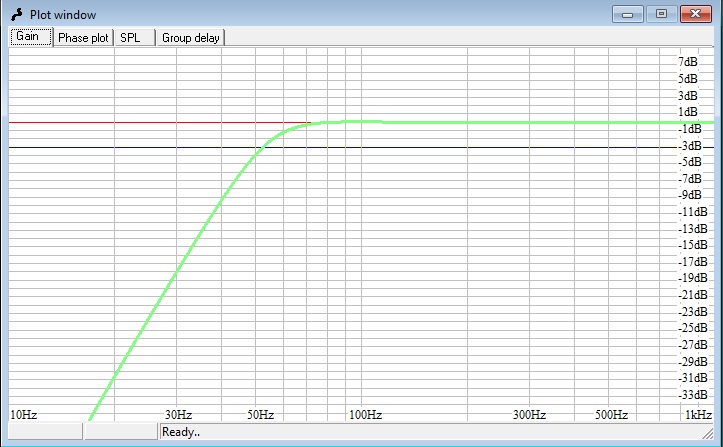

So I've attached a zip file with my WinISD results.
It includes the WinISD file and a text file with the results and design.
I think it looks pretty good. (but I'm a Rookie).
My enclosure design currently has an internal volume of 1417.5 Cubic Inches.
This was actually derived from the Fat Box formula referenced from my textbooks and targeting 1400 Cubic inches. (See attached text file).
So Imperialistic calculations. I did this as a base line volume.
WinISD calculates the "Optimum" volume to be 2100 Cu.In.
A 50% addition to imperialistic volume.
Another reference suggested adding 25% to imperialistic volume.
Which would be 1750 Cu.In.
So my first question?
Does WinISD calculate optimum volume by oversizing the enclosure to account for "Normal" Batting?
and/or
Do I need to add volume to the base line, for example the recommended 25% increase.

Well I just remembered that WinISD calculates "Outer" Dimensions based on thickness.
All the same, what is recommended regarding adding volume to account for batting?
Huh?! Don't currently have any version loaded, but the two versions I've used [pro, 0.7] calculates net Vb like every other program, so doesn't include the driver, vent, bracing, etc., and any fibrous damping is presumed to be too little to be considered.
There is an old rule-of-thumb to add 10% to cover all this though.
FWIW, at a glance and based on published specs I would put the 1411 in a ~1775"^3 net cab.
GM
You're welcome!
FYI, I used a proprietary speaker design routine that predates T/S by several decades, but if you sim it in T/S you'll find that it provides an optimum compliance referenced to driver Vas, so not a fixed percentage and of course only as accurate as the Vas spec.
No, just a bit of history relative to this 25% suggestion I don't recall ever knowing about. I come from a time when speaker efficiency was a prime design goal, so I normally design cabs quite a bit larger than what T/S recommends and if it 'booms', 'rings', then 'critically' damp it to ~ 'have my cake and eat it too' same as the pioneers did.
Anyway, in your case I recommend using WinISD to calculate approximately how much volume the driver takes up + calculate any loss from bracing, etc., and add it since the cab is physically small, so adding 10% might not be enough.
Then again, many folks don't notice any obvious difference in sealed bass performance until the system Q [sysQ] is very low [rolled off bass] or very high [mid-bass 'boom'], so we're talking 'nit-picking' theory on a subject where there's so much latitude in cab size that it's mostly moot.
GM
I like your suggestion. I have been a little worried about under sizing.
You can always add the appropriate amount of batting in a slightly over sized cabinet.
Tune it by ear until it sounds good.
But you can't add volume to an under sized cabinet.

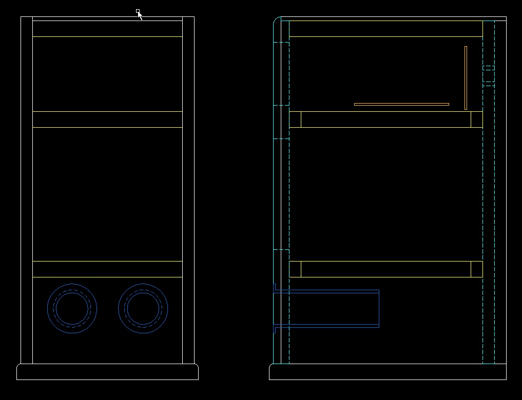

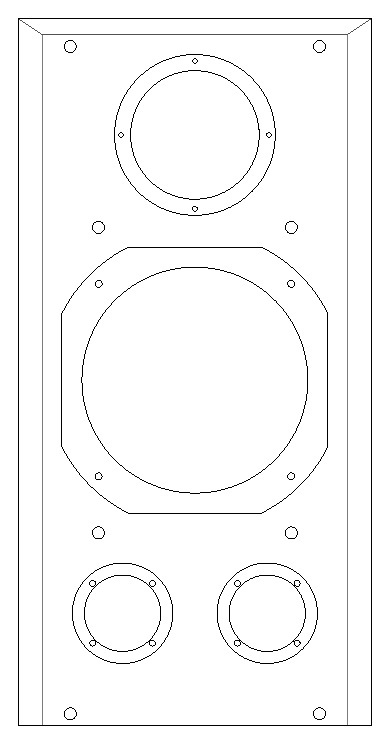

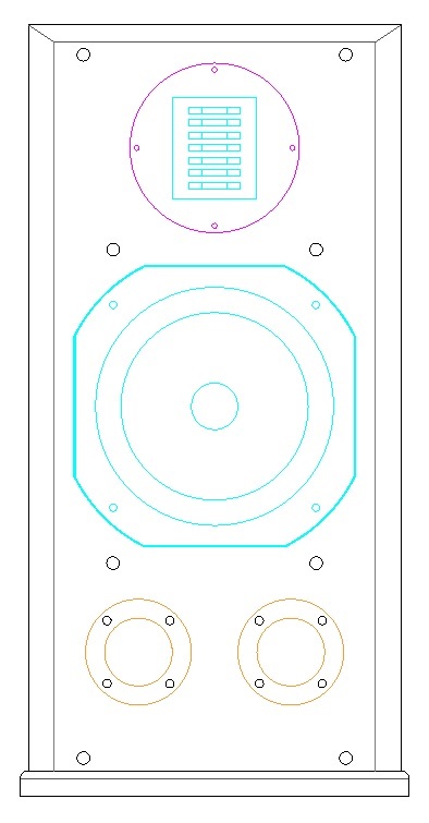

Here are some sketches of the newly sized cab.
External Dimensions (Inches): 11w X 15.75d X 23h
1" Baffle, Braces and Base.
3/4" Rear Baffle and Sides.
Kinda hard to imagine the true plan.
Nothing fancy.
OK, look forward to understanding.
Just to clarify, the bottom brace is the only real "brace".
What looks like the middle brace is really the enclosure top. (Solid).
The top of the Cabinet will look similar to the bottom brace, with cutouts to access the crossovers. It's also hosting the AMT.
The top will also be covered with 1/4" Smoked Glass to hide the crossovers.
