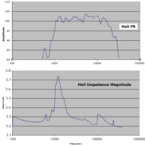

I have read here among the threads that the measured impedance of the AMT 1 series the "great heil" is about 4 ohms. However, I keep hearing about some AMT 1's that are 8 ohms. I have a pair of AMT 1's and the measured DC resistance is about 6 ohms. Is it possible to have a 4 ohm AMT with a measured DC resistance higher than it's impedance or do I in all likely hood have 8 ohm AMT's? I've included the original graph I found posted here. To add to the confusion I called Orange county speaker repair , who sell replacement ESS AMT diaphragms and asked them the impedance of the diaphragm. The sales rep said they were 8 ohm as listed in their computer. When I asked her if she could double check she spoke with a tech who said they are actually 4.

Is there no way you can measure your amt1s? The impedance will be frequency dependant anyway and you want to know what it is at the chosen x-over frequency. The nominal value is an indication only...I've included the original graph I found posted here
The graph you attached shows impedance varying b/ween ~3,2-3,7 depending upon frequency, anyway, not 4ohm.

Ahh... that explains the blip at 1200 that I can't seem to get rid of. I thought the fs was around 800. In any event, my Great Heils (from an AMT 1B - old diaphrams) measure 3.9 Ohms with a meter.
