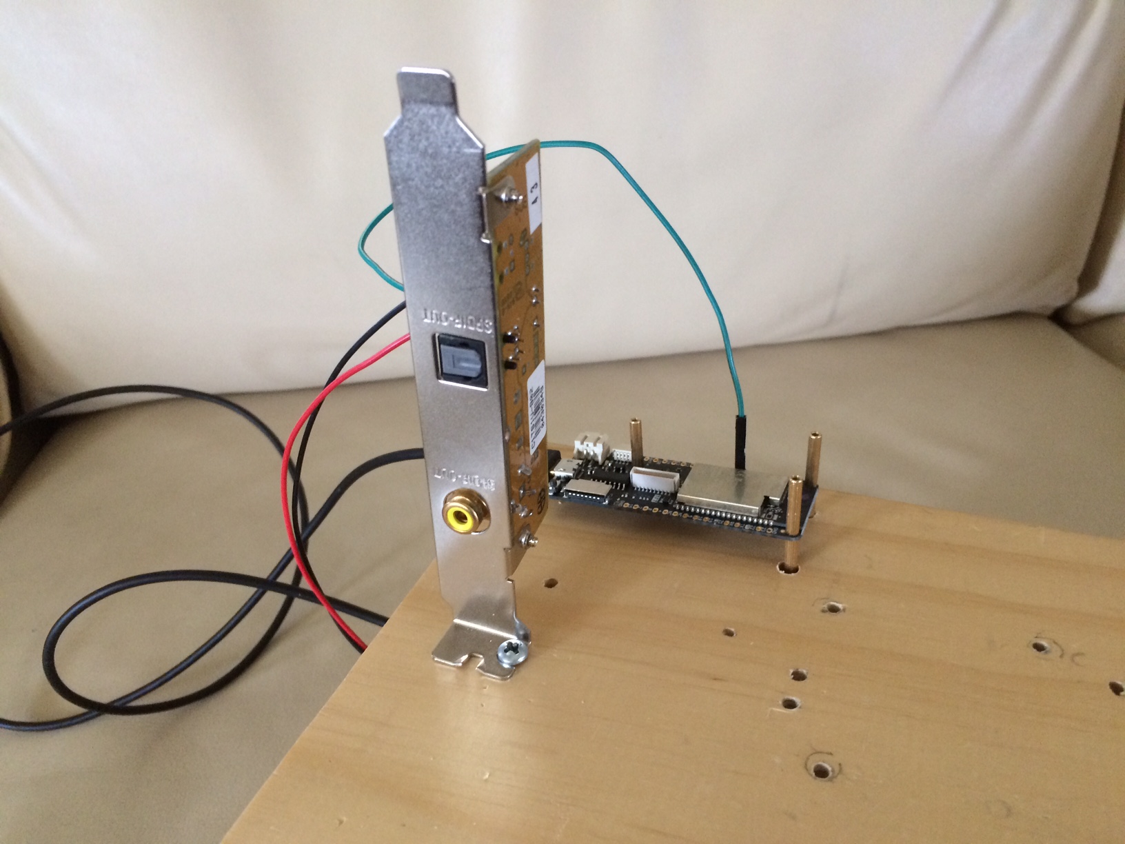

Here's a test setup of my ESP32-WROVER configured with S/PDIF output. It's connected to a S/PDIF board that's normally connected to a PC's S/PDIF motherboard header.
Mike
