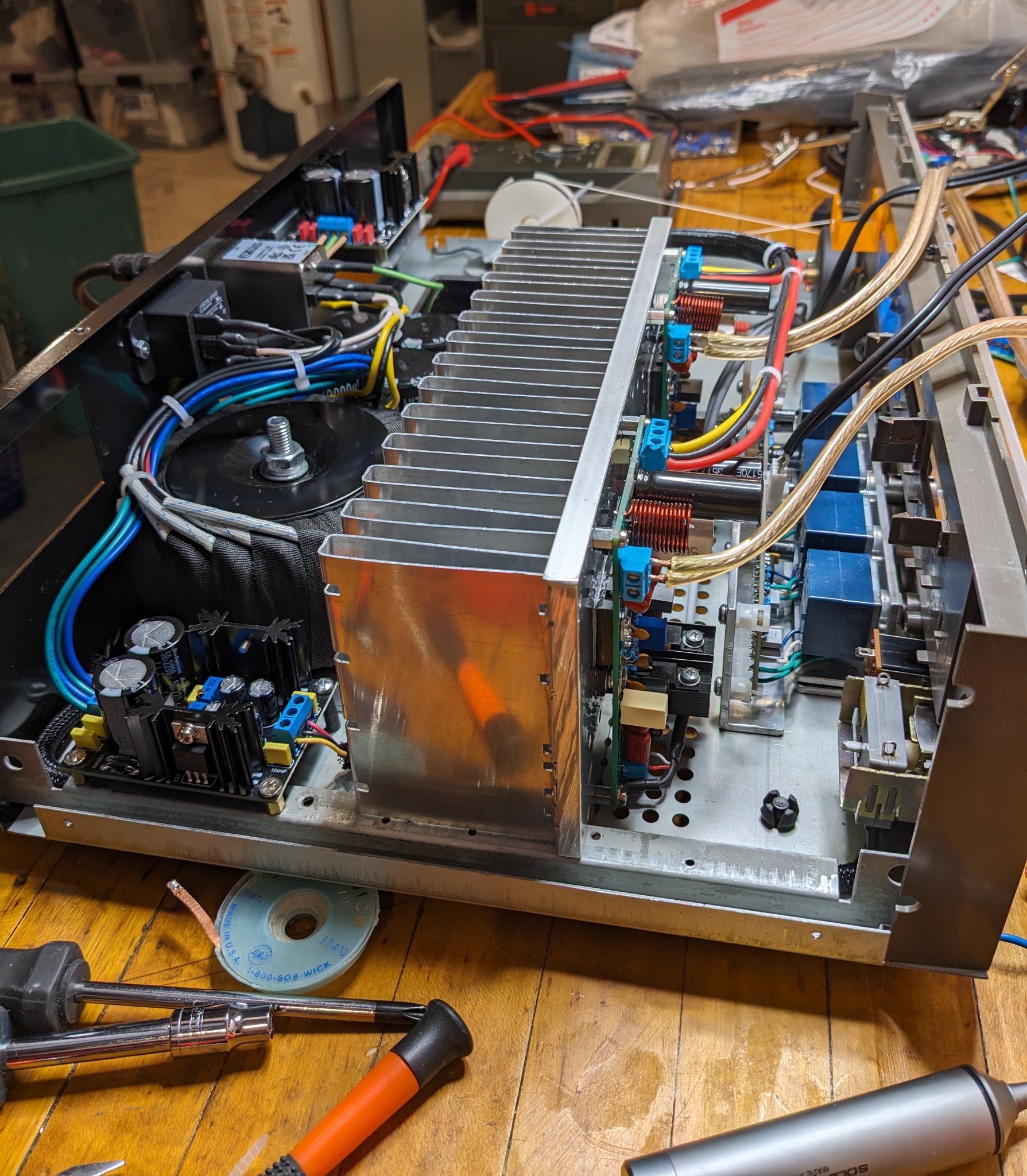

I am building a Rod Elliot ‘Hi-Fi with tone controls preamp’, project 97. The power supply will be inside the chassis along with the amp board and phono preamp board, and consist of a +/- 15V from a toroidal transformer + bridge rectifier and filter caps.
In addition to locating the transformer as far as I can from the inputs and amp board, should I insert a steel or aluminum separator , like I see in so many pictures of preamps?

I would say it's unlikely you'll need any shielding of the transformer. Lay everything out the way you want and give it a listen. This is a good article that helped me. The headphone trick is especially helpful.
I built the project 97 preamp as well and I have no hum with the setup pictured. I mounted the board vertically and divorced the pots because this was a retrofit and the spacing was different than Rod's board. Despite the longer leads it's still silent. Read Rod's article on grounding and use a ground breaker. You are more likely to get hum from improper grounding than from the transformer. More good articles referenced here.

I always do use a steel, case divider to isolate the power traffo from the PCB, with source components.
Thanks for the links to the articles. There's a lot of information there. I think I'll try it without a shield, and test for hum. If there's hum I'll troubleshoot and try a shield or something else. BTW, I think you posted the wrong pic. ;-)I would say it's unlikely you'll need any shielding of the transformer. Lay everything out the way you want and give it a listen. This is a good article that helped me. The headphone trick is especially helpful.

It's hard to see but Rod's preamp is in the pic right behind the blue pots. Mounted vertically to an aluminum plate.BTW, I think you posted the wrong pic. ;-)
