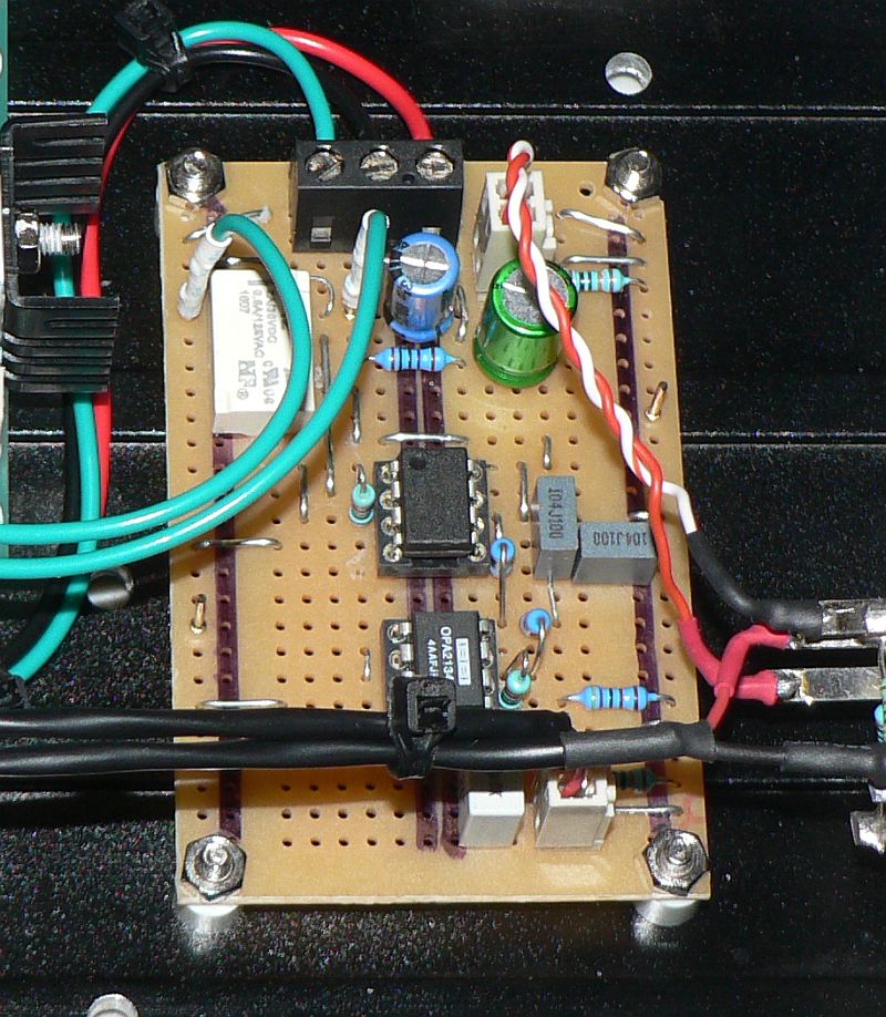

I used the LP section of the P81 in sub processor and have the volume adjustment before mono mixing resistors prior to the buffer op amp U1. The output I used is the same as the first schematic but I had to add a 100K resistor to ground on the output after the 100R. I can't remember the issue but it was noise or DC offset.
