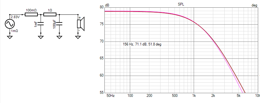

Possible alternative: although you cannot make an exact second-order Linkwitz-Riley filter as a passive RC filter, you can get pretty close by cascading two first-order RC sections and giving the second a much higher impedance level than the first. I did some calculations on that years ago, especially about how to tweak the RC times for minimum error, I can look them up if you are interested.

I have some doubts about second order passive RC filters, not many positive things have been written about them online.

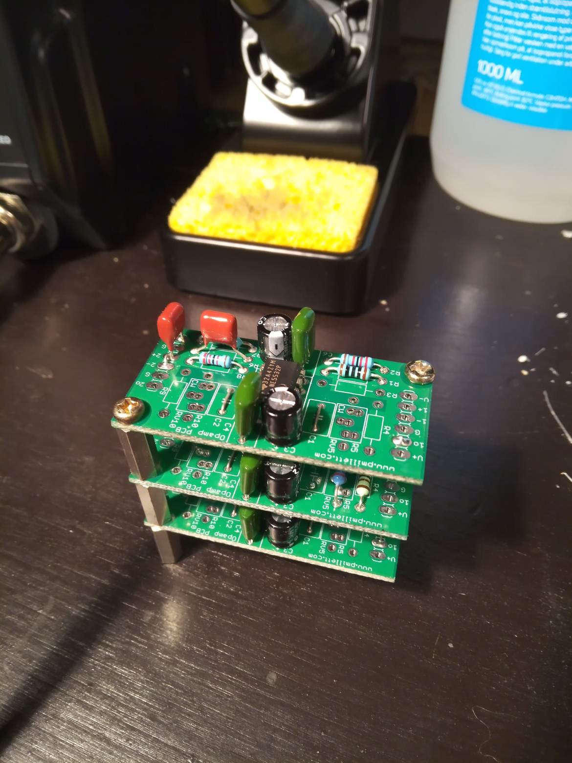

After 30+ years of struggling with primitive, cr*ppy soldering irons I finally bought myself a proper soldering station today.
Suddenly, soldering pcb's is almost fun... Here's three of mr Milletts Opamp Experimenter PCBs assembled as a 12dB/oct 72Hz L-R filter with mono sub output

I wouldn't say that a PLL crossover does things badly because if a design doesn't work well then it should be easy to measure that.
However it sometimes challenges your design skills. I have been in a situation where adding the complexity of different needed correction curves can make it fall into line, albeit with a commensurate circuit. On the other hand it may be easier to use simple single order rolloffs and just benefit from less drive to your amplifier... add the extra in another way.
Here's a generic attempt to do LR2. Quite reasonable for a simple circuit. In any case, it's rare that you need exactly that.

Yeah, that isn't going to work. 🙂
The essence of these PLLs is scaling the values such that they (pretty much) accomplish the filter slopes, but also can be driven by a typical line-level source.
A good (low output R) headphone amplifier is preferable in most cases.....vice a typical preamp which probably has an output of 50 ohms or greater.
The Harrison Labs filters approach the solution in that way. It's sort of successful, in some instances. 🙂
I don't consider them poorly designed, but rather designed as well as they can be considering the requirement for some sort of consistency with various source output resistances and load resistances that customers might have.

I've made some pretty sophisticated PLL filters by sacrificing insertion loss... so if you're not afraid to throw away 10-20dB. As it happens the filter shown above is only down 1dB.
1k to 50k ohms gives you a couple of orders of magnitude to work with.
