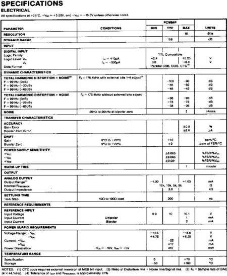

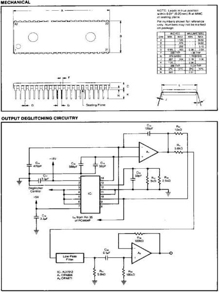

Thanks for the information..... You just got the first page of it? If you have the complete datasheet, would you mind to share with me?
Yes! It really make me confuse when I check out the pin by follow the circuit... I think I will keep the I/V stage there and just modify on the filter part only!
Hey Gudio, I also have the same idea of you... But I need to know is there really have the re-clock there... Now just can confirm that there should not have PLL!!!
Thanks of all!

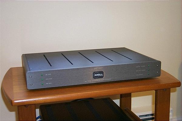

I am planning to upgrade my Krell 20i. Apart from the clock and relocking of the digital ouput, I would like to do something about the OP37 and other opamps.
Are you saying that I shouldn't touch the I/V opamps at all? I find a schematic and would appreciate help from anyone who has worked on the Krell.🙂
Audiofanatic said:
BTW fmak,
If you have the schematics of you'r 20i KRELL I'll be glad to help you with it.
Sorry, I mean to say that I could not get schematic. The Krell 20i uses the same BB chip (PCM64K) and I was wondering if I should touch the I/V section at all.
Does anyone have a schematic of the Krell 20i please?
Hi fmak,
The schematic, will be heard to get or impossible.
If the I/V stage is built with OpAmp's than I urge you to build a new one with descrete components. I'll see what I can do for you.
The I/V stage of the PCM64P can be made without OpAmp's.
Like the KRELL SBP64X DAC. I don't have the schematic of the KRELL but I do have the KRELL here and I can try to lookfor you and hope that you will not need a balanced output.

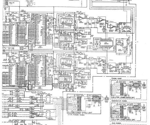

This is what I found in the data's I have from a DENON CD Player.
I hope the file is not to big.
Audiofanatic 😉
Thanks; will be in touch when I start on it.
