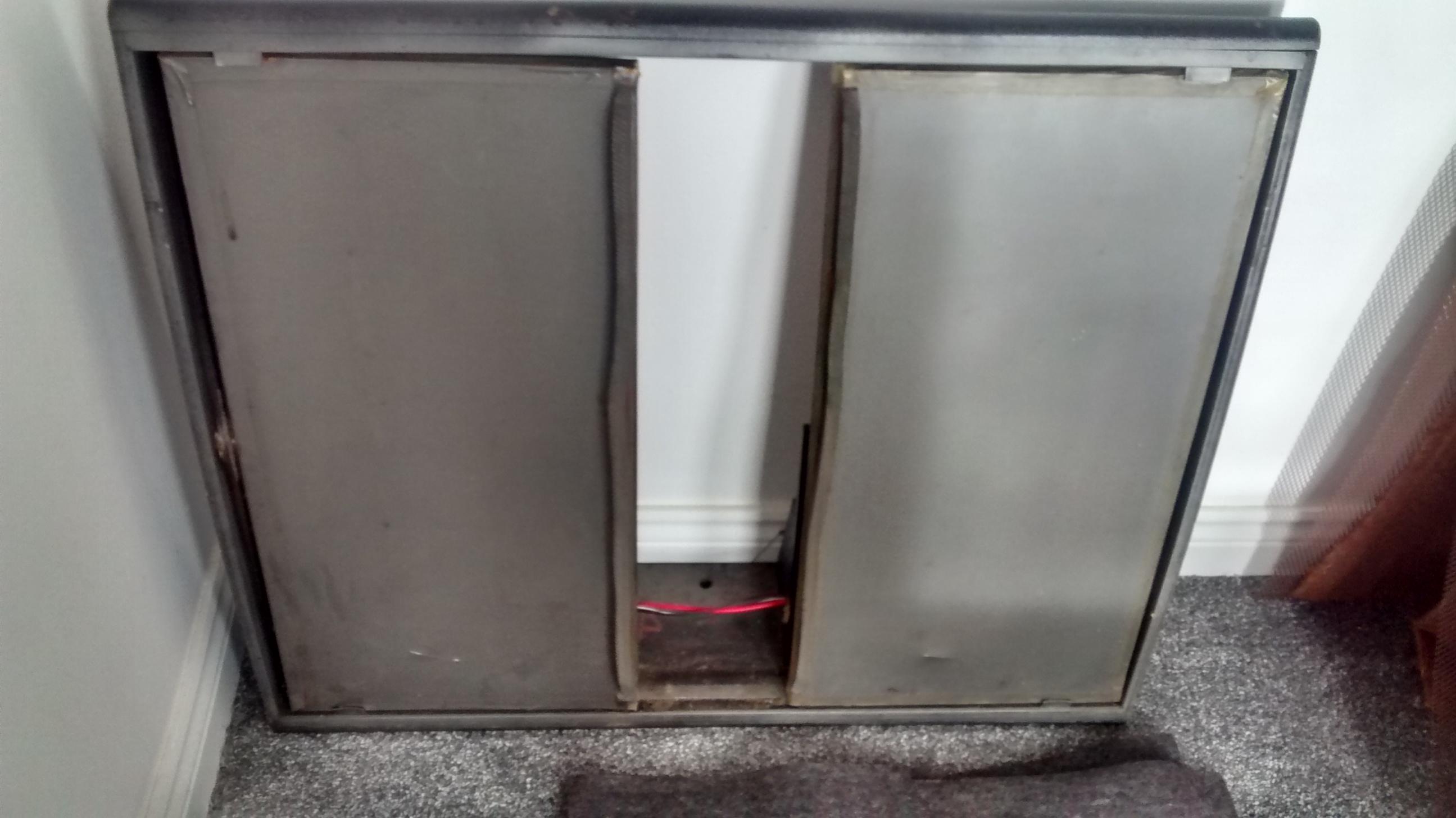

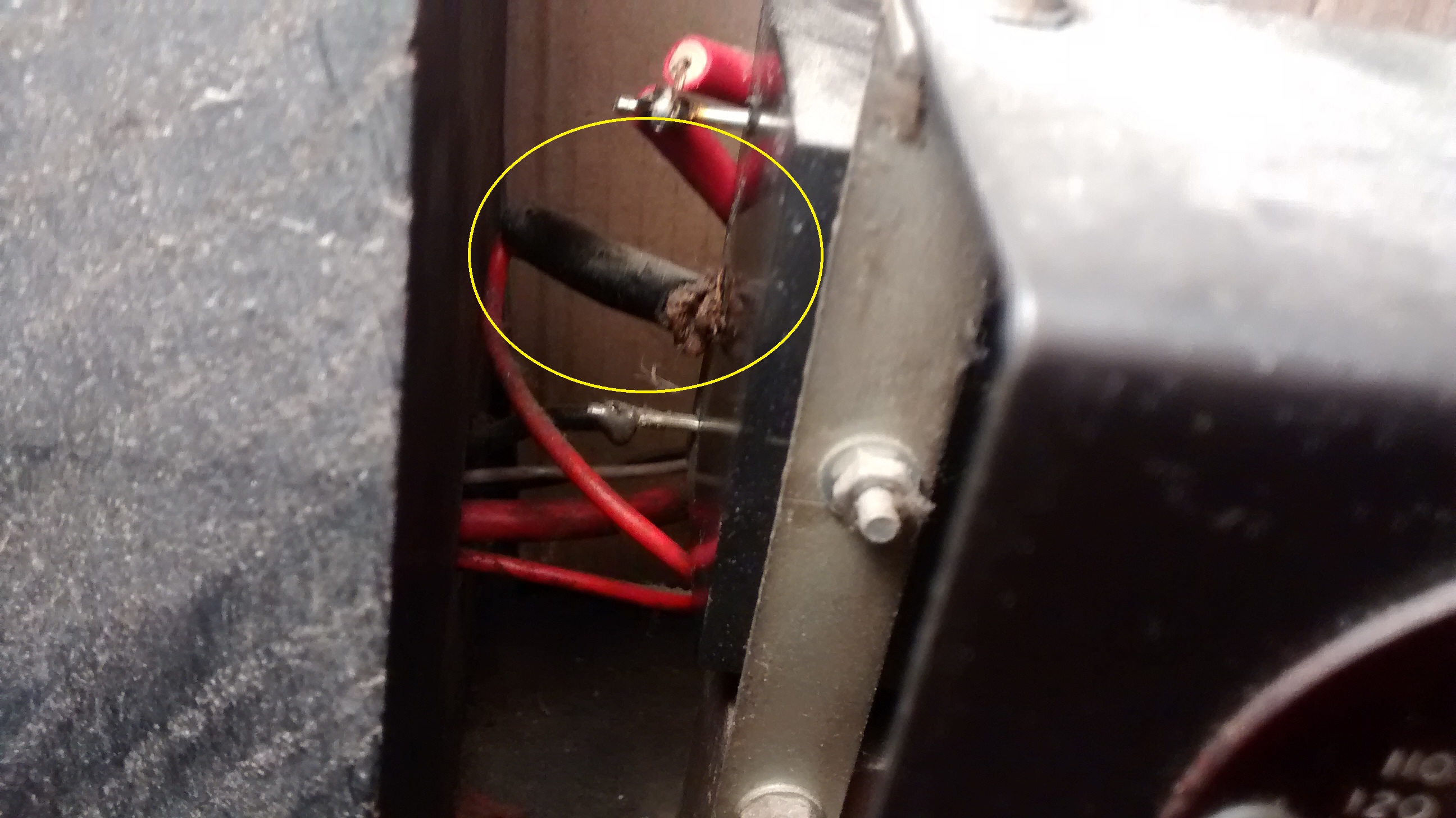

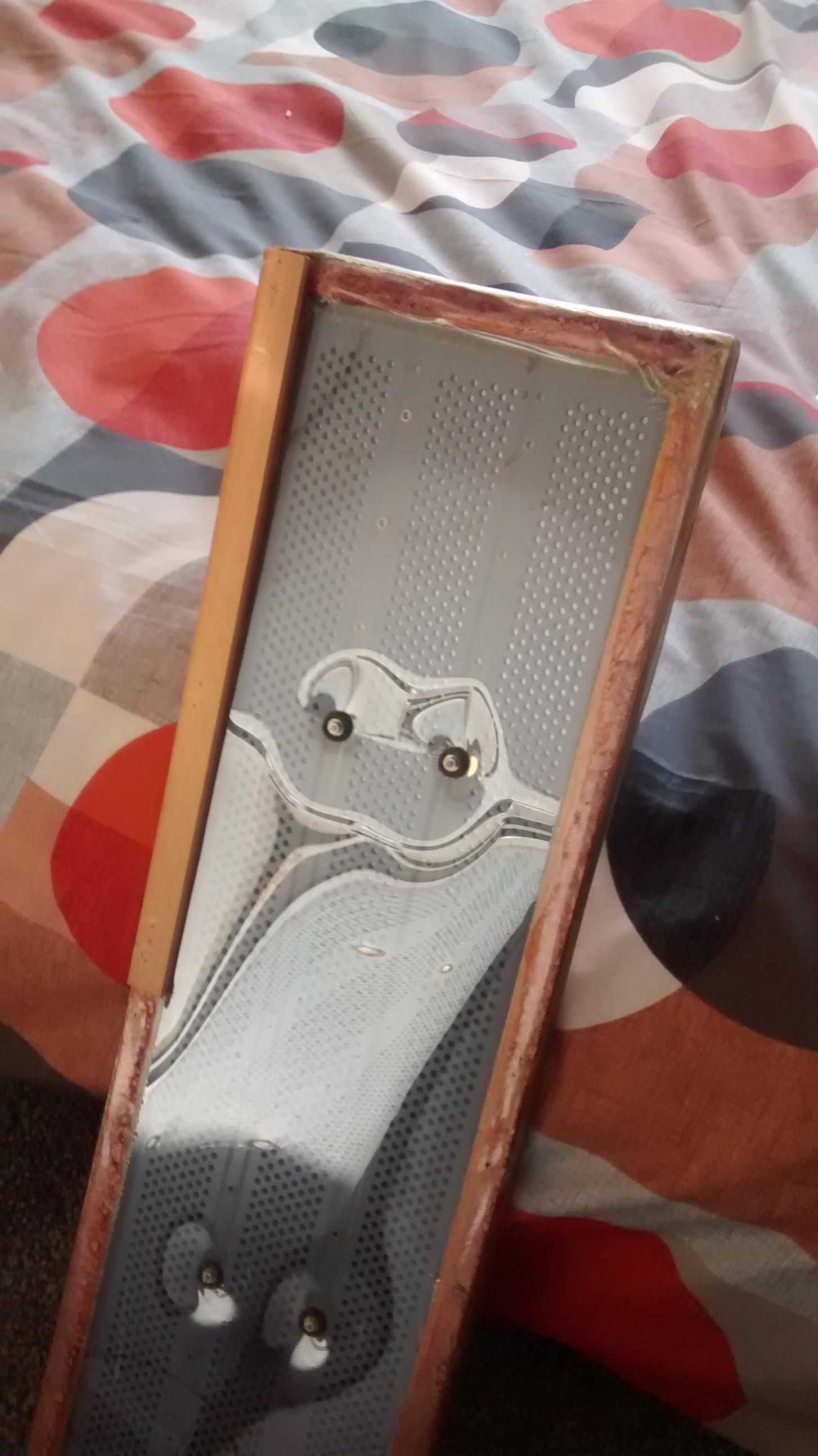

Hi just beginning to strip my Quad ESL57 due to a burnt treble. I've run into a problem with the the removal of the 1.5Kv treble feed wire where it is connected to the EHT unit. There is thick rubber sleeve on the wire as it enters the EHT and I cannot see the solder post. Has has anyone seen this and what do you suggest. Of course I'm tempted to cut the wire further down and then remove the EHT to get a better look, but I thought I would ask first

Thanks yes it looks potted, Does anyone know were I can get a suitable pcb for the EHT? I looked online and they wanted £150 for a pair, crazy the caps and zener will cost very little. Either that or reverse engineer the present boards and etch my own single sided pcb
Those are non-servicible epoxy style blocks. Do you want a bunch, free?
I unbolt the power supply and pivot it toward the back of the speaker and cut the wire or slice the tubing and unsolder the wire. Those blocks generally just get tossed out. I have a bunch that work if you want an old rickety circuit element that could fail any moment.

Thanks Stokessd, I've decided to make new ones. the circuit doesn't look complicated and it's probably best to do it while they're been refurbished. It the treble panel rebuild that's worrying me the most!

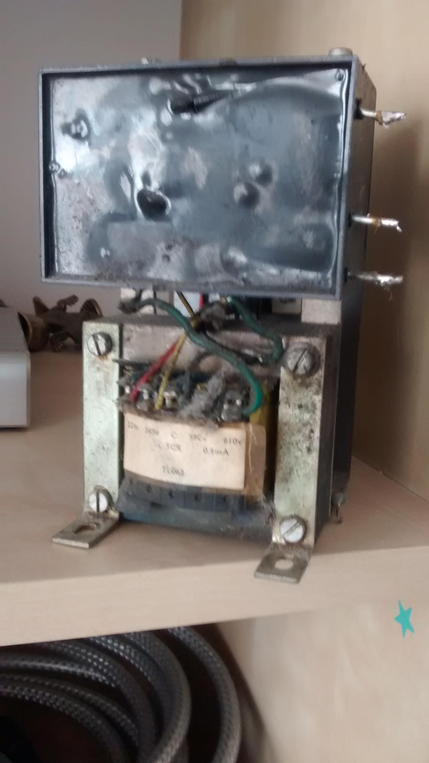

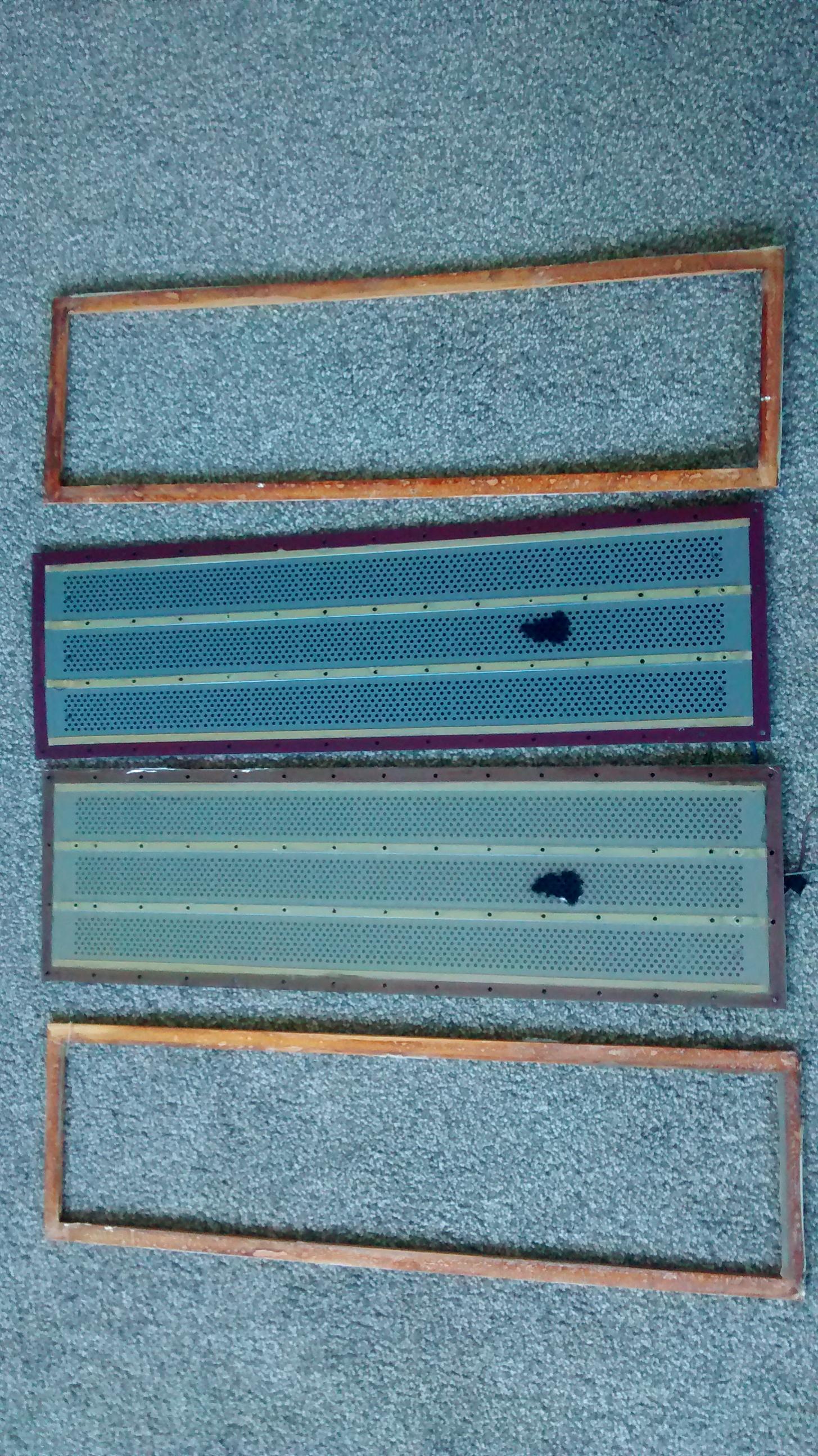

Well spent a while today removing the audio transformers and the the EHT units. The burnt treble panel is out. I hope I'm not boring you all but I am doing this as any other novices are thinking of doing the same thing and as an "aide memoire" for me. The EHT unit are resin potted and new board will have to be made or bought if I can get a pre-made PCB. Never made a PCB but I believe that it can be done with a laser printer, heat transferred and etched. I going to do a little more research before splitting the treble panel and the job of removing the rivets. Can anyone recommend material for replacing the dust covers on the bass panels? Is thickness important? Thanks for everyone's help so far

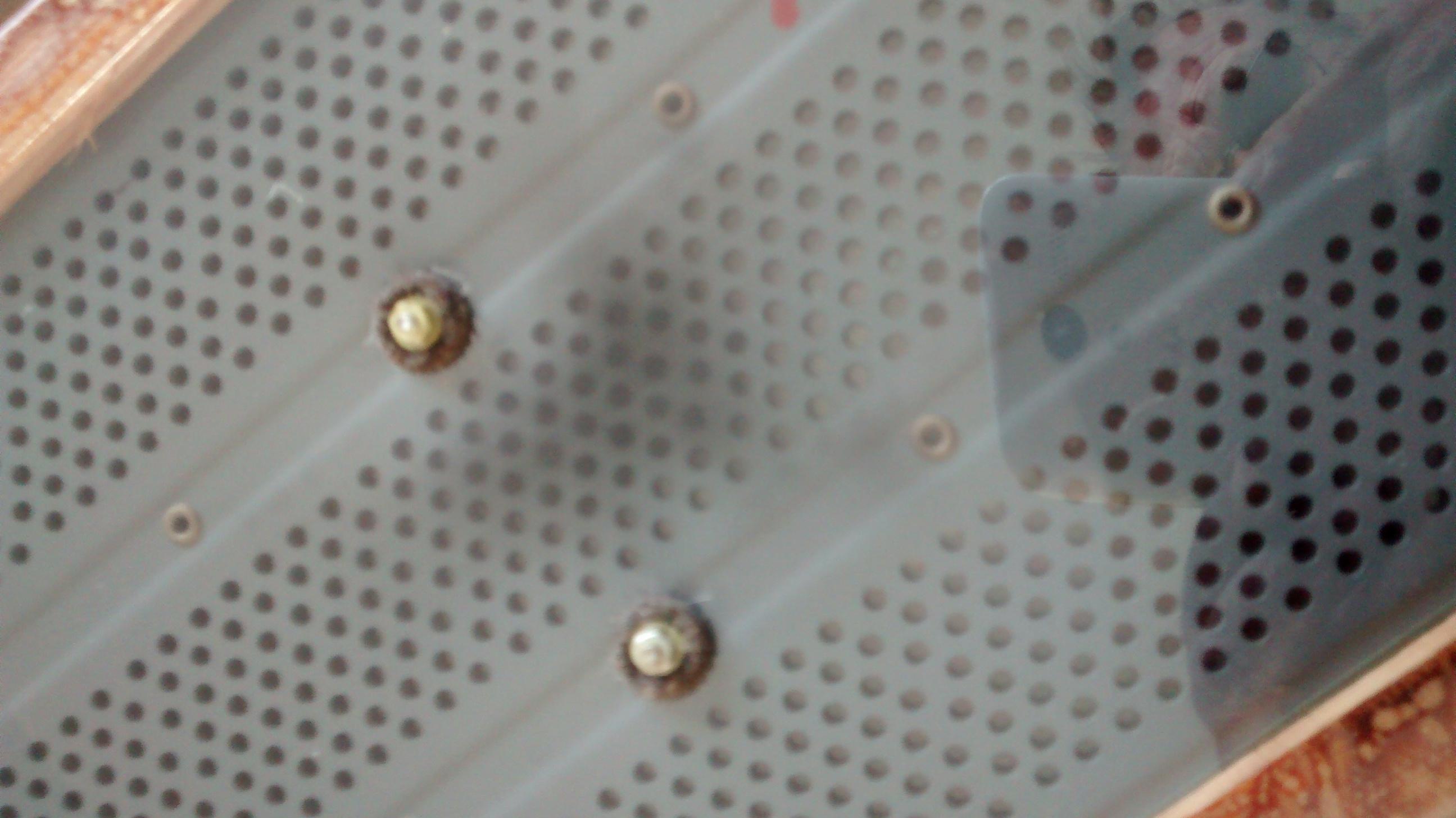

Hi been looking at Fabien's ESL57 World website, says to use the same material for the dust cover as as for the diaphragms. Got all the rivets out the the damage treble panel this morning. While I'm waiting for the Mylar arrival I am going to look into the method of DIY PCB's for the EHT. There is a PCB design on Fabien's site for both EHT and Clamp boards. Any one done DIY PCB's before? Any tips?

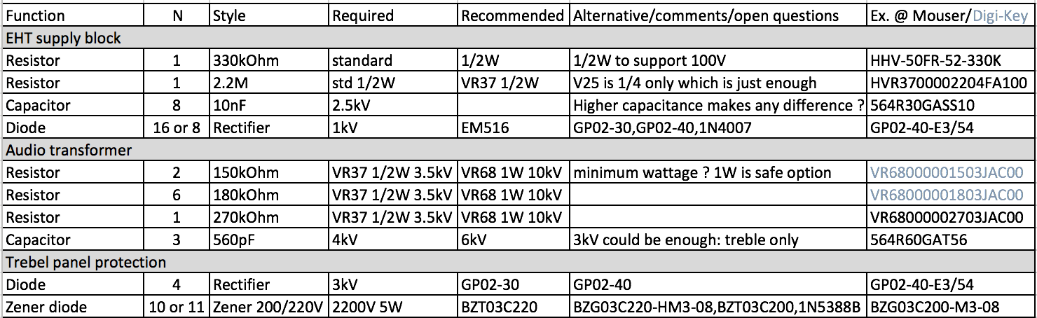

Thanks for the links. Could you confirm the neon lamps spec 500uA?. Are all 10nf caps 2 or 3Kv? diodes GP02-30 (marked on board) resistors all 1/2w ? What do you recommend for the 2 x 47nF?

Lapitude, I got the 3 kV caps some years ago, and the GP02-30s from Digikey, because I also ordered the Pomona HV cable. FWIW I would recommend getting the treble clamp boards, and some new HV cable. Depending on the age of the existing resistors in the transformers (x-over) it will probably be worthwhile replacing them and the caps at the same time. The neons recommended are these A1A Visual Communications Company - VCC | Optoelectronics | DigiKey
HV cable is: 6733-2 Pomona Electronics | Cables, Wires | DigiKey and 6733-0 Pomona Electronics | Cables, Wires | DigiKey
The SMD zeners I got from Mouser: BZG04-220-M3-08 Vishay Semiconductors | Mouser Europe and more neons A1A VCC | Mouser Europe
Kevin
P.S. If you want a list of all the resistors drop me a PM, as I had to source them from both Digikey and Mouser. Neither carried all the resitors needed at the time.
