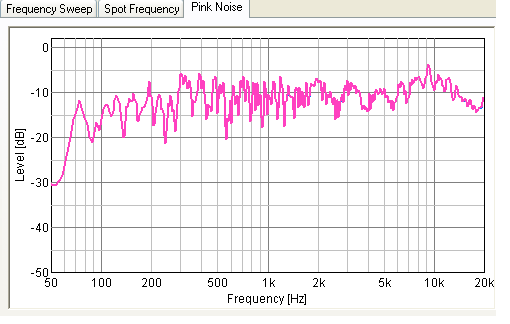

this is my small panel, measured in a anechoic chamber using Monkey Forest and a B&K-Mic-capsule.
Input power was ~50W, which translated to a SPL of ~122dB@4m!
It´s the point just before the membrane touches the stators.
The panel is used at freqs >250Hz.
IM-distortion tests ended with trying to find a ´special´ 2-tone combination where IM-artefacts became just visible with ~-70dB.
At normal listening levels the panel is virtually distortion-free.
A very deciding point is the quality of the amp and the audio transformer. Most of the distortion stems from the tranny and a unstable amp can reach easily much higher distortion levels than a well executed panel.
This is very different to the rather high distortions of ribbons and magnetostats. The ESL is pure and clean up to earsplitting levels as no other loudspeaker principle.

Ummm... Calvin?
Ur saying that your reference sensitivity is over 100dB/1w/1m??
Please tell me/us how you manged that in an ESL that is not very narrow band?
You say this is your small one? What is small?
And the three curves, 2nd, 3rd and 5th? Or??

@Mor
there are pics and descriptions of the panel in earlier threads.
@Wayne
No I didn´t say that and didn´t even thought that there was any room left for such an interpretation. 😉 There are of course many who prefer a rather distorted signal (especially with K2) over a clean signal. But thats a matter of taste. Objectively the signal quality of a well executed ESL (in the midhigh frequency range to be precise) is the best I´ve seen in any loudspeaker.
@bear
uups I cited myself wrong
The measured value is 110dB@4m, which translates to 122dB@1m for a global distribution character. For the panel the SPL value at a distance of 4m is higher than at 1m because of the cylindrical distribution character. If You recalculate the SPL@4m to the value @1m for a global distribution character, You have to add 12dB, hence 122dB.
In praxis the global player won´t loose 12dB with a quadrupling of distance because of a not ideal global distribution and room acoustics, but on the other hand it suffers from thermal compression, spider progression related compression and BL-nonlinearities which add up to 2-3dB. A ESL-panel dose not suffer from compression until the diaphragm hits the stators. The SPL over input power curve is very linear. So, 110dB@4m is the real measured value, 122dB@1m is the calculated equivalent value for a global distribution character.
The curves are K2,3,4 and 5. K5 can just be seen as a very small peak around 4kHz and -75dB.
Measured with a MB550 mic-capsule You roughly can add 0.1% to 0.2% to these distortion values and even higher values when using cheaper mics. Even though the used B&K capsule came fresh from testing and calibrating by B&K, I don´t know the distortion figures for this capsule. But it should be kept in mind that the complete measurement setup adds distortions of its own which could actually be the major part of overall distortion in this measurement at these high SPL levels.
´Small´ means 25x125cm (~10"x 49").

Calvin ,
Where are the pics ?...........................................
Are you saying your speaker is 122db@ 1w/1M or @ 50 watts

What I tried to say was that a typical loudspeaker (which is assumed to have a global distribution character) will produce 110dB@4m if it produces 122dB@1m (regardless of how much power is needed for this SPL) because the SPL drops by 6dB per doubling of measuring distance, starting with the highest value close to the surface of the membrane.
The panel produces less than 110dB@1m because the SPL drops when You approach the cylindrical line source. You have to understand that a cylindrical distribution pattern behaves very different to a global pattern with regard to SPL over distance. The SPL rises from the surface of the membrane to a distance of ~3-4m (with panels of more than 1m height). Above this distance the SPL starts to drop but with just 3dB per doubling of measuring distance.
You can easily hear this character in a large, long room, where the cylindrical pattern shows a much more uniform SPL-level than a global pattern.
The panel produces 110dB@4m with an input power of app. 50W. Its not easy to state a real efficiency because of the varying impedance of the speaker. So the 50W would mean equivalent 50W@8Ohms.

Hello Calvin ,
Nice looking units , curious about the method you used for testing the efficiency , most use 2.83 V@ 1 M , this was kind of an industry standard used to test and compare differing speakers and there efficiency .
Testing at 4 m is advantageous for a linesource , but not so a point source .... The numbers you quote are indicative of a curved linesource.

Yeah, of course am I talking about the behaviour of a line source. That is what the term ´cylindrical distribution character´ implies! 😉
I normally use 2.83V (for 6Ohms and higher) or 2V (for lower than 6Ohms) measuring voltage. But this shows a problem. 2.83V or 2V are chosen because these voltages produce 1W of power in a 8Ohm resp 4Ohm resistance. Additionally You choose a kind of midpoint in the drivers frequency bandwidth. Since neither impedance nor amplitude response are constant its already difficult with a constant voltage measurement to find the ´real´ efficiency value. Its even worse if You want to find the power efficiency. Where to find the right points of impedance and amplitude for a speaker thats impedance varies widely over frequency??
Since a measuring distance of 1m is disturbed less by room artefacts than a measurement at higher distances and still allows for somehow reasonable measurements of multiway speakers, it has become kind of industry standard. But a line source asks for different measurement setups and so nearfield 10cm and 4m distance are kind of standard for this type of speakers.
