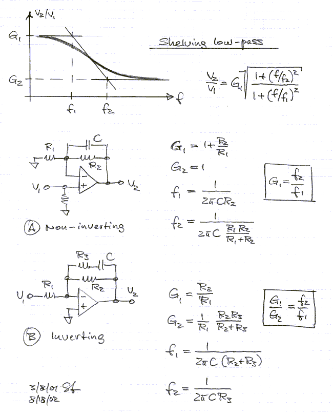

Can you explain a bit more about the shelving eq? On the LR website they give an example of a circuit, but no parameters for determining the cutoff point. Is this a fixed response, or is it determined by the driver and or x-over? If it is fixed, then the response after my x-over is almost entirely in the flat region of the eq response anyway. The notch would be needed at a much higher point than the example would indicate, somewhere around 2-3kHz instead of 700Hz as the LR website shows.
You are correct that the shelving network probably won’t be affecting the response up at 2-3kHz where your peak is. What I was suggesting is that if no shelving equalizing is used before your crossover, the overall spectral balance might be tilted upward rather than flat. This would make any peak in the 2-3kHz range even more audibly prominent. As Calvin said, just a little bit can make a big difference with ESLs.
In general shelving networks can easily be designed with whatever transition frequencies you need to properly equalize the dipole roll-off down to your crossover frequency. Attached is a design note pulled from the Linkwitz Active Filters page.
Active Filters
A link to an Excel spreadsheet is provided at the top of the Filters page that will help calculating circuit component values for your desired response.
http://www.linkwitzlab.com/Linkwitz Filter Circuits Tool V4.1.xls

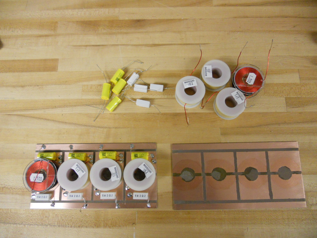

I think I finally solved the harsh response problem in my ESL panels, but part of the solution is still a mystery to me.
I was using Plitron toroidal step ups with a ratio of 75:1. I had used a pair of Hammond 60W output transformers on a previous design and they worked well (no harshness). I still had a pair of them laying around; with a 4K3 plate resistance it reduced the step up ratio to 32:1 but that only reduced the signal to the panels by ~6dB and I had plenty of head room on the amp. It seemed like the easiest thing to try, so I swapped out the Plitrons for the Hammonds which improved the harshness immensely; Any idea why this would make a difference?

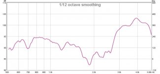

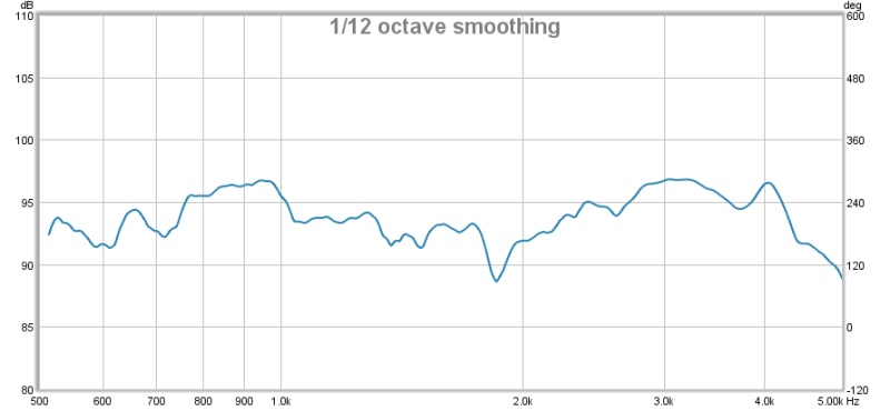

There was still some peaking at ~3kHz, although it was much more tolerable than before. I bought the REW mic/software from miniDSP and did some room measurements. There was definitely a peak between 2.5kHz and 5kHz (May 31 500-5K).

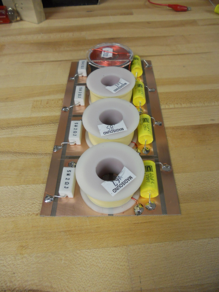

I simulated a 4 tap LC notch filter that should have flattened out the peak response. I prototyped the filter and connected it to the input of the step up xfmr; big difference. The harshness all but disappeared (very bright or harsh recordings still sound a bit shrill, but that's probably how they were recorded). The room measurement (Jun 9 500-5K) bore this out.
I constructed the filters on a piece of copper clad PCB which I routed with a trim router and flush cut bit. I'll continue with listening tests, but so far, it sounds as close to neutral as these speakers ever have.
