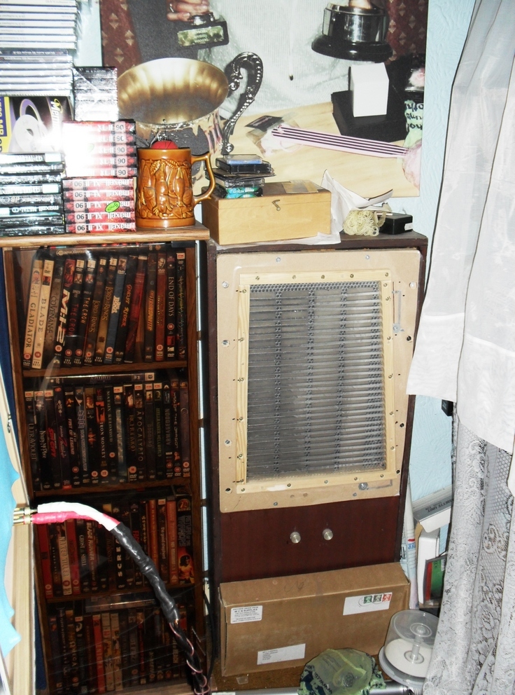

I have read up on transmission lines and was wondering if its possible to use an electrostatic panel in a transmission line?
I tried to google it but didnt find any information on this.
I was thinking of a design like this:
It will be roughly 30x30x140cm, placed on my desk 50cm away from my head.
The ESL panel will be 20x20cm
What are your opinions on this design?

>I have read up on transmission lines and was wondering if its possible to use an electrostatic panel in a transmission line?<
A: Yes, possible in principle and praxis, but it means just a lot of effort without appropriate yield.
>What are your opinions on this design?<
A: Lots of effort for inferior output compared to an openbaffle ESL.

I was thinking of using a transmission line because I don't have much space, so my speaker will be right up against a wall.
Are there any other methods to have an ESL near a wall without the out of phase signal being reflected?
And is this any better?
An ESL membrane has only a very small pk-pk excursion, so they are normally used in large panel sizes. Simply using a small ESL to replace the drive unit in a transmission line would not provide any advantages. The limited excursion would simply mean that your LF output would be very low.

The worst situation would be a parallel wall behind the speaker bouncing the backwaves back into the diaphragm. Another bad situation would be having a speaker in a corner where the backwaves do bank shots off the sidewall and backwall, sending early reflections to the listener. I'm thinking it's OK to have the speaker close to a wall provided the angle doesn't bounce sound back to the diaphragm and there are no adjacent walls close enough to bounce any early reflections to the listener. It's the early reflections that create phasing problems and muddle imaging; whereas, the brain tends to ignore the later arriving reflections.
I've also read that placing a curved reflector behind the speaker to disperse the backwaves can be effective in neutralizing the effects of too-close walls-- if it's positioned and angled just right.
I use a beam splitter behind my panels, which allows me to place the speakers very close to the back wall.. Still, I wouldn't place my speakers in a corner, for the reasons explained above.
Actually I have positioned my Acoustat 0ne plus 0nes directly int the room corners as tightly as the base would allow. It might seem counter intuitive but when you fire the panel into a corner there is no reflection back into the panel as it rear wave loads into the corner and shoots out along the side walls.
With the panel parallel to a flat wall yes lots of cancelation problems but not into a corner. Best regards Moray James.
