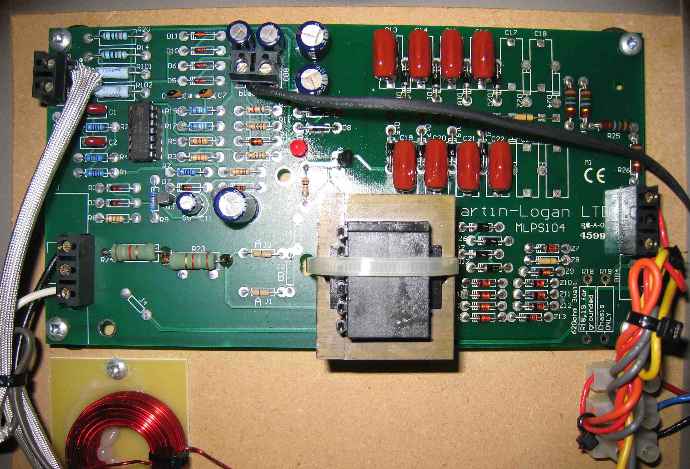

My Monoliths II are always powered and I have quite often to vacuum them. I would like to implement a tweak of the bias power supply in order to have it automatically switching on when music is applied to the speakers (and, of course, OFF after some time, say 10 minutes, after the music ended).
Any suggestion/schematic available?

Charlie's solution is simple and effective. I've used it for years
But, in case you want to try something a little more complicated and want it built into the speaker, you might check out Rod Elliots web page on the subject:
Signal Detecting Auto Power-On Unit
If you are feeling really ambitious, you could try copying the setup Martin Logan used on the SL3 (see attached schematic and pic).
Personally I think it is overly complicated, but it works. 😀

That's great! Thank you very much for the schematic and pictures!!!

Thanks for that schematic. It was the missing link in my collection...
