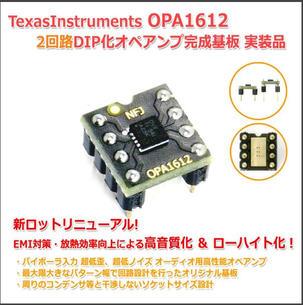

OK, this is odd...I just cleaned off the OPA1612 opamps that came with DAC to take a closer look at the chip - one of the two was now visible:
OVII
TI521
CK8T
Searching the internet, I see a Japanese website selling OPA1612 that reads similar... (TI541)
https://store.shopping.yahoo.co.jp/nfj/o524.html
It does not say OPA1612 like others seen on internet..... anyone have an idea if real?
A Texas Instruments OPA521 is a Line driver, so pretty sure its not an OPA521...

OPA1612 SON package has device marking OVII but your OPA1612 could still be a fake. Without measurements it is impossible to tell.

Other than price, I have no other indication of legitimacy. I will check the DC offset on both the OPA1612 and the LM4562....as recommended by Jean-Paul...
EDIT - Just checked DC offset wrt ground pin with Fluke 77
OPA1612 was 1mv (highest) and .5mv (lowest)
LM4562 was .5mv (highest) and 0mv (lowest)
