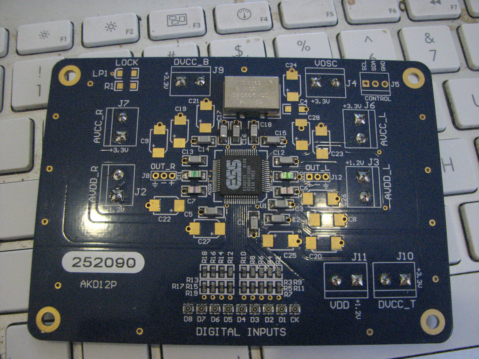

I'm a noname here, but I've been working on a DAC design over at diymobileaudio.com for a while now. Here's the link to the post where I described all the important design details: DIYMA Car Audio Forum - View Single Post - 2011 MINI Cooper CarPC Build
Here's a really quick summary:

Here's the schematic of the DAC PCB. I decided on the ESS9023P DAC chip because of the low-parts count, i.e. the KISS approach. Keep in mind that there will be five of these boards stacked on top of each other (for a total of 10 channels) to complete the final design.

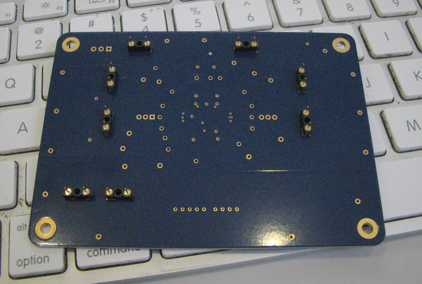

The bottom of the PCB is a solid ground plane. I've never really seen a DAC that managed to have this before. RF guys use this technique religously, but consumer electronics do not (ever). A solid ground plane does many things for a pcb layout: It acts as a faraday cage for stray EMI (in both directions, i.e. radiated and susceptibility). It provides a quick "return path" for high-speed RF signals (keep in mind that my I2S clock lines are ~24 MHz with VERY high rise times. Any upset here will cause EMI and worse yet, jitter problems. Lastly, the solid ground plane provides a very beefy ground system with extremely low resistance, so that every point on the pcb seems the same ground potential (same reason you guys use beefy ground wires on your amps 😎 ). The holes on the board are "vias", they're plated copper and pass the ground plane to the front side of the board (but you guys already knew that, right?? 😎 )
- J1 is the connector to the MiniDSP USBStreamer. Each board can be configured to route either of the four I2S streams to the chip, via R5-R8.
- J2 is the power header and mute circuit.
- J4 is the right RCA output.
- J5 is the left RCA output.
- IC1 is the DAC chip, the ESS ES9023P. It's specs are pretty good, but chip specs aren't as important as getting the board layout and component part selection right.
- IC2 is a 3.6V low-dropout ultra-low-noise voltage regulator. I love Linear Technology parts, but they think their **** doesn't stink and therefore have very high prices; I opted to use the Micrel MIC5205-3.6YM5 instead (as have a few other hobby DAC designs).
- SHIELD1 is an EMI shield (i.e. a faraday cage).
- FB1 is a ferrite bead, which is used as an input EMI filter to the power supply.
- You guys know what resistors and capacitors do hopefully, no need to explain those :laugh:

nice work mate! I really like it!; however you are far from the first dac designer on here or elsewhere to use a 'solid' ground plane.
Acko finished this design over 2 years ago and the previous gen (without the w.fl connectors and rogers teflon board) was before that. its all gnd plane underneath there, but has guides (kinda segmented but its all continuous if you know what I mean) to help keep loop area small. its an ES9012 dac. 100MHz clocks =) bulk polymers arent fitted on this one yet as you can see. the headers underneath are for stacking on the reg board
one thing, just wondering, you arent worried about the dacs at the top getting a signal thats been through the impedance ringer vs the bottom one? is each i2s signal paired with a ground pin on that super long header? do you have any type of buffer driving the dac outputs?

Thanks for the comments. The RF fences were from Digikey, I believe the manufacturer is Laird Technologies. Pretty cheap and easy to work with. I really don't think they're overkill, especially in an EMI-rich environment such as a new BMW-designed car.nice work mate! I really like it!; however you are far from the first dac designer on here or elsewhere to use a 'solid' ground plane.

As for the signal ringing on the I2S fanout, the distances are so small, I wasn't going to worry about it. I'm not an RF guy, if it does add measurable jitter, I can always snip the appropriate pins on the stackable headers to remove the stub(s). Each line has a series 20 ohm resistor at the DAC. Another mod I was going to make was a voltage divider for each signal with the divider voltage at the logic low-to-high transition point, which I've been told can reduce jitter. At this point, I'm still waiting to do a full set of measurements on a good spec an, and a formal listening test.

Can you please tell me what I2S signal buffer is used on the miniSTREAMER?
What was the reason for changing the original output LP Filter (4,7nF [F3:141kHz] -> 220Ohm + 2200pF [F3:157kHz?])? And what is the exact value of the ferite bead used to decouple power line?

Probably just the XMOS ASIC chip itself. I didn't want to use a crazy system of buffers, instead I used the KISS approach, payed great attention to board routing and high-speed layout, and kept the trace lengths very short.Can you please tell me what I2S signal buffer is used on the miniSTREAMER?
Because the ODAC used those values, I'm taking NwAvGuy's word since he's done more real-world testing than I'm able to. My project is non-commercial and I've credited him for a lot of my inspiration for this project, so I'm hoping he won't mind 🙂What was the reason for changing the original output LP Filter (4,7nF [F3:141kHz] -> 220Ohm + 2200pF [F3:157kHz?])? And what is the exact value of the ferrite bead used to decouple power line?
The ferrite bead is Digikey P/N 240-2399-1-ND, $0.07 USD. It has pretty generic specs, I selected it based off of availability and price.

You'll find them inside cell phones, radar detectors, GPS receivers, and any other device which needs a really low noise floor. You can buy them from Digikey, they're actually pretty cheap as long as you buy the super small ones like I did (custom ones will have a high non-recurring upfront cost for tooling and such). There are tons and tons of books and articles about EMI mitigation out there, I'm certainly not an expert but tried to use the "basics" in this design: solid ground plane on the bottom, liberal use of guard traces, lots of attention to routing for shortest trace lengths, using series resistors on the high-speed clock lines to prevent RF reflection, careful power supply design (e.g. "borrowing" proven designs already out there), and of course shielding the crap out of it. If you consider that most software radio transmitters have a final digital to analog stage (often called a DUC or digital upconverter), then you'll realize I'm not the first to try out these design techniques. But I may be the first to try it with an audiophile DAC, at least in the DIY community. Yea it might be overkill but what's the harm in that? 🙂
