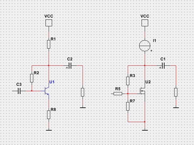

Hi All,
For some time now an acquaintance of mine has been using a single-ended class A amplifier - with much satisfaction as I understand him - although this amplifier topology has a rather steep distortion increase when playing loud(er). With this in mind he has asked me if something could be done to amend this high distortion level while maintaining the sound qualities that he finds this amplifier topology to have.
FYI I have attached a schematic of the amplifier circuitry as it overall looks today.
I have been considering something like boot strapping or a Sziklai output stage (right side schematic drawing), however, I wonder if there could be some kind of "error correction topology" (i.e. not global feedback) that would work for single-ended circuitries (and still sound excellent)?
In my thinking the main issue is the output stage where the distortion gets quite high even at moderate playback levels (please note here that I am aware that CCS'es could be substituted for the resistors R1, R2, R9 and thus improve distortion figures. In this context I would hope to find some "single ended error correction topology").
Might one/some of you have some insight into this that you could share?
Cheers & thanks for your inputs,
Jesper

Most likely, the 'sound" you enjoy is the "triode" distortion that happens in simple amplifiers with no feedback, and it comes part and parcel with power limitations. Note that the circuit on the left is also unlikely to center the bias without some fiddling, again producing even harmonic distortion but very limited output. A single ended class A amp is the worst of the worst for efficiency, and a push-pull class-A amp would be twice as efficient, actually more given that an active output could give twice as much output voltage (+6dB) instead of splitting the supply between the speaker and the pull-down resistor.
It is not insignificant that "single ended" amplifiers are popular with novices because they are difficult to destroy. An efficient amp is also one that can "blow up" in an instant. Building a "real amplifier" requires a lot of caution and patience, particularly with start-up testing.

Here are some examples showing local feedback from collector/output to base.
That is the R2 and R3.
R3 example shows the basic simplified ZEN amplifier by Nelson Pass. Using MOSFET.
Those resistors R2 and R3 at the same time bias the transistor.

The distortion when playing louder is clipping on the negative part of the waveform. The output needs more bias, and then it will run up against low efficiency.
The circuit is a poor power amplifier. Build one of the amplifiers on this site. They are all much better.

A Taylor or White scheme could improve linearity. You can go further and use this scheme: https://www.diyaudio.com/community/...nd-double-the-performance.184895/post-2500006
If you want to keep your inefficient resistor loading, you can get rid of Q2, 6, 7, 8 and just keep the error-correcting engine.
You can go overboard, and adopt UniGaBuf: https://www.diyaudio.com/community/...er-cut-out-to-be-a-leader.185501/post-2511348
In this example, a single diode (D2) is used for error correction:
Another possibility is to use the Tringlotron topology: https://www.diyaudio.com/community/...sed-tringlotron-amplifier.165131/post-2325621
The tringlotron has also been applied to chipamps: the chtringlunator: https://www.diyaudio.com/community/...-regulator-chip-amplifier.175827/post-2340491
Etc, etc.
...or a Sziklai output stage (right side schematic drawing)...
It's a video amplifier actually, well documented for years now - local feedback to unity gain, can have some gain too but as a SE main amp not most suitable.
It needs the buffer from the left side, at least.
If you need error correction, local or overall, amplification is needed before feedback can be applied. But there is a limited 'gain window'.

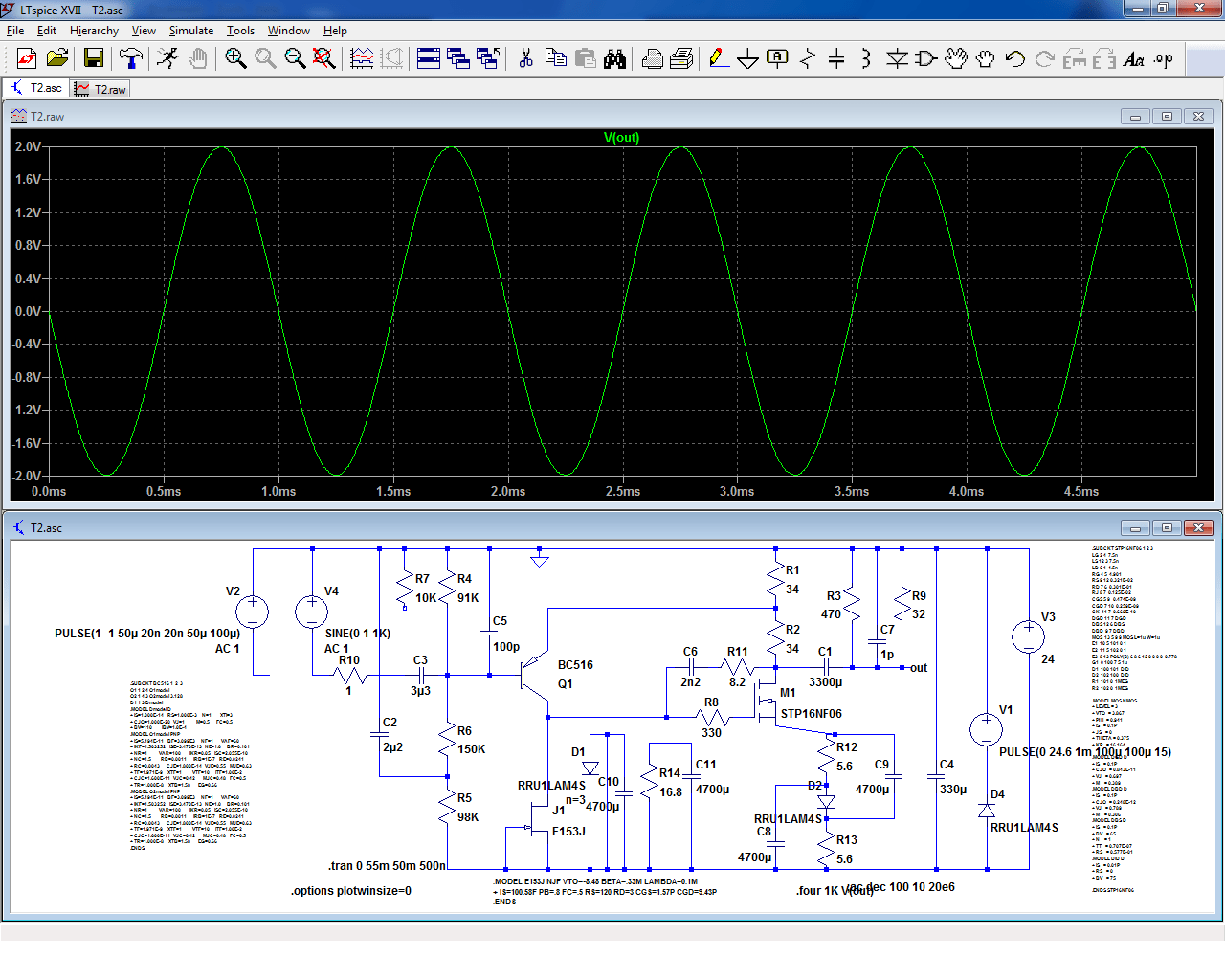

First again thanks for your feedbacks a little while back - they have been really inspiring ... and also slightly "scary" as I have come to realize that my familiarity with amplifier design "building blocks" is (too) limited, I think.
As it is the Kulish cell that @dreamth mentioned above has been the one I have mostly focused on because it appeared to offer a very significant reduction of distortion while at the same time being practical to work with. So I have made a good number of simulations with the Kulish structure and besides being quite discerning with the value of the R3 resistor it IMHO simulates remarkably well. 2H values of - 110 to - 125 dB for a 2-4 Vpp output signal with a 2-4 times amplification is not too difficult (though it takes some fiddling with values to find the best value for this R3).
However, when actually building and testing the circuitry I find that the distortion level typically is 15-20 dBs worse than the simulated result(s). Particularly surprising was the discrepancy between a 2N3819 (Q1) and 2SC3324 (Q2) combination which could not be adjusted to better than ~40 dB less than the simulated values (I used the LTSpice 2N3819 and Toshiba 2SC3324 models). For convenience here's a link to the Kulish cell structure:
https://www.diyaudio.com/community/threads/single-darlington-line-preamp.74861/page-3#post-858266
I reckon there can be some discrepancy between simulation FFTs and reality - but would you have any suggestions as to what would be reasonable expectations?
Also, I have this not-yet-materialized image in my head of a "3 transistor Kulish + Sziklai" structure that would give low-distortion amplification with a high input impedance and a low output impedance (which I personally think is one of the less optimal aspects of the Kulish structure, i.e. the highish output impedance of R3+R4) ... I have tried to simulate some possible ways of combining the Kulish with a Sziklai but not with a feasible result - might someone else here have had more constructive/similar thoughts in this direction?
