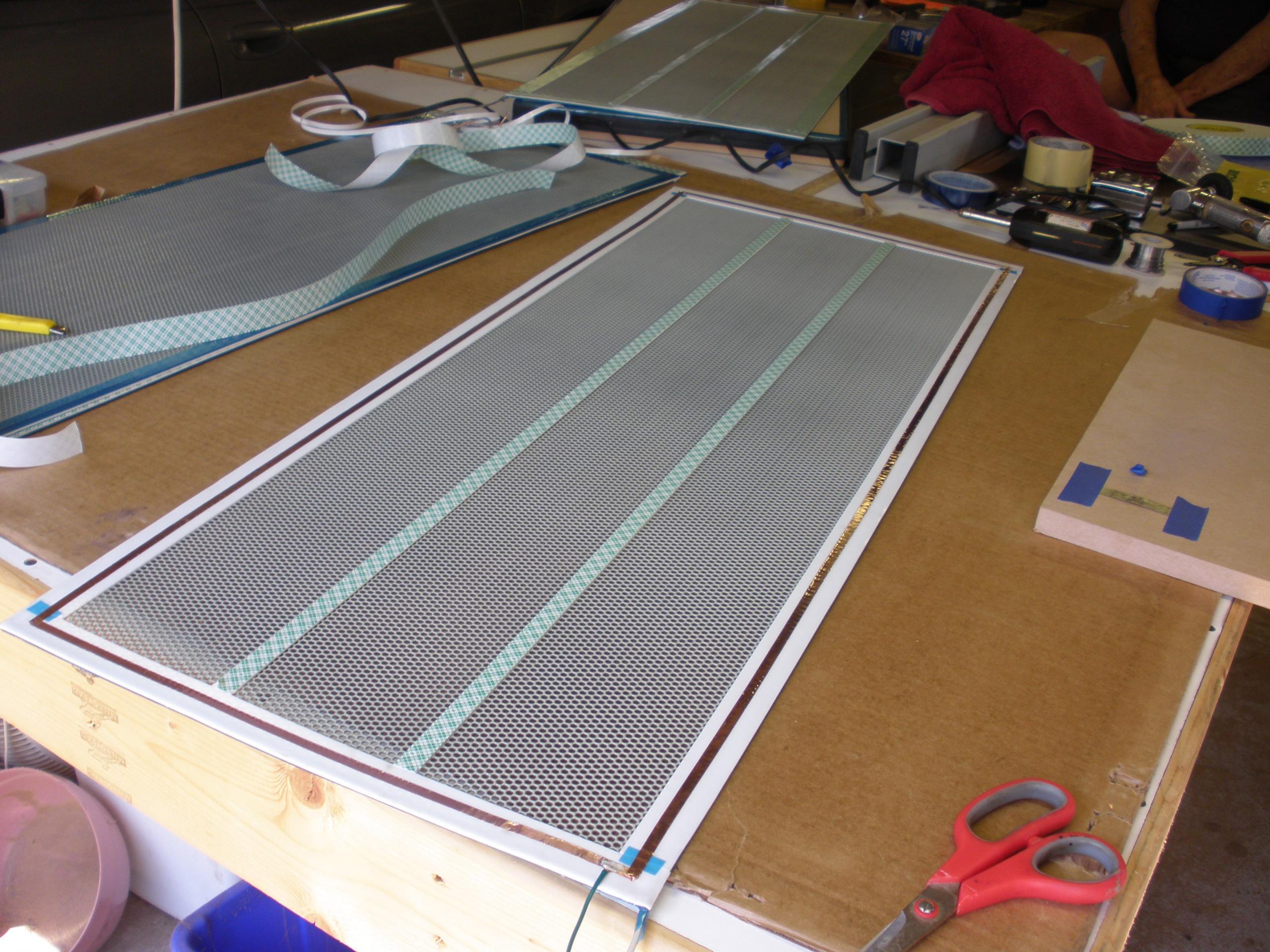

Thanks for your reply. I agree that there can be no absolute certainty without measuring the resistance. I will say that I verified power to the stators and the output from the HV supply. My money says the contact to the HV supply was also good but the coating wasn't conducting. Here's why I think so:
http://www.diyaudio.com/forums/atta...22853-different-ideas-esl-panels-p4040318.jpg
Rather than a single-point of contact between the diaphragm and HV supply, the diaphragms on both panels contact a copper foil periphery charging ring on all sides, so I think the likelihood of both panels having no contact to their HV supplies is virtually nil.
In any case, I think my bad experience in this case should make everyone wary of aged coating solutions, especially if their makeup isn't known.
