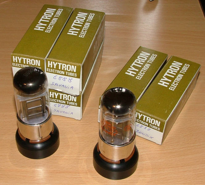

Apparently the E180F is a possible substitute. I have a few NOS 6888 at hand (Bendix and Sylvania). Same question as Giaime, why do you need them?

I am going to have them as the upper tube in a Mu follower found couple of schemas amd an articel on that,so its an old tube,well I need an octal pentode with 6,3v heater.E180F is 9pin🙁 Maybe you could sell me a couple of those 6888?
Why not, I don't have a direct use for them. I paid them 4,5€ a piece. If you want i can check about postage to Sweden?

Yes check the postage.Wat do you want for them each in $$$.you do have Paypal..🙂Why not, I don't have a direct use for them. I paid them 4,5€ a piece. If you want i can check about postage to Sweden?
