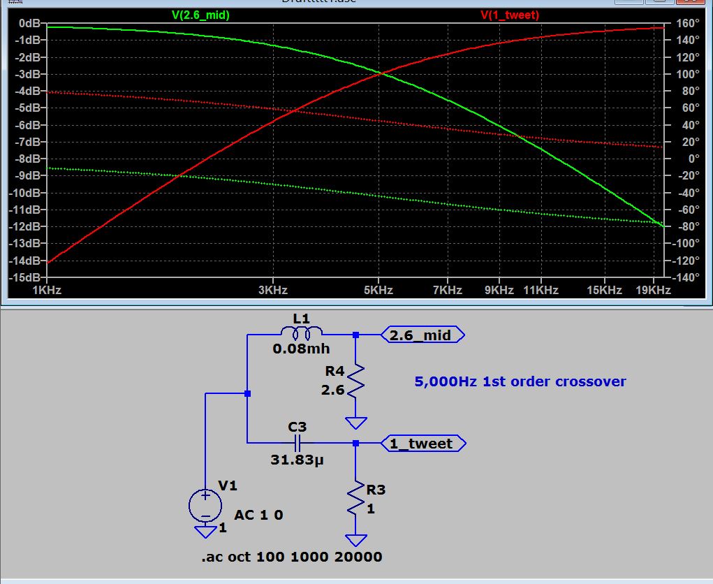

oh wait i have to add a resistor to ? i thought it would use the resistor of the panel itself. 🙁 to bad ive seen someone using this in there fullrange. but that was a drawing. im not sure if it ever worked properly. i want to divide my panel in a 2.6 ohm part and a 1 ohm part. and i would like to cut of the high frequency of the 2.6 ohm part, any pointers on how i could manage that without the normal coil. since that would not allow me to still put it in series
Is this what you want to do? Panel crossover
The HF load is only 1R, so it's a pretty bad amp load.
You can use LTSpice with the R-L-C measurements on your panels. For the crossovers, you will need to hand-build the low inductance value, low resistance inductors using a good quality LRC meter.
When you use a microphone to measure SPL and phase vs. frequency of your prototype speaker you can switch to XSIM and also include baffle and room effects.
yes this is the setup. so up to 5khz it would see 3.6 ohm and above 1 ? ohm ?
The thing is the panel will be bigger so these numbers are just for ilustration 1 Ohm is not very high 🙂 but i tried this setup and t somehow the drop is not there 🙁 i should recheck if im not doing something wrong.
yes this is a normal crossover, problem is the tweeter wont contribute in the low end this way. 🙁 i would like to create a setup like in an esl that only parts are filtered with a lowpass and one part is playing fullrange, all in series would be ideal. else i might use only one coil to filter. and put one part fullrange parallel before the coil. if the impdance is high enough it is doable.
The time constant is set by the two resistors in parallel.
So then f = 1 / [2Pi x Rp x C] where Rp = R1 x R2/[R1 plus R2]
