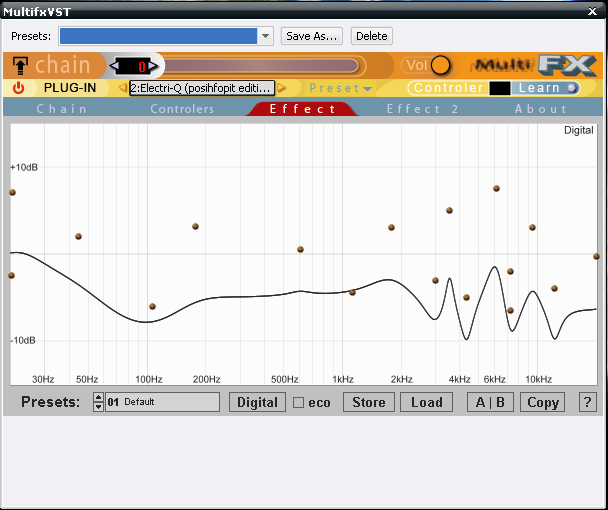

For example, here's the crazy complicated nasty looking EQ curve I've been applying to my headphone setup for the last several months.. a pair of old Sennheiser HD-497's to a Presonus Central Station. Can't tell the difference between these and HD-600's now..

BHTX said:For example, here's the crazy complicated nasty looking EQ curve I've been applying to my headphone setup for the last several months.. a pair of old Sennheiser HD-497's to a Presonus Central Station. Can't tell the difference between these and HD-600's now..
How did you go about choosing this EQ curve?

I used a combination of the signal generator in WinISD Pro (with "Get frequency from cursor" selected), a couple hundred sine wave test tone mp3's (to compare my changes), pink noise, and various other things.. carefully listening and tweaking off and on over a period of weeks.. until freq response to my ears seemed perfectly flat from 20 Hz - 20 KHz (ok, well more like 14-16 KHz, since that's as high as I can hear). Simply finding the most problematic areas with a signal gen and then using dozens of sine wave mp3's in foobar, going from bottom to top / top to bottom, and listening closely to make it flat got REALLY good results within the first couple of hours. All the rest was just minor tweaking here and there. Also, keep in mind that the EQ curve I posted above is using the nasty analog output of this old piece of trash onboard sound card. It's seriously one of the noisiest cards I've ever heard in my life. I believe it causes a bit of a boost around 100Hz too, among other things, which was obviously removed as well.
BHTX said:...... carefully listening and tweaking off and on over a period of weeks.. until freq response to my ears seemed perfectly flat from 20 Hz - 20 KHz (ok, well more like 14-16 KHz, since that's as high as I can hear). ....

tnargs said:If I understand, you used a subjective measurement technique. That is very interesting. It assumes that human hearing inherently hears equal sound pressure as equal loudness, regardless of frequency.
I thought the Fletcher-Munson curve demonstrated a different assumption is needed?
Yes, and of course I thought of all this beforehand. However, I went ahead and tried it this way, and ended up with good results. Remember, I'm talking about headphones here, not loudspeakers in a room. What's "flat" for headphones? There have been studies done in the past, but headphones still seem to remain an "art form" themselves. Show me what a "flat" curve for headphones to the average person's ear might look like, and I'll be happy to try it. It's not so easy though, because I also have to take into account the severely screwed up curve that these headphones already have (see below). They were always pretty rough in the upper mids, couldn't stand them.. but now, I can't tell the difference between these $50 cans from 5 years ago and a new pair of $300+ headphones. Actually, mine sound A LOT better, to be honest.

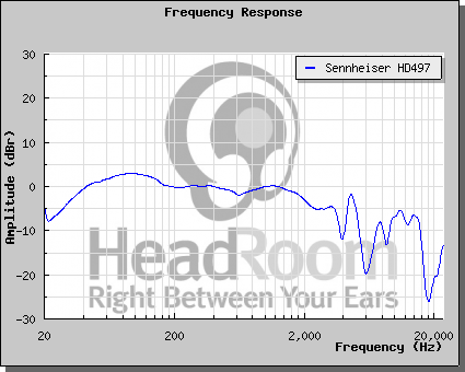

Sennheiser HD497 freq response:
But, wouldn't it stand to reason that if you applied the same EQing technique to the $300+ headphones that they would improve as well? I'm not saying apply the same EQ curve but rather develop a new EQ curve for them the same way you did for the $50 headphones.
That's an interesting question. I would guess the answer is yes, it would sound better. But if frequency responses are the same why would one pair of headphones or speakers sound different? If a $25 paper cone woofer was equalized to have the same frequency response as a $300 kevlar woofer how and why would they sound different?

It's not only freq. response - phase response and cone stiffness (so it doesn't "break-up" and ring like a church bell on some freq.-s) are even more important. Also distortion, but the amount of it (according to Gedlee) apparently is not THAT important, rather the type and order of it (a rather complicated topic, has a lot to do with psychoacoustics).
