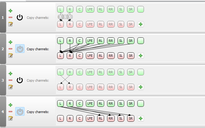

Mine looks like this, I add all of them at unity gain since they probably never all play at max volume,so clipping never occurs,and I don't lose any volume,the ones with black buttons are disabled and serve the purpose of mono summing and swapping the speakers around,but are only for testing purposes,Then I send the LR downmix to the outputs I actually use with the actual eq not shown
MUP there is a virtual channel which holds the mix of L and R channels. 0.5 as a multiplier there in command means just that you lower the channel volume level 50% so you have 50% of the left and 50% of the right channel stored in MUX channel (which is then copied to SUB channel). Same with the other multipliers used there in commands (how much of the channel you want to include to new channel). Here are down-mix tables: https://www.audiokinetic.com/en/library/edge/?source=Help&id=downmix_tables
If you use L=1*L+1*C+1*SUB+1*RL+1*SL your total output level for channel L is sum of all summed channels and this usually goes above 1 which leads to situations where Windows build-in limiter jumps in (which is bad situation).
IIRC, there are lots of examples @ EqualizerAPO support discussions.
