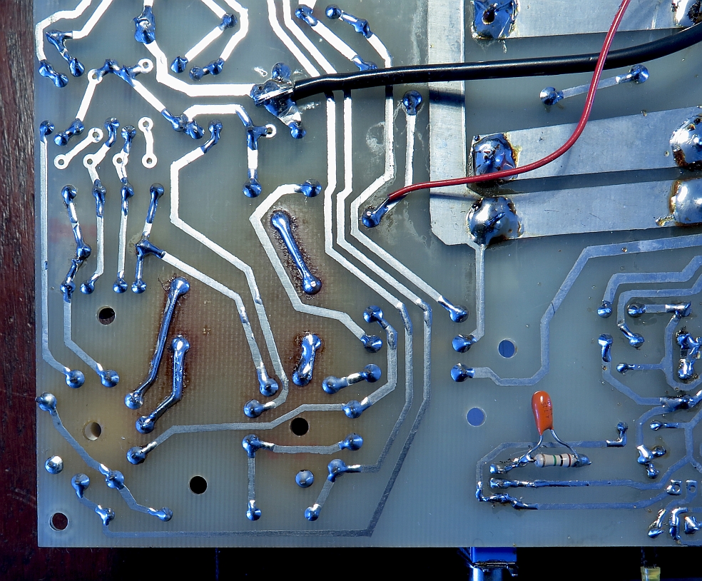

I'm on the hunt for schematics for years now, not been able to succeed and if we ever find one then the question raises whether it will be acc. to the schematics as the way its been build it looks like a experiment...

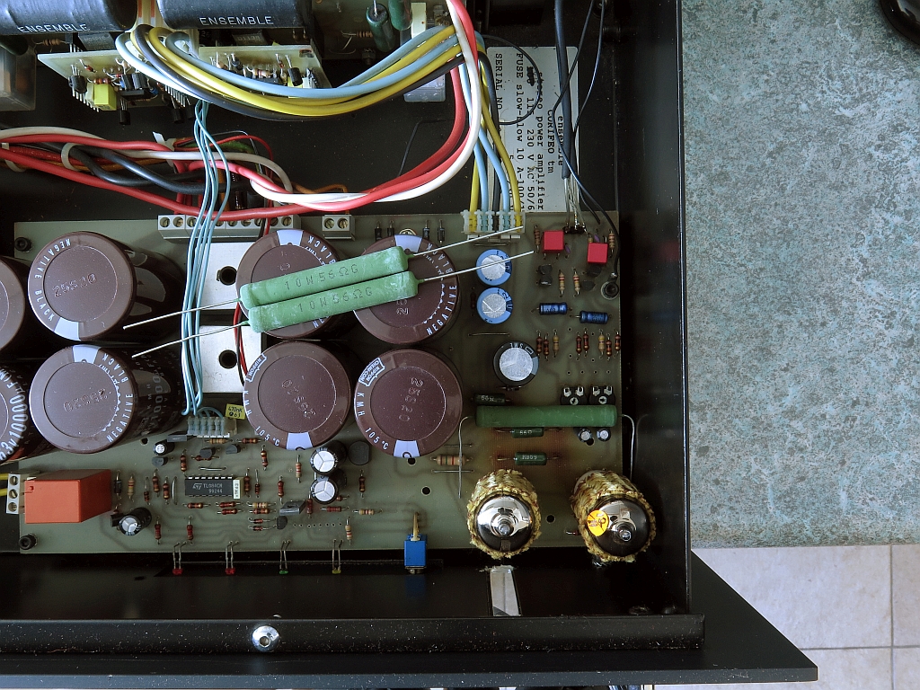

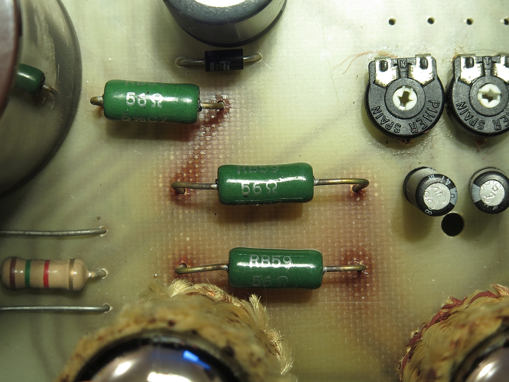

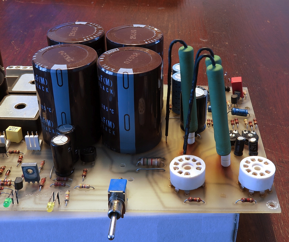

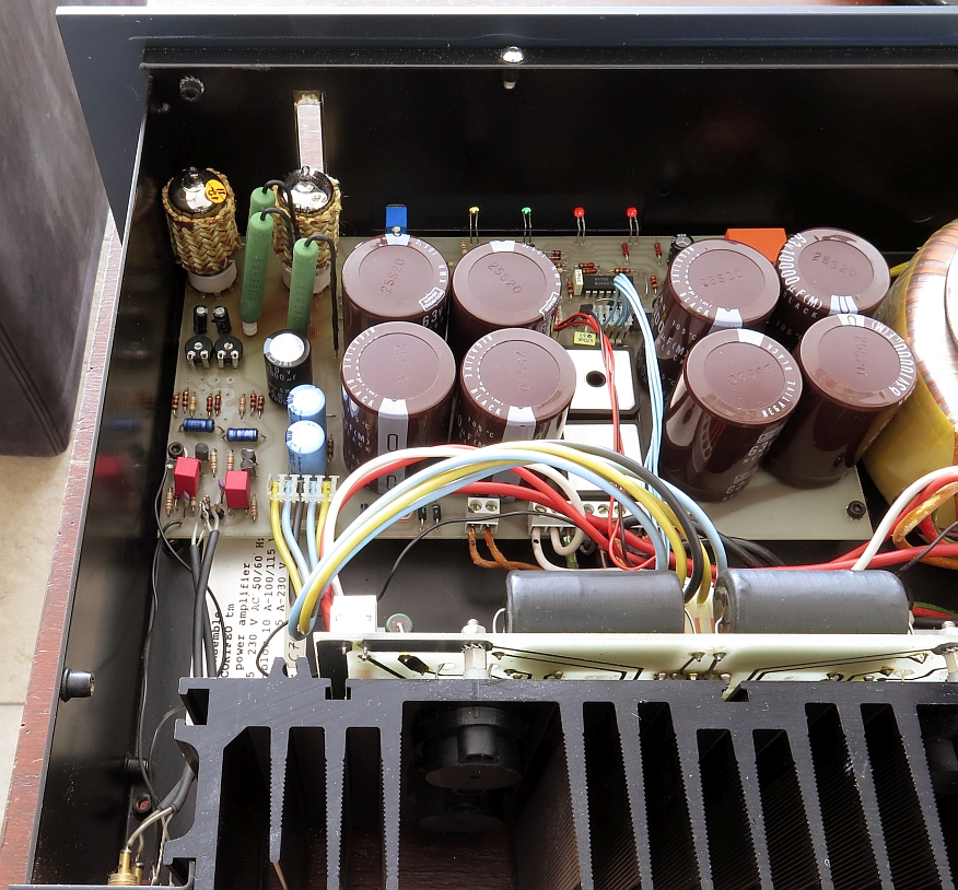

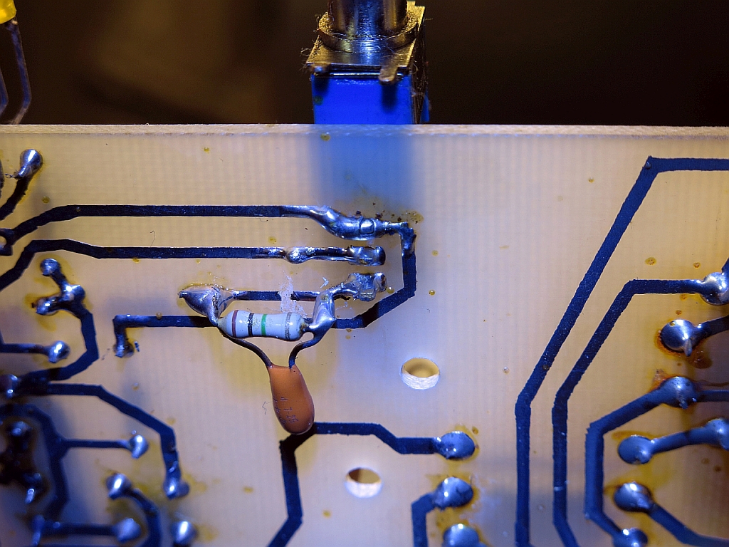

I had 3 resistors replaced (same value but 10W now) near the tubes as the originals where a bit too close to the (crappy) PCB and left burn marks over the years...
On top of that I had loads of bad solder joints on the PCB of both Pre and Power amp
