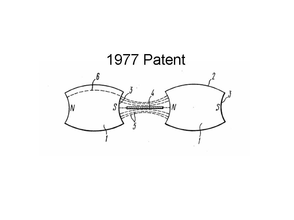

The RAAL ribbon website technology section describes EQUAFIELD as a breakthrough in homogenous magnetic field across the gap. Is this just hype-speak, or some good engineering improvements on the tradition pole piece design? Any ideas on how to model EQUAFIELD?
"EQUAFIELD® technology: The magnetic field in RAAL ribbons is homogenous. Regarding the width of the gap, it is designed to have the same strength at the ribbon edges, as well as at the ribbon middle portion. It reduces the stress at the ribbon foil dramatically. The distortion, too. To get the precisely shaped field, through the gap width and depth, we’ve extensively used the FEM and BEM magnetic circuits analysis software. In order to obtain such a field in real magnetic circuit, very strong NdFeB magnets have been precisely machined, prior to magnetisation, in very special shape. Making the magnetic field homogenous, sacrifices the strength of it, but efficiency should easily be changed for low stress and low linear and nonlinear distortion."
