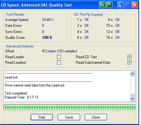

Recent LiteOn combo drives have faulty DAE
I was skeptical about possibly bad CD copies until last week. I bought a LiteOn 5235K combo drive for my new machine because I had good experience with LiteOn in the past. I started noticing problems after following the instructions for ripping with EAC here:
http://home-12.tiscali-business.nl/~tpm54044/
I used the EAC option "Action, Test & copy selected tracks", which does a test run on each track, computing the CRC code for the test extraction and the actual, and printing the results to a file. Secure mode was used. I've pasted in my results below. Note that it says "No errors occurred" despite the fact that four tracks show CRC mismatches!
While trying to track this down, I found this test report on a similar LiteOn combo drive that showed errors in the Nero advanced audio extraction random read test.
http://www.cdrinfo.com/Sections/Reviews/Specific.aspx?ArticleId=8997&PageId=6
Notice the large number of errors just below the first bar graph in the report. This test can be run if you have the full-up Nero. Run the "Nero CD-DVD speed" application (CDSpeed.exe). Choose Extra, Advanced DAE Quality Test, Create Test CD and burn the test CD. Then choose Extra, Advanced DAE Quality Test, Run Test to run the test. My test results are shown below the EAC extraction report. Notice there's lots of read errors too (851875 of them!).
I then did a rip of the same CD about five times with a different drive, my LiteOn DVD burner. It got perfect CRC matches every time. After that, I ran the Nero Advanced DAE Quality Test on the DVD burner. It showed zero errors in both sequential and random reads.
I conclude the following:
1) Failure in the Nero Advanced DAE Quality Tests correlates with mismatched CRC codes when ripping with EAC using the test and verify method, even if the secure mode of EAC is used.
2) EAC will still say "No Errors Occurred" even when CRC mismatches exist and even when secure mode is used.
I ended up getting a new combo drive, a slightly more recent version of the drive reviewed here:
http://www.cdrinfo.com/Sections/Reviews/Specific.aspx?ArticleId=9565]
These cost $33.50 from newegg, and pass level 5 of the CD-Check Test Disc, so they should be very good for recovering badly scratched CDs.
I rip to disk with the EAC "Test & copy selected tracks", and manually compare the CRC codes. Then I create an audio CD compilation with Nero. I select all tracks but the first, choose "Properties" and set the "Pause" value to zero to prevent Nero from inserting silence where it doesn't belong. Then I burn the CD.

Nero Advanced DAE test results
Random Read Test
Average Access Time: 122 ms
Data errors: 851875
Sync errors: 0
Total Data Errors: 851875
Total Sync Errors: 0
Quality Score: 75.0

andy_c
i think that combo is a bad drive , all combos are bad! 🙂
here is my result with RICOH CD-R/RW MP7240A V2.08
