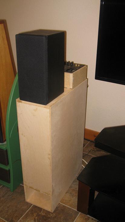

FWIW, I built a pair of these Anarchy TH's, and after a little domestication, I'm happy with how well they work in my system. Attached is a picture of one. Sitting on top is a bookshelf speaker and a plate amp.
I used a minidsp as a low pass, cutting off the wild peaks above 100 hz or so. Each one is powered by its own class D plate amp, with variable gain, phase, and crossover freq.
Good luck on your variation. 🙂

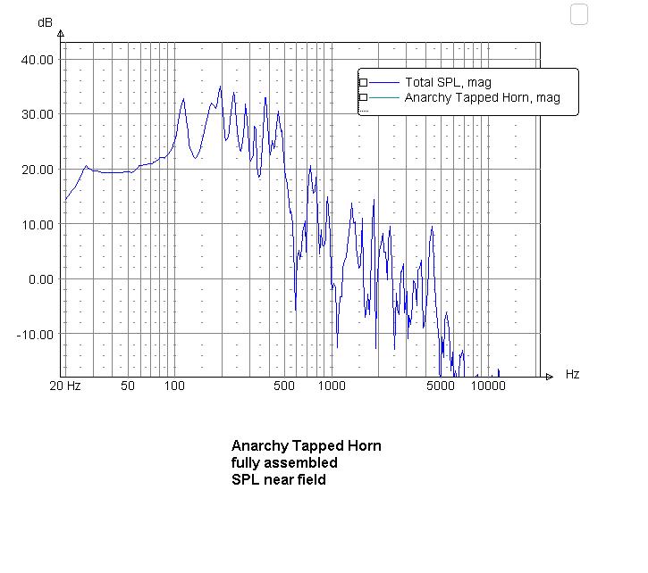

Here are a couple of shots of actual (near field) measurements for my Anarchy TH's.
The raw (un-filtered) measurement shows the huge swings above 100 Hz.

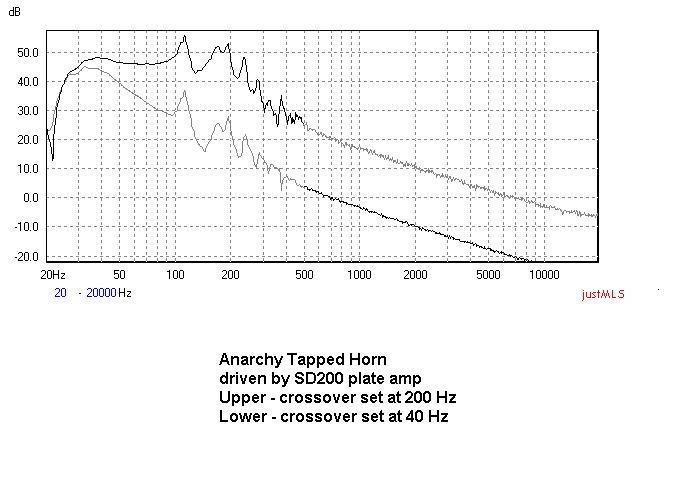

The next shot shows the measurements with the plate amp set at min and max crossover frequency settings (40 hz and 200 hz). Closer to what would be usable, but the nasty peaks above 100 hz were still audible.
That's when I decided to add the minidsp as a low pass, with 48 dB/octave rolloff. Took a lot to tame it, but now the bass is clean, and more enjoyable. 🙂
(sorry, but I never made a measurement with the minisdp in the equation.)
Moral of my story is that the hopelessness at the outset was only temporary.
Sounds like the 70 hz peak in your model is different than what I measured on my system. You might run through the thread with the hornresp file and see if there were any updates or refinements. Also, see Brian Steele's comments above regarding the syntax.
