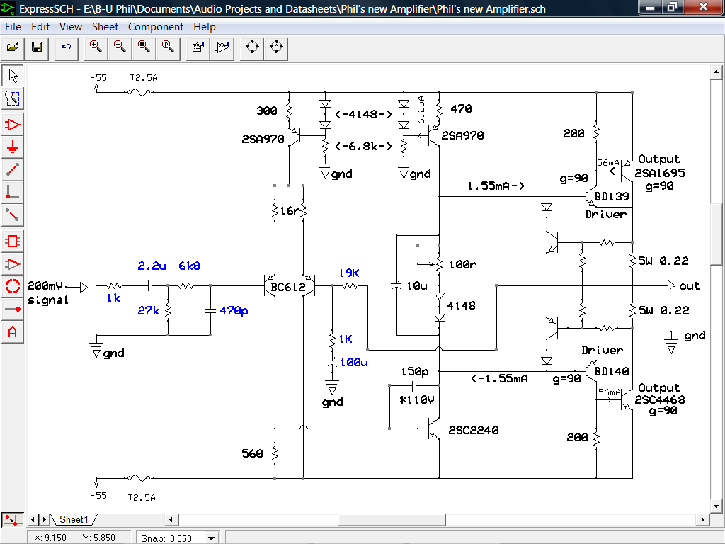

Hello again from down south - Tasmania.
I have a very complicated problem concerning negative feedback for a circuit that I have borrowed from one of the British Universities. I don't have a lot of money to spend on expensive Zetex transistors or special transformers but have two 200va 80V centretapped toroids and a heap of salvaged trannies as shown in the diagram.
I am not a lazy man, - I have tried to understand pol and db and all the rest - but it is wearing me down and without help I will continue to struggle, or, even worse, GIVE UP.
I don't actually need an explanation of how to calculate these values because It has been explained to me before. I just dont have the time to research such a complicated issue, nor the capacity (at this stage) to understand it.
Can someone calculate the values for me?
Values for the components that are highlighted in blue. (think its blue, I'm colour-blind too!)
I am hoping that someone out there with a bit of practical experience (tradesman or engineer perhaps?) might be able to do it 'easier' than I can't do. If that makes sense.

Thanks Nigel. That circuit was developed by The university of Sheffield back in 2003. I chose it because it was simple and well explained in the accompanying circuit description. Now I know what a differential amplifier is and where the voltage amplification stage is. My next task is to look up some information (www) on input filter design, I have built a few speaker x'overs, but I use coils & caps, not resistors & caps.

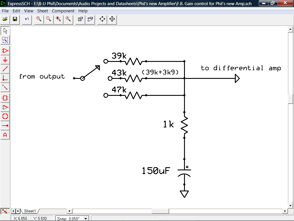

Thanks again. I was on the verge of putting 4 dip switches or a rotary sw. and four resistors in that gap! Is it worth trying 39, 43 & 47 in this manner? A nagging voice is telling me I'm over thinking this problem. Would the circuit below be unnecessary clutter? Not to mention the risk of an accidental open feedback loop - all contacts open.
The following circuit might work;

I agree with Nigel, it looks pretty good.
Though, I believe 47k is a bit high. The gain of the amp is the ratio of that R to the 1k, so if you use 47k, you get 47 x gain.
Most power amps have around 30 x gain, and a 27k or 33k resistor is better IMHO.
With the 47k you might have to turn your volume control all the way down and that doesn't have a comfortable 'feel'.

Hi there Jan, nice to meet you. It's a very good suggestion. I know very little about this kind of thing, but a little voice told me to put a mini 1P3T-on-on-on switch with 39, 43 & 47 but with Nigel's permission I could make it 27, 30 & 33 then I can try each setting and see how it goes. It really won't take up too much room on the board & I haven't even drawn the pcb yet.
I too like to be able to turn the volume pot up to at-least the 10 o'clock position.
You can take a look at the .gif above if you like, it's pretty boring really but it shows how I would wire the resistors with the pcb switch.

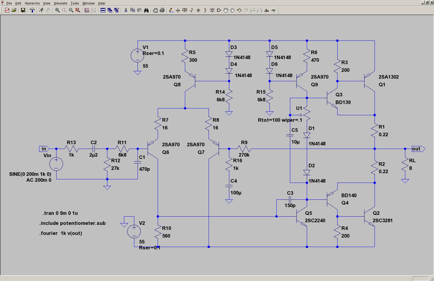

Input resistor between B and GND and feedback resistor needs to be the same value, otherwise the amp will have big dc offset.

I should have spotted that but I use a resistor in each leg of the LTP.
i.e. one 560r and the other a 1k pot to balance out the LTP and so fix the dc offset.

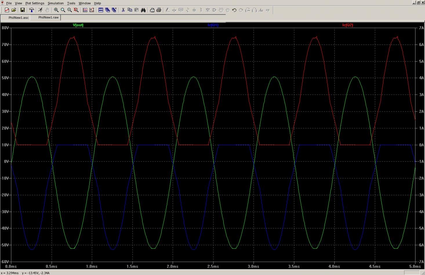

I had a go at this circuit with LTspice IV. Spice models for the 2SC4468 and 2SA1695 are not available. The BC612 is another unknown - I can't even google up a datasheet for it. I therefore made a few substitutions. For the BC212 I used the 2SA970 simply because they are already used. For the output I took the tried and trusted 2SA1302 and 2SC3281.
To get the output to swing anywhere near the substantial 55V rails on only 200mV of input, the feedback resistor had to be increased by an order of magnitude. The DC offset is significant at -540mV.
The use of diodes for biasing might have suited the original output devices, but for my substitutes there is not enough control to keep them out of class AB (with all the problems that arises from that). The THD at 1kHz is 0.27% - not bad but not inspiring either.
I will substitute a Vbe multiplier for the diodes and report back. It might also be worth the effort to try a few other complementary pairs.

Reduce 270K to 27K and add a opamp gain stage if you really need that much gain.
Having alot of gain in the poweramp itself is a recipe for disaster.

high gain reduces feedback and that in turn increases the stability margins of the amplifier.
A lower gain amplifier needs more compensation to avoid instability.

OK, see if I got it right.
The series resistor in the feedback line needs to be 33k?
The 27k ground reference in the input filters needs to match this, and therefore is 33k too?
NEXT Question; Can I improve the THD by REDUCING the gain, OR any other means?
NOTE; it is not imperative for me to get a huge amount of power out of this amp, even if I could get 70 clean watts I'd be happy.

NEXT Question: Reducing Gain will improve THD a bit.
So it is good if you ask yourself how much gain you need.
And select no more gain than this.
The source has got a certain high level.
You select a poweramp gain that will give max output from power to speaker.

Yes the resistor between input and ground needs to match the feedback resistor.
