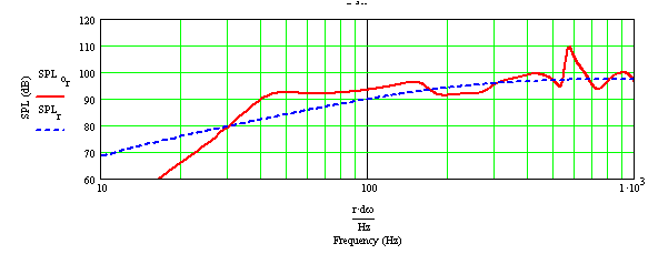

FE206ES-R in ML-TL
Well I have some FE207E's in an ML-TL which I like a lot.
However I also have some FE206ES-R's waiting for me to build a cabinet. I was thinking about putting them into the ML-TL this weekend - and tweaking the BSC circuit a bit.
One concern is that I don't think the mounting holes are going to line up - and I would hate to bugger the ML-TL's just because I'm anxious to put the ES-R's to work.
I've been following the various conversations on these drivers across the full range forums - and really the design I want to try is the k-slot loaded horn design of RCA-Fans from the audio asylum. Just because they look so d**m good - and relatively simple to build.
Steve in Vancouver

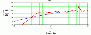

The sim I did on the first page was for a 206ES-R double horn, of the large CC, short path-length type (think double Replikon). Just a different approach really. I quite like them. I'm currently fooling around with one for the FE126E as well, which I might actually have to build -the sims look pretty good so far.
