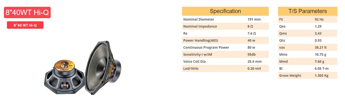

I am using the formula 15 x Vas x (Qts^2.87) to calculate volume for bass reflex enclosure for the attached full range driver.
Vas = 38.21 L
Qts = 0.93
I am getting a volume of 465 L which is very very large.

That driver won't make any bass. The fs is too high, even in 500l the -3dB point is at 77Hz. I see 3 options to use this driver:
1. Open baffle. It still needs bass support.
2. 50l sealed with a highpass-capacitor (likely ~300-400µF) which interacts with the impedance and draws it flat at the bottom, around 110Hz f3. The C acts as a low cut too, you only have to add a Subwoofer and no other electronics in the path of the fr speaker.
3. A TQWT could maaaybe work but the driver won't make much bass because it got a very limited linear excursion (< 1 mm) and won't go very deep either because of the too high fs.
4. 30l sealed or OB + subwoofer and dsp, wich can easily cross it over and eq it flat at the bottom.
You'll most likely have to eq the fr driver on the upper range anyway which means you'll need one or several filters. That means NO. 4 is the most promising solution because you have the speaker directly on the amp and the least losses and - as already said - the driver needs EQing in some way.
If you didn't buy it yet, you'd better look for other drivers if you want a pure fr speaker. If you did, I'd go for OB + Sub + DSP (miniDSP is a good choice).

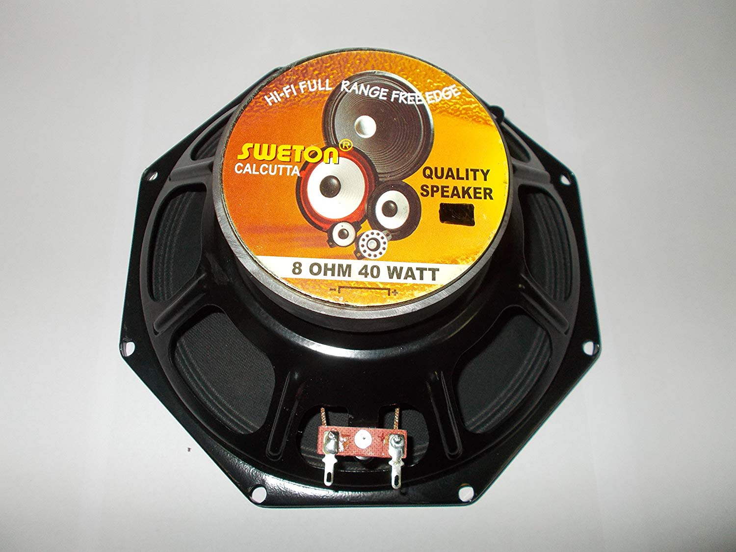

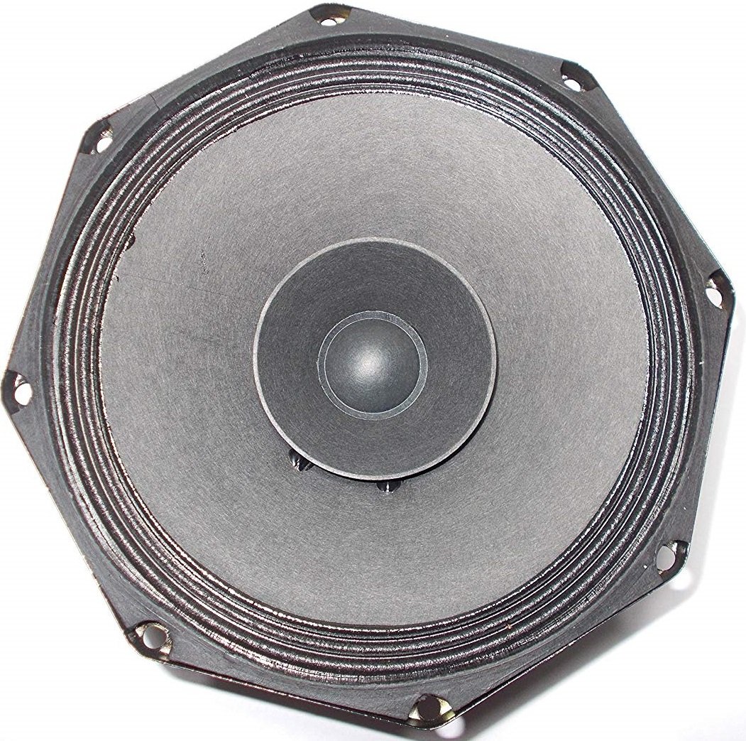

You are right, the octagon basket and even the membrane and whizzer look very faimiliar to the Philips AD97xx or other philips models. However, the cone and whizzer looks coated and that's not promising for a Philips fr clone.
The fullrange driver is from Sweton Speakers, India. The cone and whizzer aren't coated, the sourround is. They are available from Amazon India for ~15 bucks. They extremely likely couldn't implement a pole core copper cap to fight the impedance rise, especally for that price. They will not sound like the old Philips.
For that price you can't do anything wrong either, for an OB experiment with subwoofer it's probably worth it.

Philips stopped producing these FR drivers in the end of the 1980s, nobody wanted FR anymore. The most drivers after that were either off the shelves of other manufacturers or ordered after specifications. A lot if not most of the speaker companies do that to cover the lower price end even if they produce drivers themselves. The same for Boston, they buy the cheap ones. On the photo I've posted you can clearly see at the coating of the surround and also the gasket are done per hand, automated production does not have these tolerances. Boston started around 2000 with automated production, developed the machines and put them in factories in low paying countries for production. I'm very sure the Boston 8" FR came from Sweton.

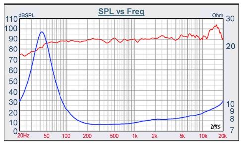

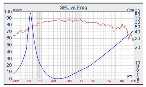

Anyway, I can't imagine they would use a copper cap because it needs surprisingly high precision production with very low tolerances (stamp/press) at a critical place (voice coil, pole core) and includes a lot more production parts, assembly lines and assembly time and logistics in the process and doubles (or more) the worktime per unit. Maybe I'm wrong but I did not find any mention of the copper cap being used either.
You don't have to rip one driver apart to check it, just measuring the impedance tells if a inductance control is in place. If there is no impedance control, the measurement above the fs resembles a kinda more or less long 'u'-shape, if one is in place, the lower part is mostly flat or rises slowly in a slight slope and starts to rise faster only at the upper end.
To compare drivers in this regard is often difficult because every company measures and (most important) scale the impedance plot vastly different from others.
Here two examples, I think everyone can now tell which is which 😉

(Both measurements from Tang Band drivers but still very different scaling. Doesn't matter in this case because it just has to show the typical behaviour.)

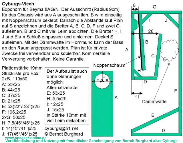

I may have a good suggestion. The Beyma 8 AGN is an affordable stiff fullranger with high fs and a qts of 1,15.
A very popular and simple horn was designed for it, the Viech (beast in German). If you google Beyma Viech you will find many photos of builds. I made it for a friend, quite amazing for the low price. It gives dry punchy bass up to 60hz or so.
Hence why not try making it with cheap panels? Is not difficult to make.
Important, the designer later removed the damping material at the back of the box and replaced it with a tight roll of damping materian just helow the driver, to filter out the high frequencies better. That is how i made it.
