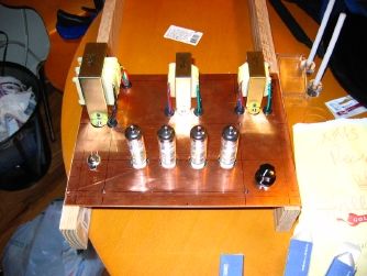

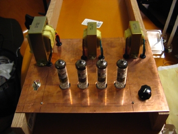

Very Very Slowly making progress...
Well, I test fit some stuff today. I'm slowing making progress... hopefully I'll make the frame (from those oak boards it's sitting on) this weekend.
The input jacks are in the mail. They will be mounted in between the volume knob and the output transformer behind it.
You really should consider turning that power transformer by 90 degrees, otherwise there is a chance of hum pick up by the output transformer(s).
dhaen said:You really should consider turning that power transformer by 90 degrees, otherwise there is a chance of hum pick up by the output transformer(s).
hmm... I'll keep that in mind. Holes are already drilled, so I'm gonna try it out as is, and if I have problems I'll look to that as a possible solution. Maybe I can just but a shield over the power transformer?
also, I though that here: http://www.siteswithstyle.com/VoltSecond/K-12M_AMP/K-12M_Push_Pull.html he found that the 90 deg orientation was actually worse. I'm VERY new to all this, so maybe I'm misunderstanding what he was testing.
Hmm, his pickup doesn't look like straight magnetic induction. I think he has all sorts of problems due to layout. In any case his orientation is the exception to the rule. Hopefully you have a chassis plate between the transformers and the other circuitry that will make things more normal.he found that the 90 deg orientation was actually worse.
