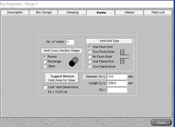

So got myself a pair of 2 x RCF MB12N351 and have been building 2 vented box for them. But since I get rattling noise (goddamn PVC port) and limited SPL, I would now like to improve their efficiency and so on build something new. Their aimed frequency range use is from 40/50Hz to 1/1.5Khz. Some questions to direct me in the best path :

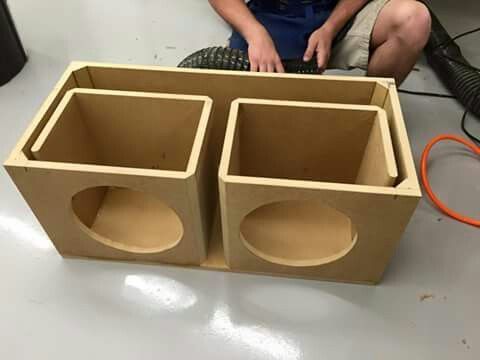

2b - Any more classic (wood based only) ported design I could adapt ? I was thinking of simple designs like this one :

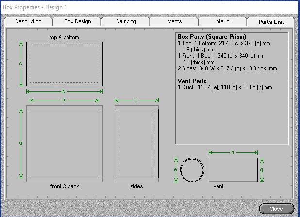

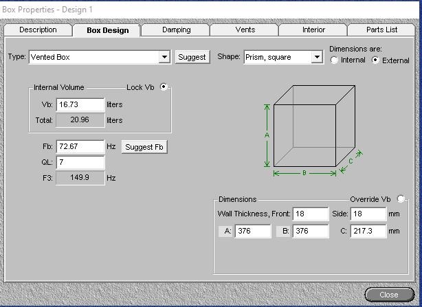

- Here are the vented enclosures (the two at the bottom) I have built already via BassBox + their specs:

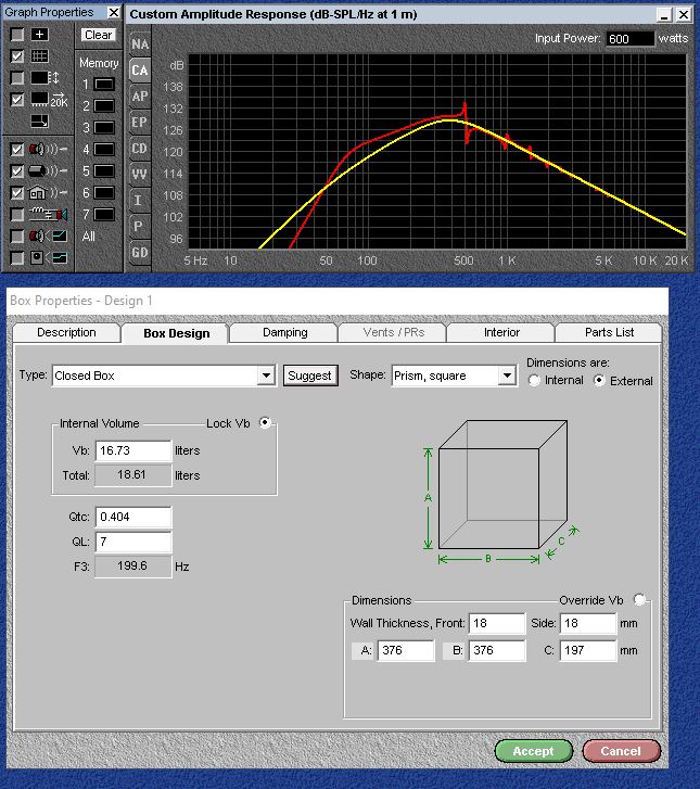

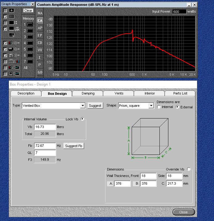

I think you're trying to get too much out of them... I'd say use them in sealed boxes for midrange only, say 150 - 1500 Hz. With such a low Qt (.2), in a vented box they're only going to be usable in a EBS alignment, so the low end will always be dropping off anyway.
Thanks for the input Pete, I haven't thought about that and it would clearly makes the enclosures lighter. I'm also not loosing too much DBs compared to the vented version ( 2.55DB of difference maximum at 150Hz)

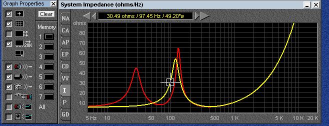

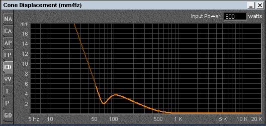

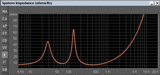

Here are the sims ( I just read your signature so added the impedance ones too 😛
RED = vented / YELLOW = closed

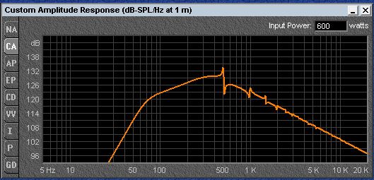

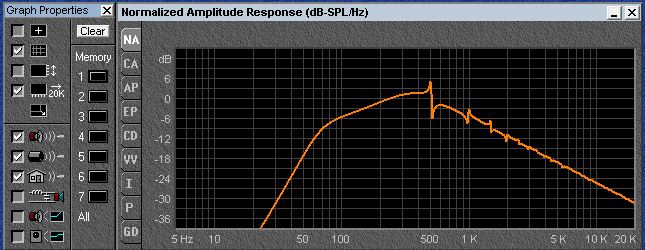

Alright thanks for that GM, any help how I could sim-compare ?
THAM12 vs Sealed BOX
Driver : RCF MB12N351 - 12" Mid Bass
Sealed enclosure :
Total volume 18 liters
VB : 16.73 liters
Dimensions : 376 x 376 x 197mm
Sealed enclosure :
VB : 16.73 liters
