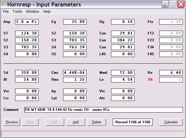

Greets!
Here's one you can fiddle with in the TH Wizard. As is, once damped it should be flat enough, though it may need a high pass (HP) to protect it below 20 Hz for movies, some pipe organ symphonies.

I managed to input the values and get into the tapped horn wizard.
But I'm not sure what I'm trying to do there. Flatten out the response between 20-100Hz?! It seems your values are very good already.
I'll have to make a filter... the displacement below 20Hz is too high.

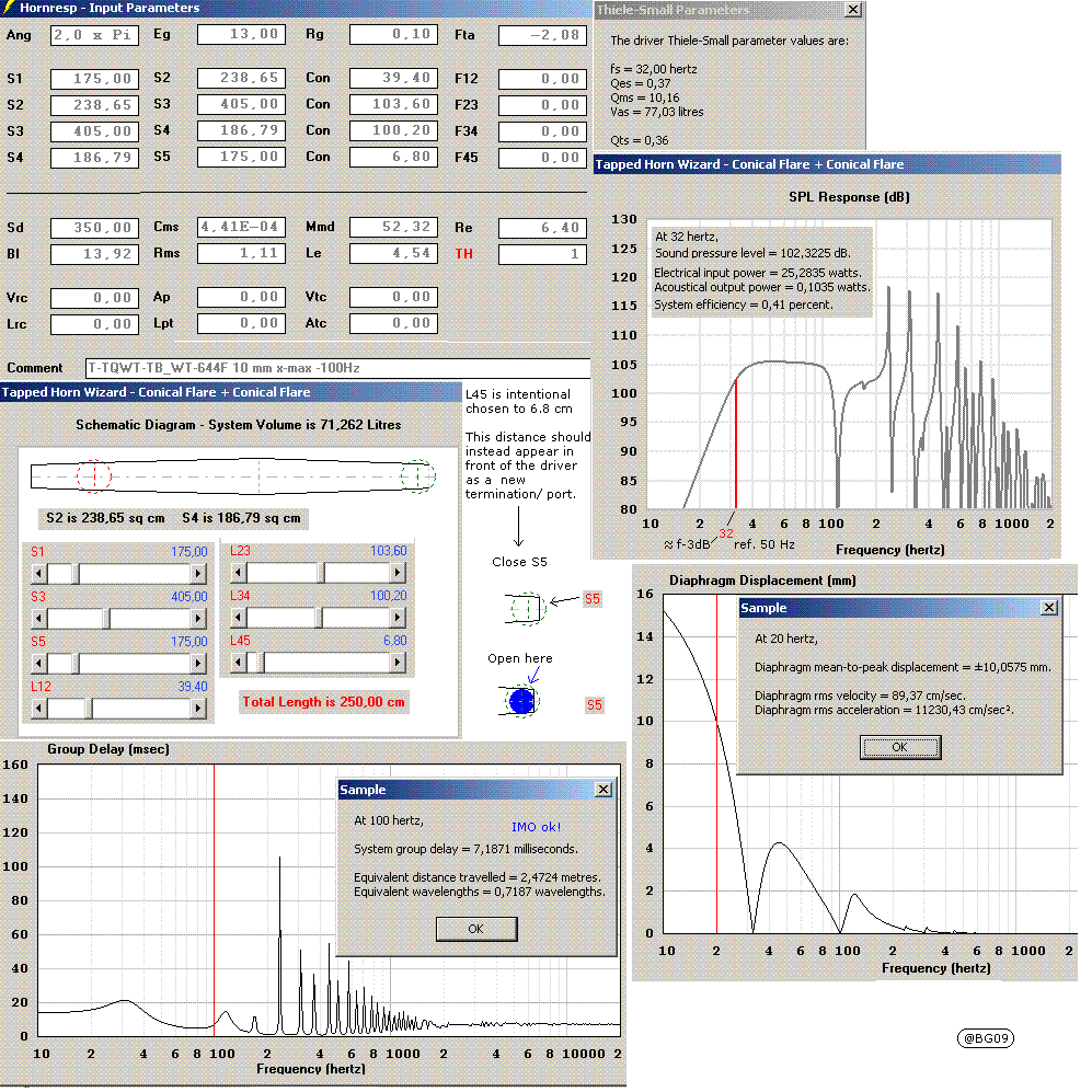

I tested the Tangband driver in HR input screen and found the T/S data not consistent, so I changed Mmd to a much lower value than GM is using in his TH suggestion and simulated a T-TQWT, shown in picture 1(1).
The T-TQWT have IMO blameless group delay at 100 Hz ( No need for signal delay the Main Speakers) and a FR curve that doesn't need to be equalized either.

you obviously know what you're talking about, but I'm still new to this.
What is T-TQWT ? I only know what a TQWt is.
Unfortunately I'm still trying to understand what happens in the wizard. The taper is visible in the schematic. It also seems you already optimized the values. The T/S parameters are derived from the actual physical parameters of the driver, which is why you found inconsistencies between the moving mass and the Qms or something?
Wether the horn(?) will be folded or not, is not determined by the wizard, only the length and cross sections, the rest is up to me?
I understand the group delay part no problem, though.
thanks for your time 🙂

..What is T-TQWT ? I only know what a TQWt is.Unfortunately I'm still trying to understand what happens in the wizard. The taper is visible in the schematic. It also seems you already optimized the values. The T/S parameters are derived from the actual physical parameters of the driver, which is why you found inconsistencies between the moving mass and the Qms or something?Wether the horn(?) will be folded or not, is not determined by the wizard, only the length and cross sections, the rest is up to me?..
Hi Lifthanger,
A T-TQWT is short for Tapped-Tapered Quarter Wave Tube.
Your right, the taper is shown but also that if TH is invoked at the main input screen, you must fold at least once and this may shorten the speaker from L to L/2 as the driver front and rear sides are shown in the schematic.
If you bring up the TH Wizard and choose the 'Driver ' button you can consistency check your driver data by solving for fs,Qes,Qms,Qts and Vas.
At the main input screen you should always double click the driver parameters = BL,Cms, Rms and Mmd and enter the appropriate numbers while finally clicking Sd will return the usual T/S parameters = fs,Qes,Qms,Qts and Vas.
PS. Your Thiele calculator seems to use he most preferable method to determine the TS parameters.
That is by adding a known weight(extra mass = coins) attached to the driver cone in free air and measuring the new driver fs that will be of a lower frequency = fs' or in yours = fsa.
