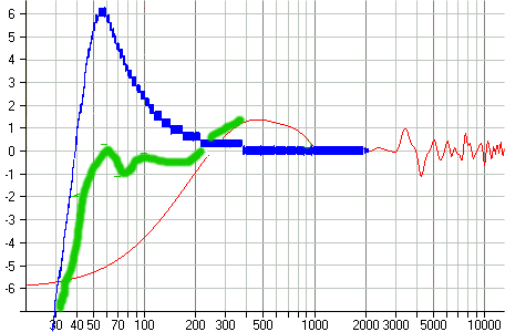

OK, I was tossing up whether to go with a box much smaller than Vas and deal with the consequences, or make one closer to Vas. I began to sim the baffle step and luck kicked in. I chose a box as large as Vas and used the two largest dimensions for the front.
The red curve is from 'The Edge' baffle sim, the blue is the box response (it is plotted where it is for better visibility), and the green is the resultant. 😎

On the other hand, if I make the baffle any smaller I'll just create a dip in the response, larger, a peak. I do still have the option of the aperiodic enclosure. I suspect that the overshoot may slightly compensate the apparent levels for adding a variovent after the fact. At least I hope so. Am I being reasonable?

Best solution if going for an active solution, would be a Linkwitz Transform circuit. It's well documented as a working solution to Q and Fs problems besides.
