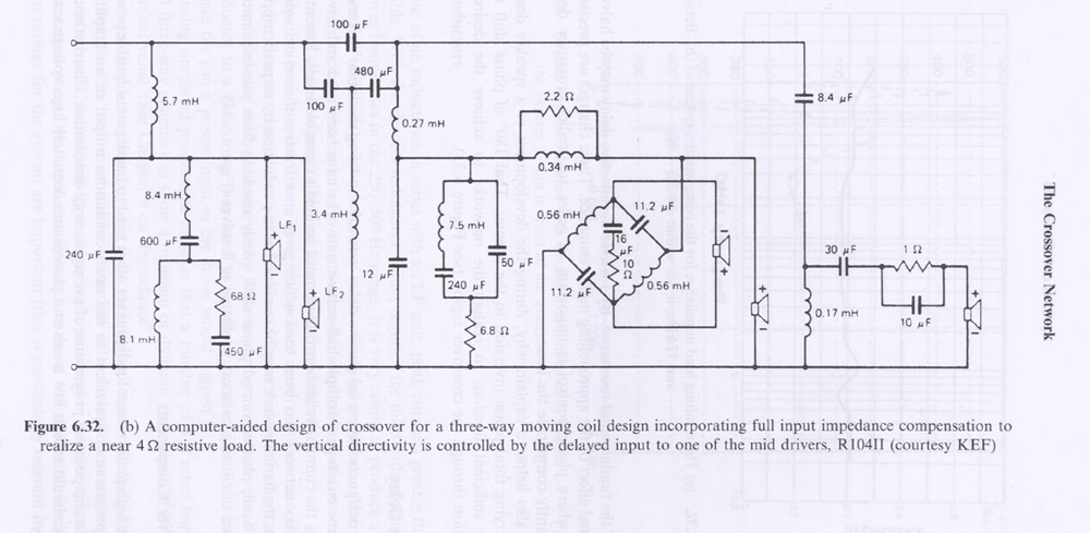

Here is a crossover circuit from the 104/2 that might be of some use to you if you decide to use your B110's in a MTM configuration:
http://www.diyaudio.com/forums/atta...-reference-104-2-circuit-diagram-kef104-2.jpg
