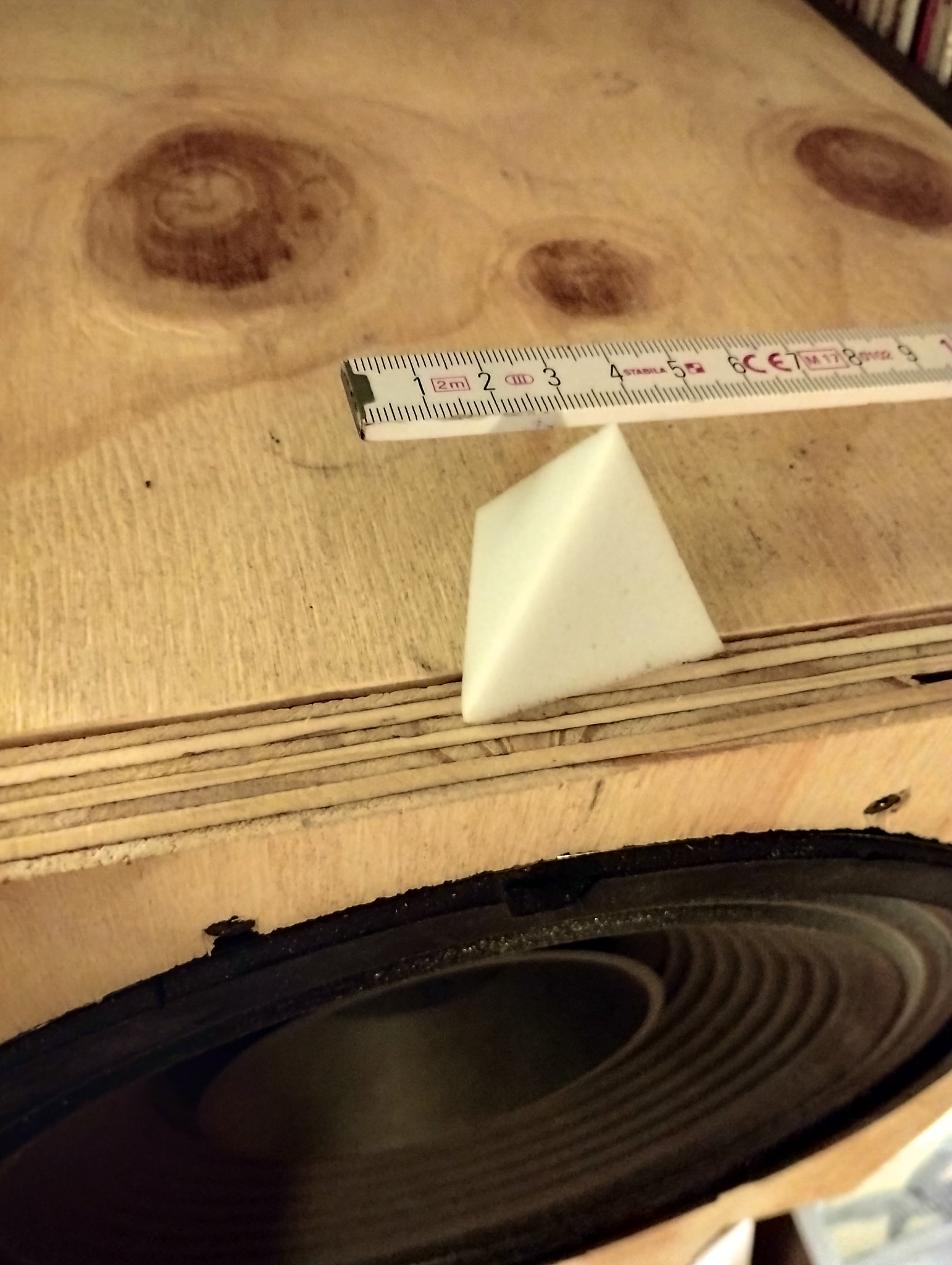

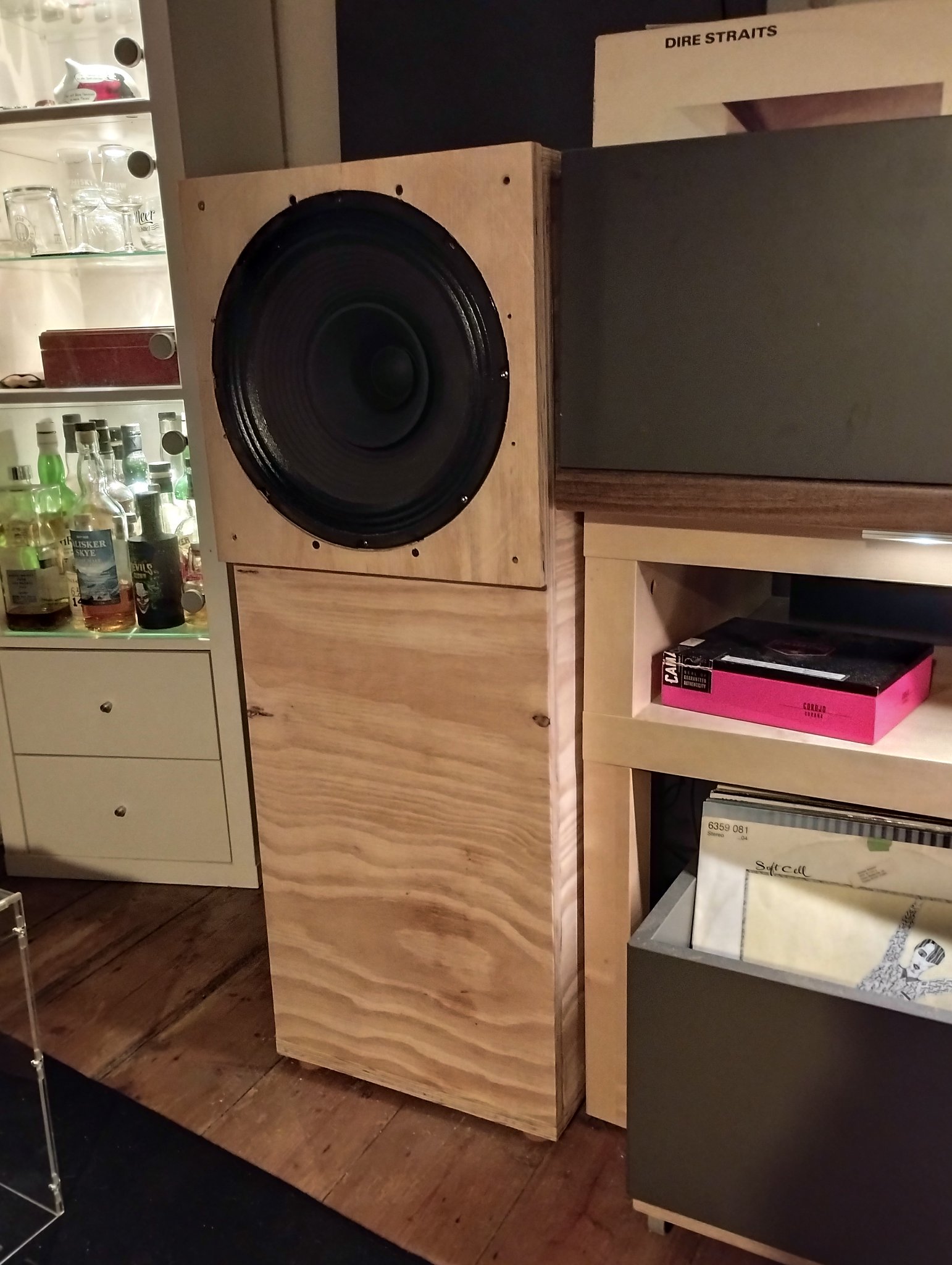

In my vented housing for the Fane 12-250TC you find Basotect...
Reactions: LeifB60 and GM
