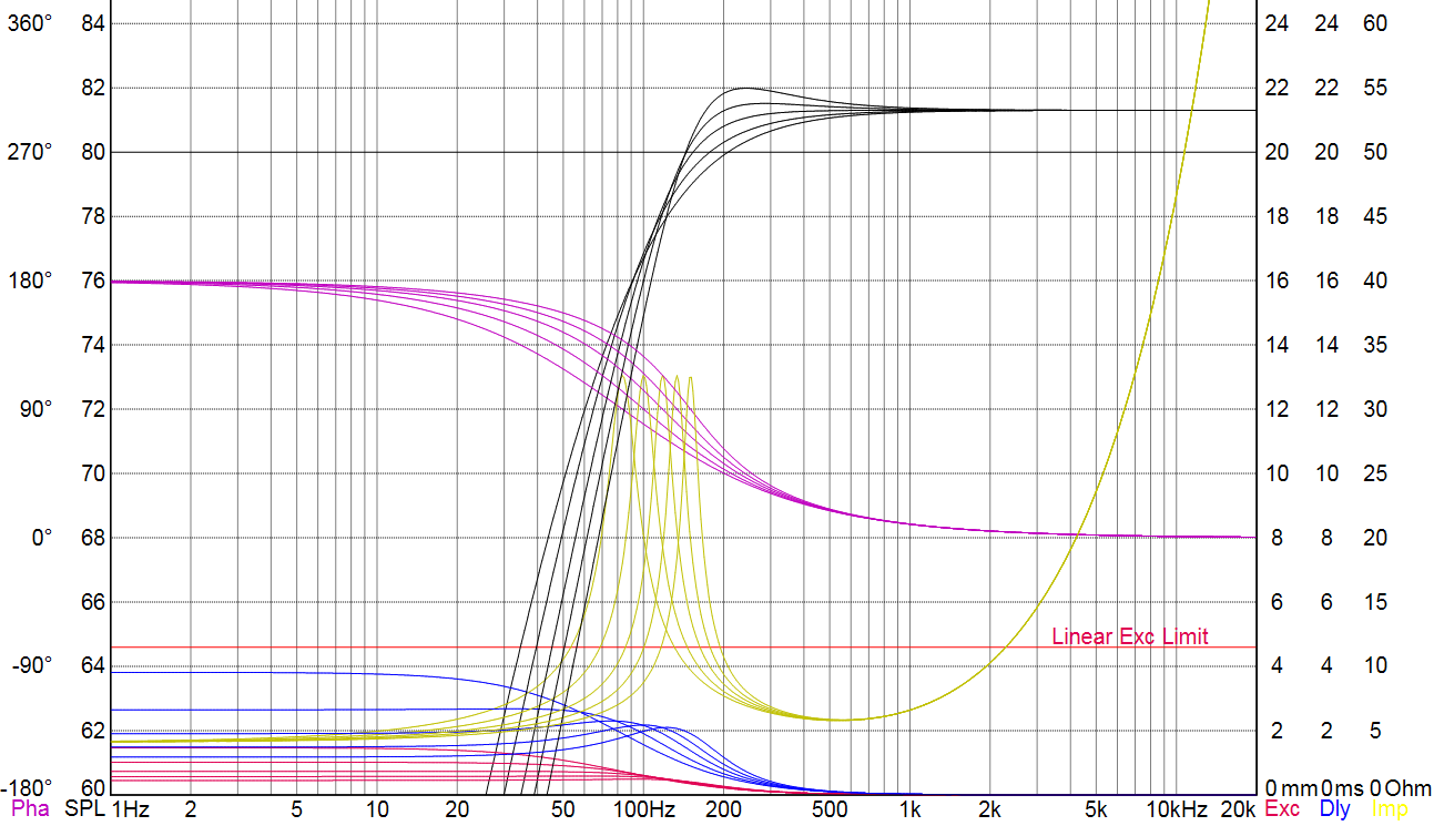

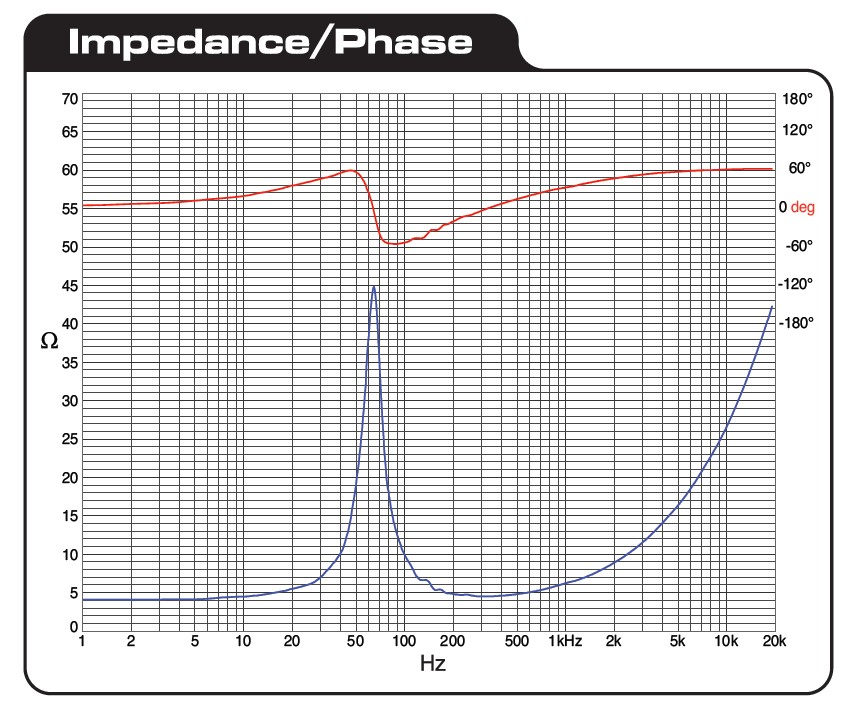

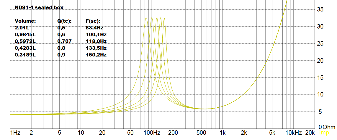

Her some physics that happen. Where system do resonance the impedance increase, and different box size move the frequency where system resonance, as you mention the smaller the box the higher the frequency. Higher impedance less current from amp needed but more voltage swing. Power needed is frequency dependent example 20Hz takes 20W then one octave up 40Hz takes half 10W, 80Hz 5W and so on. Looking at picture 2 you see the biggest box put the bass area 20-200Hz where most power needed to have higher impedance, and therefor less current from amp. The smaller the box the more back waves into the cone that disturb and stresses it and decrease the perceived quality from front of it. Damping material inside box in reality makes box virtual bigger regarding the resonance frequency, therefore try the small one box out heavy stuffed with dampening and see if this works and at same check if sound quality is preserved.
Picture 1 Dayton Audio datasheet resonance free air.
Picture 2 five different sealed box sizes simulated in Winspearkz program.
Picture 3 same as second and added specs, 1 watt input to driver.

Clearly there are some things about this topic that I do not understand. The TPA3116D2 data sheet states that the overcurrent protection system trip point is 7.5A. According to BRYTT's chart #2, the minimum impedance for the speaker and enclosure, regardless of frequency, is 4 ohms, which makes sense. Therefore, at 24 volts, the maximum current I should see into a 4 ohm load is 6A, which should not trip the circuit, yet it does. Can any of you explain that?
