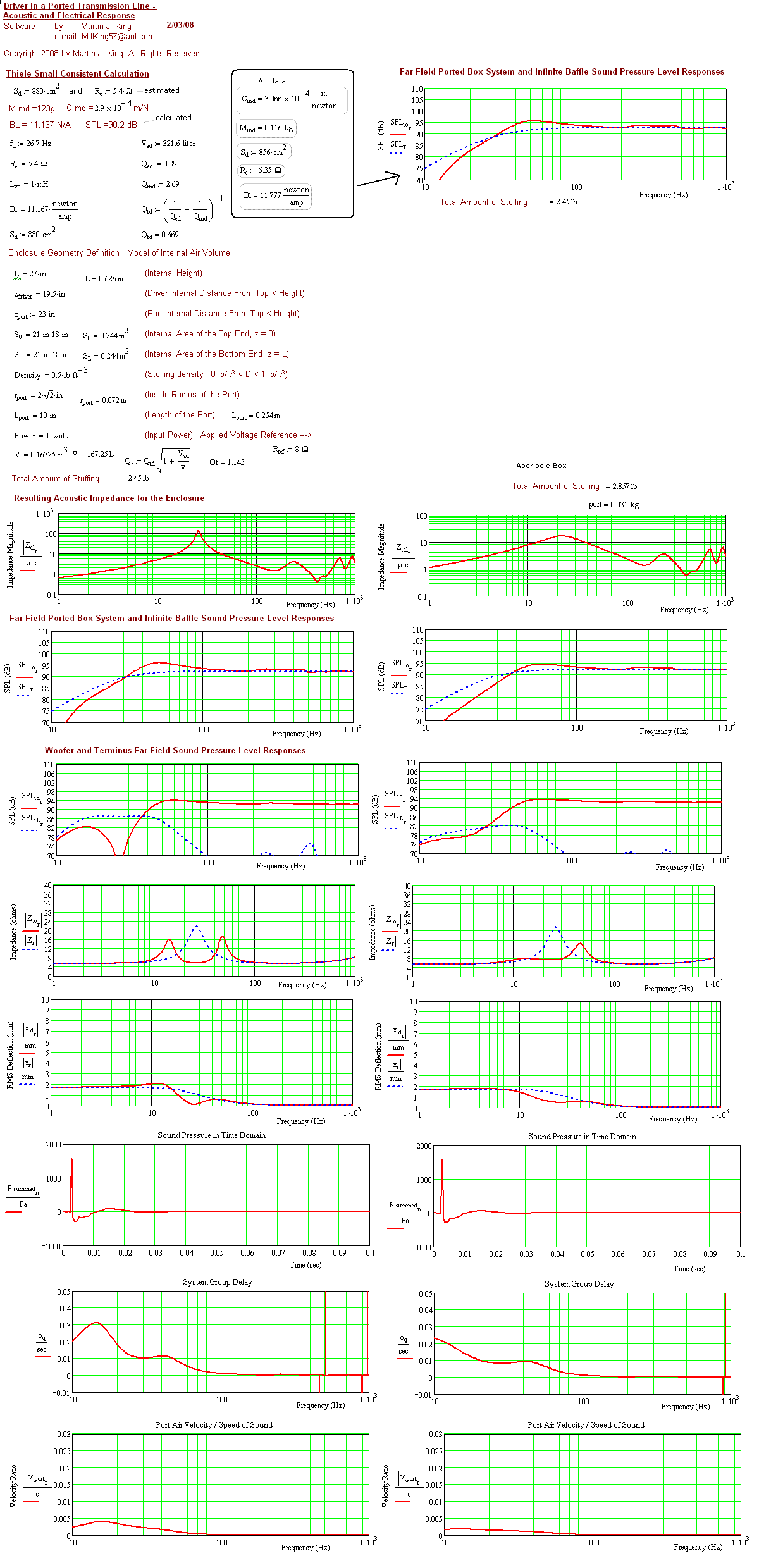

Hi guys. I'm just bought some Pyle replacement speakers that im going to put in an old set of Peavey SP-1's. I gutted the enclosure and what I have now is a 28.5 inch height and a 22.5 inch width. The depth can be whatever I want up to 19.5 Inches. The speakers require 11.36 cubic feet of space. What I would like to know is what kind of depyh I should build into it and what size and lenght of ports I should use to optimize the performance. Here are the speaker specs.
* 250 Watts RMS/800 Watt Peak* Sensitivity (1W @ 1M): 90.2 dB* Frequency Response: 30-3 KHz* 70 oz Magnet* 2.5'' Kapton Voice Coil* Stamped Steel Basket* Strong Black Paper Cone* Cloth Edge Suspension* Bumped & Vented Pole Piece* 8 Ohms ImpedanceI tried a couple calculator downloads off the net but did'nt really get anywhere with port size.Any help would be greatly appreciatedThanksAyotte

FYI,
Data can be found in my picture but might be conflicting if a real measurement is performed:
