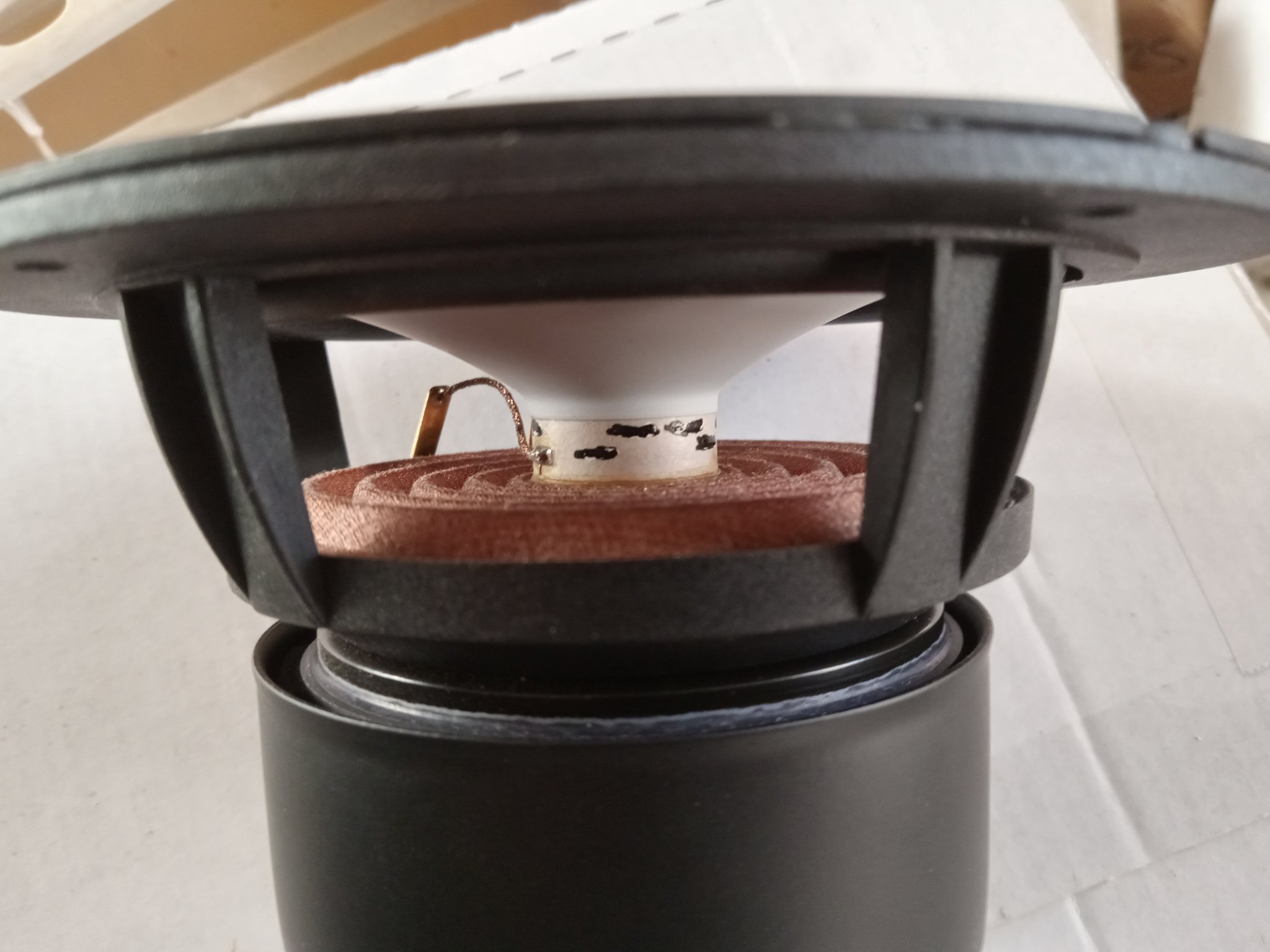

We discussed previously whether or not EnABL would improve a MAOP driver, and I volunteered my MAOP-7 to try it. Sorry, couldn't do it earlier. Preparations for winter occupied most of my time - I live in a countryside.
First, I tried to do tap test to determine optimal positions of the patterns. It didn't work - at any distance on the cone radius tap sound was the same. Tapping worked on a 4" Sony speaker with a paper cone, I could find positions where tap produced the loudest sound. I guess the MAOP cone is pretty well-damped as-is. Without tap test guidance, I decided to apply patterns 1) close to surround; 2) on former close to cone boundary, and 3) on top of the dome. See pictures for details.
The patterns were applied free-hand using extra fine Utilto acrylic paint markers, black and white. Surround pattern was applied to back side of the cone to conceal my ugly handiwork. To build up thickness (pens lay paint pretty thin), three layers were applied: black-white-black. On the cap, a single layer of white.

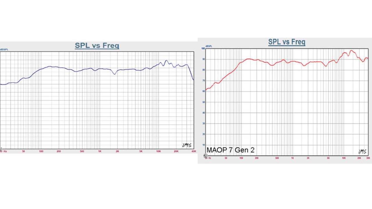

Sigh. When is anyone going to provide data on EnABL? Bottom line is I'm not going to try that on any of my loudspeakers, even the cheep ones, just because someone on the internets says a piano prelude sounds buzzy like a piano should. Op, you had the perfect opportunity to show that EnABLE does anything at all. I'm glad you have $374 to try this out at home on your own speakers but you missed an opportunity that few of us can afford, and now all we have is another opinion that testing is unnecessary?

Any good recording will do fine. Record the response before EnABLE and record the response after. Then compare the responses to each other and to the source file. I'm mostly interested in frequency and phase but other tests will be fine. Square waves would be interesting. The testing may require multiple playback and recording sets to get an average of the EnABLE effect. Those that say it's too subtle to be measured are just dancing around the truth. The ability to measure things to the billionths is widely available these days. It should be repeatable. One thing that annoys me is testing labs that take one measurement of the frequency response and say, That's it!. No that's not it, do it again, repeat, ... If you are hearing a 'micro detail' it should be able to be measured. Recording, playback, and measuring equipment is far more accurate and precise than the human ear and the animal brain. (This brings up a topic all it's own, since we live in a digital world with digitally augmented speakers, maybe we need better testing to see how the sound is affected? I'm astounded by people who put lots of digital sound 'effects' in the signal chain and think it's great.)

Case to the point: Pluvia Seven and MAOP-7 are the same driver with the exception of cone treatment. They have similar frequency response. The sound is different though, as recognized by those who don't regret paying 4x the price for the MAOP.
