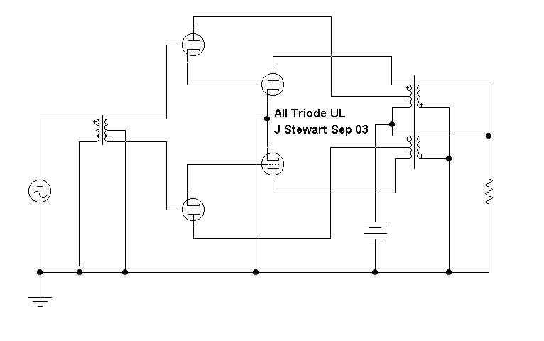

"All Triode UL"
Very interesting! If one were to use approx. 2X higher Mu triodes for the UL feedback paths, one could just use the plate taps instead of the UL taps. Solving the original poster's requirements for a no UL tap OT. (some grid biasing and cathode loads needed at the input for conventional neg. grid tubes)
Or you could simply plug PP 6N6G/25N6G into the cct! All selfy biased. But a number of common combos would work. Limited only by one's imagination.🙂

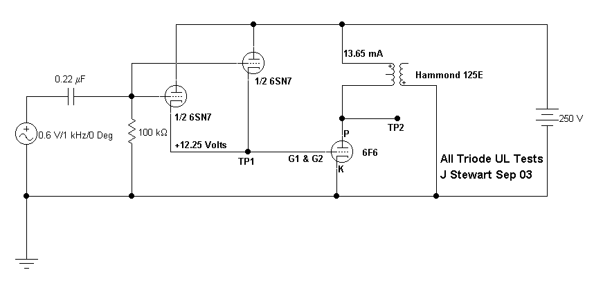

Real Live Test Results
🙂For the curious & others here are the measurement results I got on a SE example of that 'all triode UL' thing. Looks like already 12 years since I messed with this thing!
John L Stewart
