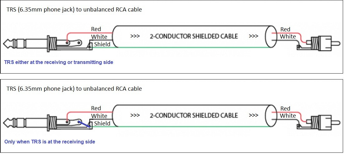

Don't use the Cannon connection, it is low Rin.Can anyone help on how to properly record a song through the microphone input of the emu0404 with a RCA wire loop.
Use the TRS instead which is high Rin.

I don't have a trs to cannon adaptor now, I don't understand the low resistance or high resistance, I can place headphones in the circuit which will attenuated a little the signal but the DC... lol. 48v into my headphones wasn't good nor it is in the adc inputs

Ahhhh ok I see!!! sorry for my ignorance this will greatly help I have I think all the adaptors for this
