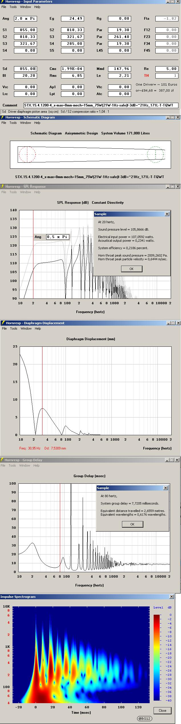

Hi, Single fold this easy to build T-TQWT suggestion using a STX-15-4-1200-8 driver for ~101 € and you will IMO be surprised of the SQ. Build two and still be below budget.
