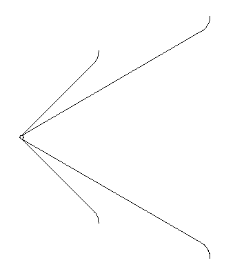

It also depends on what the waveguide is doing. Is it suitable for a 12" woofer?
Here I've drawn a 90 degree waveguide and to the right of it is a 60 degree waveguide that holds to the same frequency. The point is that it will take some measurements to know the answer to your questions.

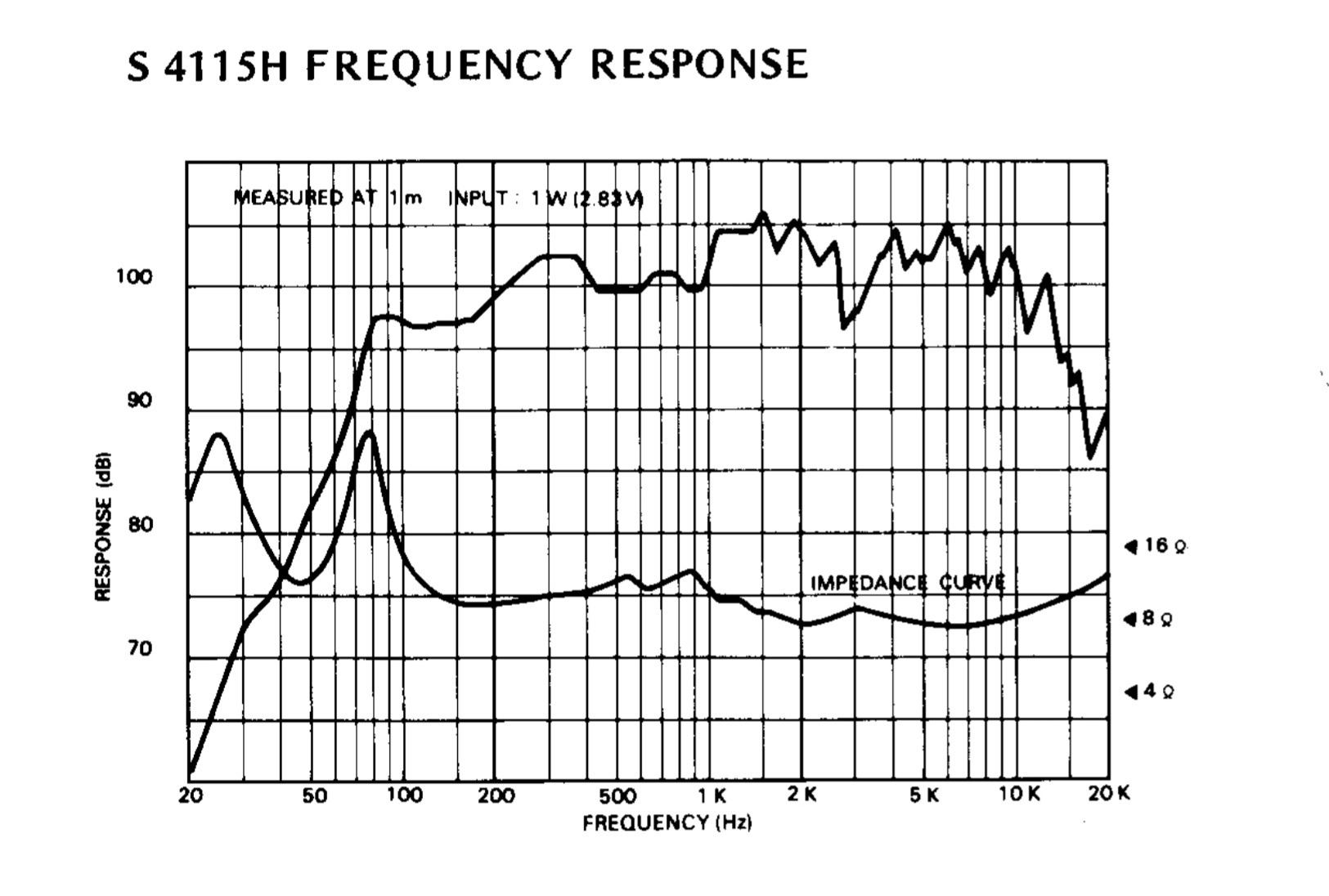

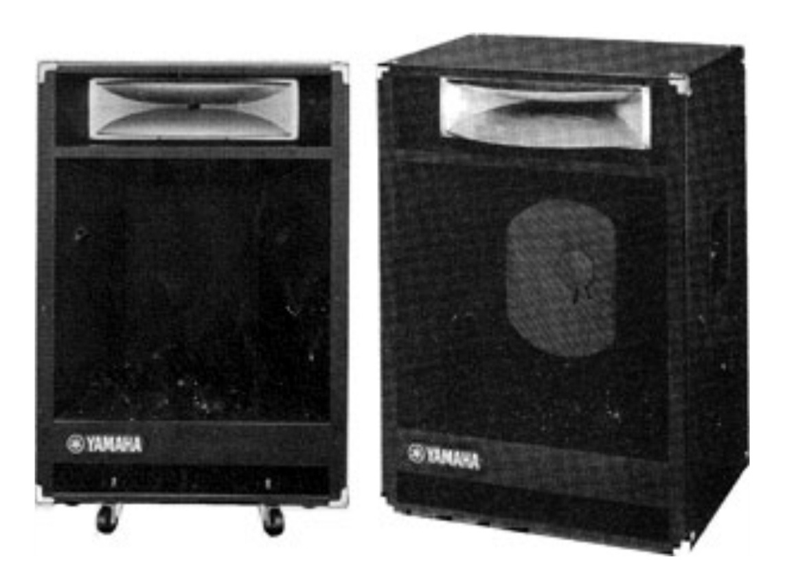

There were some older yamahas that I remember having this style of cab with the shallow LF horn loading - model S4115H. That WG was probably not very effective under 200 Hz judging by the graph provided by Yamaha. These were very popular in the early 80s with DJs... ask me how I know. Lol

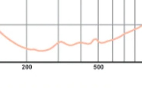

I also realized something interesting about the KL3012HO impedance response - that wiggle in the lower midrange is caused by basket resonances and goes away when the driver is clamped into the enclosure by its mounting points. I assume Eminence doesn't mount their drivers when measuring impedance. The KL3015 shows this behavior as well, so its likely a result of the driver frame resonating.
