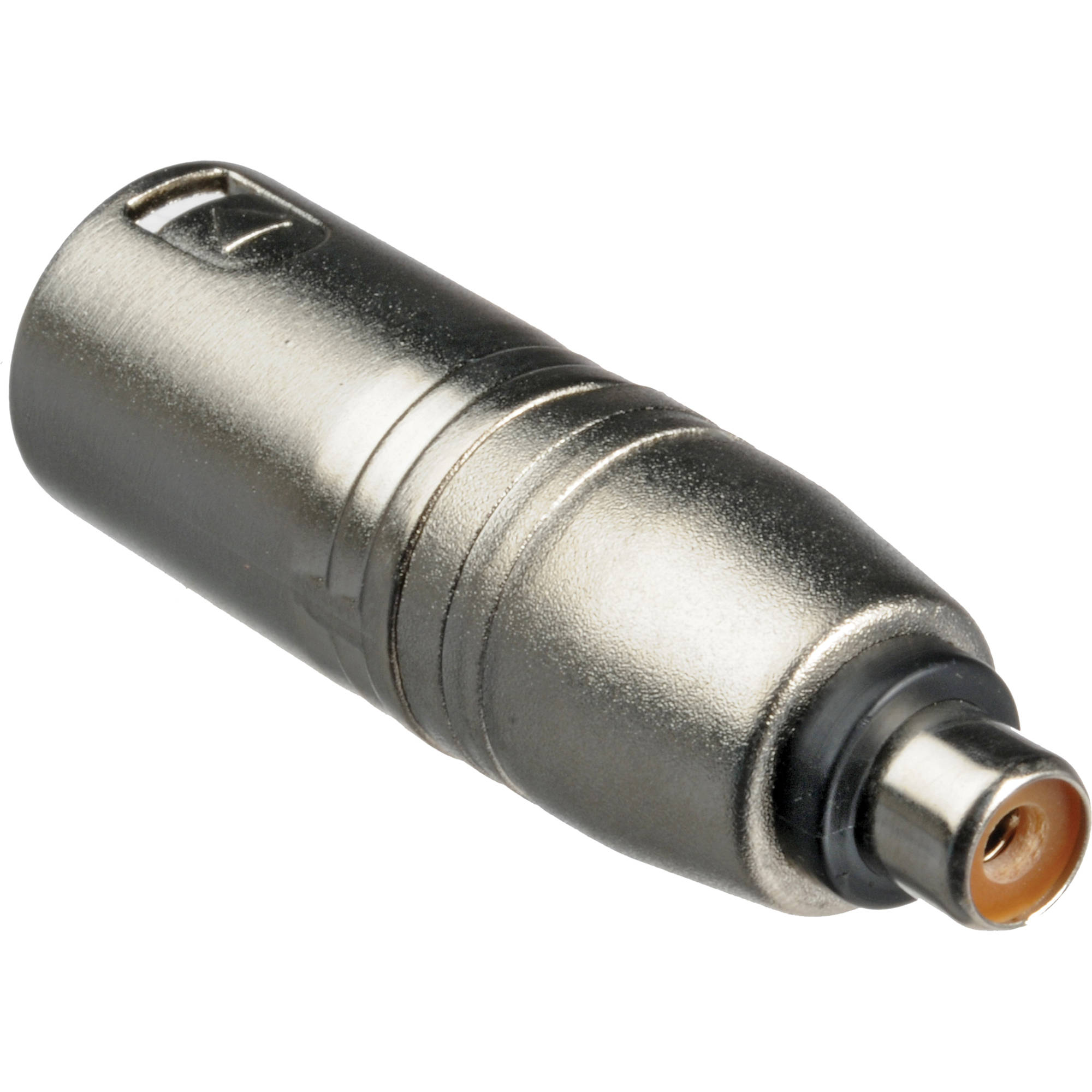

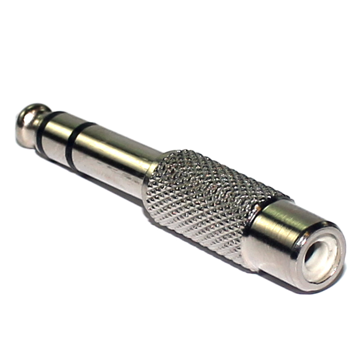

I don't think there's reason to follow LordSansui's links when using just home cable lengths.
True, in this case he could buy just an adapter.
RCA to XLR
or
RCA to P10
RCA to XLR
or
RCA to P10
Simple, effective and low cost ....🙂😉
