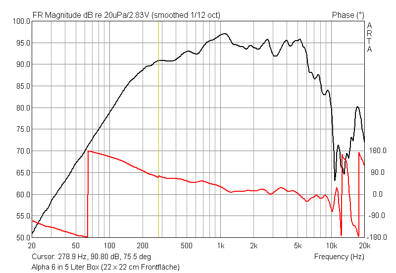

The only independent measurement I know:
Source: Biete ein Paar Eminence Alpha-6A Mitteltöner - verkauft!, Selbstbau / DIY - HIFI-FORUM
Hello,
Another independent measurement is available here

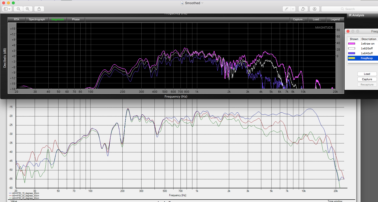

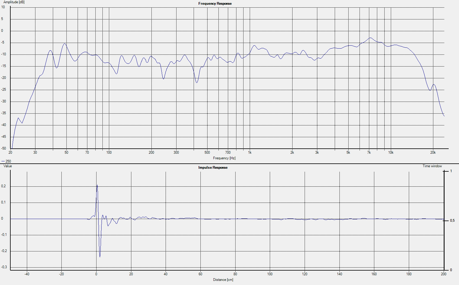

Here is my Alpha 6 in a three-way system, crossed over actively at ~250Hz, 4. order L-R. No low pass, tweeter (Celestion HF50) is passively crossed at ~5,5kHz 2. order. Measured in room ~1m distance 1/8 (or 1/12, can't remember that detail) octave smoothing (peak at ~7kHz is a microphone artifact):
As for sound, it's very lively yet not aggressive. Not the smoothest FR but detail and imaging is rather good.
Great. Any problems with off-axis? Roll-off is so smooth and no peaks at all? I want a minimal crossover and because of that was interested in Alpha 6A.
I can do single driver and off-axis measurements tomorrow. I did some off-axis measurements some years ago (I've had these drivers since 2008 and never felt a strong urge to replace them with something else), but they're with outdated passive crossover. I can check and see if I still have them later. IIRC, no problems off-axis at all. Roll-off is basically textbook 2. order; some break-up above 10 kHz, but it's 20 dB down.

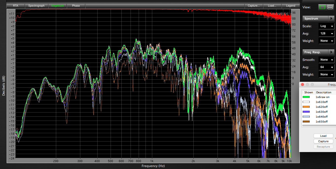

Here come a metric ton of measurements both with and without tweeter. Baffle size 215x335 mm, around 7 litres vented (Fb ~95 Hz) and overstuffed (so more like leaky sealed box than real vented box), no HP filter, no bass modules. In-room; 50 cm distance for Alpha only and 80 cm for full mid-high module; 1/16 octave smoothing. The drivers are modded with felt pads on basket, as per Garys experiments 🙂 No mods to the cone.
More here, including HOLMimpulse save file: https://www.dropbox.com/sh/e6vprocinlf5x7q/AABESIGN_tC17fO_EPIqpmp9a?dl=0
I guess 5 kHz 1st order would be a good starting point. That'll give you 3rd order acoustical. Or 2,5 kHz 2nd order if you want to use a wide dispersion tweeter (dome, ribbon or slot). No LP can work well, too, as in my case - it's almost perfect 2nd order acoustical roll-off. A slight widening of dispersion from 5 to 6 kHz isn't much of a problem (I guess this is where the dust cap makes sound).

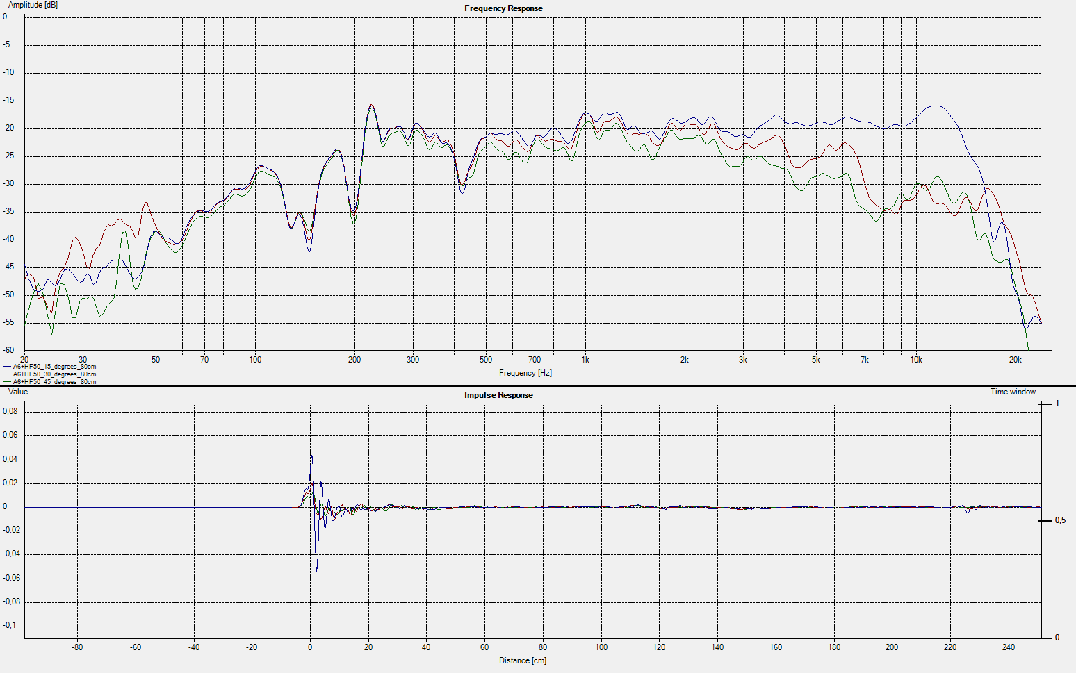

Something looks off with these measurements, too much hash for properly gated outdoor measurement and that depression in the 1 to 4 kHz region doesn't look right at all. My Alpha 6 measure much smoother, even in-room. The below measurement is with tweeter crossed at ~5 kHz.
Neither of our measured responses look very similar to the curve on the Eminence Alpha 6A spec sheet ;^).
Your drivers may be a completely different production run, are they "6" or "6A"?
Yours were measured with a tweeter (and presumably some crossover), really apples to oranges anyway.
As far as "hash", seems high resolution Smaart (1.5 Hz) measurements show a bit more, even when smoothed.

6A, I bought them in 2008, I think. I used these crossoverless, really more like wideband + supertweeter style than "normal" 2-way. I have to dig around in my old files, there should be some measurements without tweeter.
swann said:
why did you cross the alpha this high? Beam would already starting at 3-3,5 khz. What kind of tweeter do you use?
I used Celestion HF 50 which is a narrow dispersion bullet tweeter (around 60 degrees conical), so that this high crossover point worked quite well. These were my old speakers back from when I was a poor student, and I was coming from 8" full range drivers. I wanted similar sound to the fullrange drivers, but with smoother mids, deeper bass and cleaner highs - mid driver that could cover from 300 to 5000 Hz and minimalist crossovers were the design points.
I also attached a measurement from some German site which name I've long forgotten.
